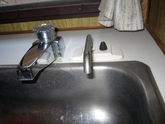

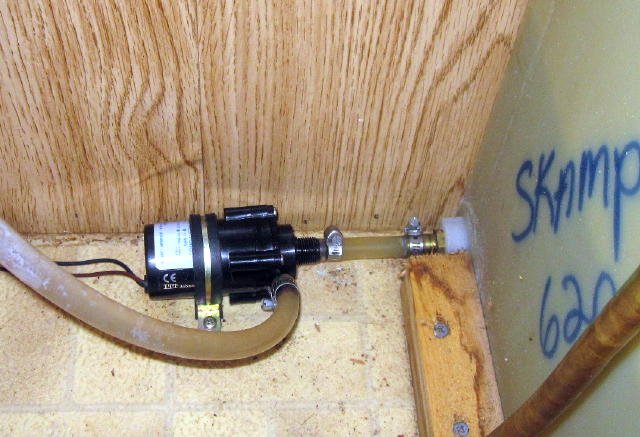

I have an electric faucet (& pump) in my old pop-up cabover P/U camper. I installed it after getting tired of using the hand pump faucet whenever I didn't have 'city' water available. Mine consists of a lightweight aluminum faucet in a plastic base that also has a waterproof 'push button' switch to start & stop water flow. The tiny 12vdc pump is mounted at floor level adjacent to the fresh water tank. It will pump water at approx 0.5 gpm about 8' distance, & raise it about 3'. Not a lot of volume but it is sufficient for what I need. Adjacent to the electric faucet I still have the 'combo' manual pump & city water faucet for when such is available. I've bought a near identical electric faucet & pump for my Scamp trailer if I ever get it 're-habbed' the way I want. When using the TD we still rely on the old 7gal 'blue jug' ;)
Here's pic of the electrical faucet with the manual pump/city water faucet on left -
This is the little 12v gravity fed pump mounted at floor level next to the water tank -
