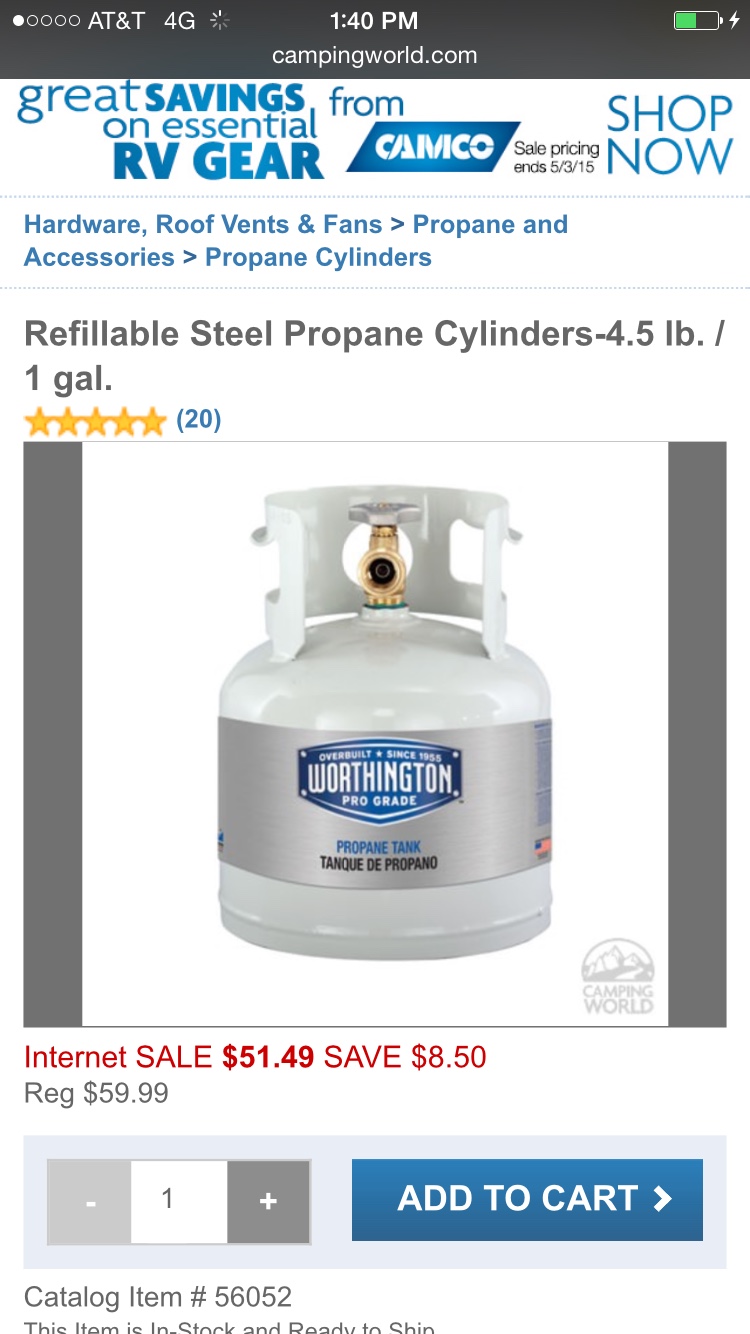

Trying to decide what propane tank to go with. I seen a 1 gallon tank and was wandering if anyone knew about how long that would last with a 6 gallon water heater? I will only be running the water heater off of it. I plan on using the trailer 2-4 days at a time. I also like the size that way I can install it in a tongue box up front with my battery. Here is a pic of the bottle. Thanks

Before taking the plunge ask a propane dealer or two how much the charge to fill it will be. There are two dealers near me who have a 3.5 gallon minimum charge.

Ok I'll look into that. I also found a 2.5 gallon tank so I may do that.

To your question one gallon of propane has the potential of 91,600 btu's Looks like most of the 6 and 10 gallon heaters need 12,000 btu's/hr so you are looking at 7.6 hours of run time. As it runs in cycles it is hard to say just how long it will maintain hot water. I am sure ambient temp and gallons used will be a large factor in actual run time. I didn't look but a tank less type heater may use less per hour.

I have that 1 gallon tank. Its supposed to hold the same as 5 of the 1 lb cans. I find I have to refill it after 5 or 6 days of camping. I use it for my camp chef oven and lantern. I think its probably a bit small for the water heater.
