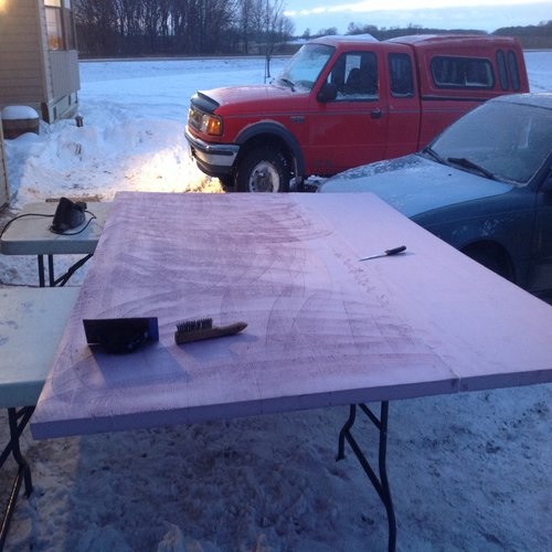

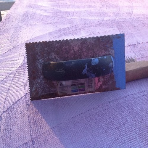

Here is a picture of my fish house in the making you will notice that I scratched the surface , I found in my testing that greatly improves the holding power oh the TB2

Better :pictures: of fish house wall with wire brush and grout trowel
