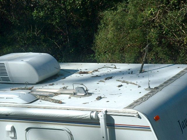

GPW wrote:Er, actually the foam does have some strength ,a good bit , we've used it for many years to great acclaim ... and while we're not on a quest for the ultimate TD here, building to the parameters stated produces a camp able structure that is affordable and can be built by most anyone... with little to Rot...
Better than a tent , not as strong as a Tank...
Someone please remind me to bring a hammer to a TD gathering , so I can test the strength of others trailer materials... May not be popular , but we'd gain some empirical evidence...![]()
And although there's much speculation by some as to "what if", the same may be said for most any of the other TD construction methods ...
