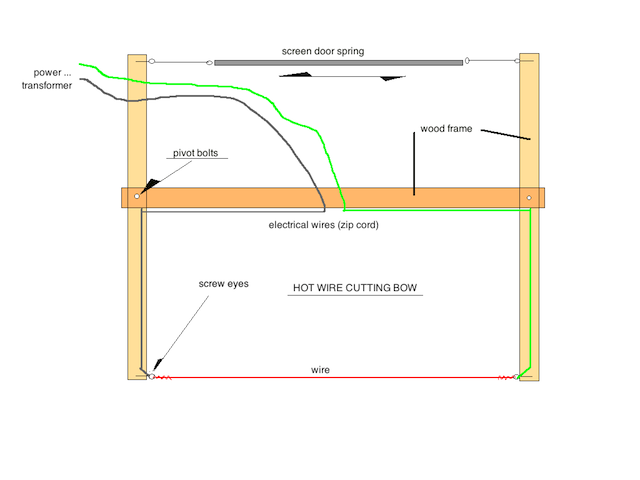

Here’s the kind we always make ... been using these for 40 plus years now to cut foam for wings etc. ... Make it to the size you need ... Image

atahoekid you reminded me we did use a Weller soldering gun with a copper wire
we used it to "scoop" out the seat foam and on the end of the wing for the running light pad.
GPW yep same deal only larger is right your drawing of the foam cutter looks like what we built it too was powered by a train transformer.
once the cutter was built a jig could be figured out to cut foam
two V shaped patterns mounted on a table so the cutter's legs would hit the table at the bottom of the cut.
go down one side of V with the wire come up and out the other side, slide foam repeat cuts nice and clean.
maybe a better way of explaining is hold your fingers in the "peace sign" slide one finger on the other hand down one side of the V up the other.

Postby atahoekid » Thu Jan 12, 2012 1:30 pm
Ahaa! Now it makes sense. Once I saw GPW's sketch it all made sense. Don't think I have an old transformer around. Time to go to Craig's List. I may even try the old solder gun thing.

GPW wrote:Here’s the kind we always make ... been using these for 40 plus years now to cut foam for wings etc. ... Make it to the size you need ... Image
Since I don't own a transformer, I'm wondering if my laptop power adapter (19.5 volts @ 3.34 amps - using a dimmer to control temperature) would be a possible substitute. I hate going out and spending money if I can adapt something to be multi-use. Gonna try an internet search.
