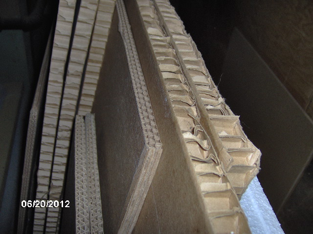

Check out this cardboard packing material I got from trash at my work.
(Don't be confused by the triple layer corrugated stuff in the same stash.)
It's very much like the honeycomb materials used in some epoxy/fiberglass construction.

Wow, that honeycomb stuff looks really cool! I'll have to see if I can source some of that for some tests. :applause:

I'm pretty set on the cardboard/fiberglass combo. It should have a great mix of lightness and strength. I called the local Costco, and they said they always have a large supply of the cardboard 'slip cards' that go between packages on pallets, and that I can pick as many up as I want if I swing by. I'm going to use those for a mock up. I'm likely going to order pristine new cardboard when I do the actual build.
I am very interested in the honeycomb cardboard. It's called Hexicomb, and I've found one place where I can get 4x8 sheets for $18.
http://www.ashleydistributors.com/corrugated.php
Not exactly free, but it should be insanely strong for the weight. The only problem I've found is that the only place I've found to buy it is in California, and they can't ship it due to size... :cry: They did say that they have a LOT of calls from my area from people trying to get it, so I'm considering the feasibility of having a larger quantity truck shipped up here to the Seattle area, then reselling to make my money back. I'm not sure how I'd actually find the people who have been looking for the material though...

I just got off the phone with the Hexicomb distributor. They can ship the boards cut in half 4'x4'. Since the board just provides crush strength and most of the rest of the stress is taken by the skin, I don't think having a few joints will affect the overall structure much. That's a pretty good size anyway, so there will only be a couple places where a single board won't be enough.
