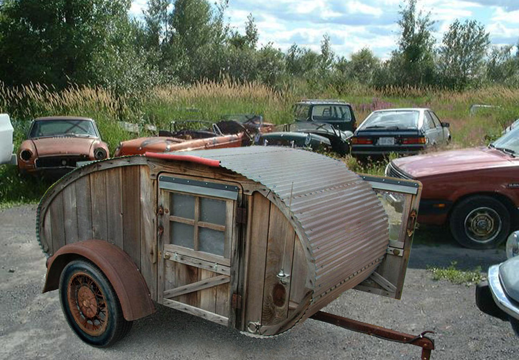

What about putting Metal on top of the foam ... Especially for places like the roof .... It would seem that the metal would expand and contract and the foam would follow it , Unlike metal over plywood (which also Rots :frightened: ) Good place to consider first is the “rock guard” area ...
Naturally we would need “hard points” for attachment ... :thinking:
After Isaac , and the roof repairs , we’re left with a few hundred feet of nice R panel .... seeing the photo below was a “salvage” inspiration :thinking: :NC :beer:

In that photo I believe the r-panel is a decorative finish. The real roof is underneath.
The biggest problem with the r-panel other than weight is how do you seal the edges along the corrugations?

Since totalling out my PT Cruiser and buying the big gashog, I've been puting some thought in the rippled steel for a roof. Weight is no longer an issue. I think expanding foam for adhesion and filling the gaps, plus bolts going through into the roof "truss", add some silicon to all of the edges and joints, I think it would work out.
The picture of the old rusty TD is partly what got me started on this sight and my build. I LOVE that trailer!
Frank

So you're thinking about a larger version of this?
Re: Metal over Foam ....
Postby GPW » Thu Dec 06, 2012 7:40 am
It does have a certain RUSTic charm eh ??? :lol: Looks like some new rims too ... The old wire wheels were Nice ...
