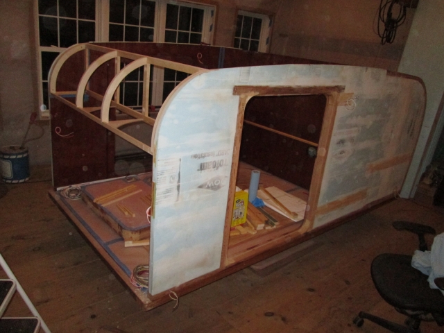

Postby KCStudly » Tue Jan 14, 2014 4:43 pm
Yup, thin ply interior on 1-1/2 thk blue foam. My rear cabinets went in just the other day.
Here's a shot of the front cabinet "riblets" being fit.
My thinking about axle placement is that the materials of construction are all about equal to themselves where ever they are in the build, so it is the stowed items that determine the trailer balance. In other words, traditional construction may weigh 'X' lbs per foot of cabin length while foamie construction weighs 'Y' lbs, but the ratio of overall weight to tongue weight still needs to be the same, so the axle should go in the same spot as any other TD. What makes a much bigger difference is your cargo. Are you going to put the fully loaded cooler in the galley or on the tongue? Same question for the 12v battery. Same for the spare tire. Tongue box on front? How much CI cookware do you plan to bring? Camp chairs in the cabin, underneath, in the galley? These things will affect your balance more than the basic structure.
Because of the extra wood in my bulkhead and hard wall edges around the galley, TPCE is already a little tail heavy.
Yeah, maybe you can get away without moving the axle, so long as your doors clear the fenders and you can get into and out of bed without too much crawling around or hitting your head.
I am also building 64 inches wide outside for a true 60+ inches inside. If there ever is a next time, I will not bother; 60 inches outside would be plenty (I'm 6 ft, 260 lbs, tho the wife is "small"). It makes a lot less efficient use of the materials, the extra space inside is not really needed (TPCE seems huge inside... at least for now) and, since there is no chance of rolling out of bed, you can use more of the mattress than in your regular bed. Cutting down a foam mattress is not difficult at all, or you can order from a foam supplier exactly the size you need (just remember to leave an inch or two "for tucking").
Yes a foamie can be made very light weight, as can other types of builds. They can also be just as heavy as any other build. It's all in what you put into it and what you don't. If you want a 5x8 with wood interior, wood cabinets, lots of anchor points with blocking at each location, the weight is going to add up. Cooler, spare, battery, stack of CI cookware, that nice cast iron wood grate that your wife got you for xmas? Those things add up quickly. I have planned all along for my finished weight to be somewhere between 1200 and 1500 lbs (64 x 9ft 8 inches at the floor), tho I will be pleasantly surprised if it comes out much lighter (1500 all up loaded down). Really it's just a guess.
Sure, super simple like GPW's bug out camo foamie ("the grandfather of the modern foamie movement", as I like to say), a 4x8 with no galley or hatch, simple plywood floor, one door, no electrical, no water, maybe a six pack cooler and a box of chips; easily well under 800 lbs. (not sure if he ever weighed it :thinking: ).
Just remember, every piece you touch, every screw, every scrap of wood, even the foam and canvas adds weight. If you want to keep the end result light, it needs to be part of your approach from the beginning. Even your profile choice will effect weight: a Benroy or Rimple will weigh more than a classic TD shape just because it has more square footage in the walls for a given length (but it will also have more interior space for cabinets and/or for roominess). So long as you don't build it very tall (a sleeper, not a standy), blow-overs should not be an issue in most weather.
The only 2x4 fir lumber in my build to date is: a few 2x4 chunks built into my floor where the anchor points are; the blocking around the side door latches that mostly got routed out for the latch; and the rear wall edges in the galley that were formed into 2x2 (1-1/2 x 1-1/2 actual) curved arches by laminating ripped down slats into ribs. The other 2x in the floor, wall sill and door jamb/header is lighter weight cedar. Wherever I could I used mostly 1x2 cedar instead of 2x. So if you need to build up your floor to clear the tires, I would go with 1x's on edge, and not too many of them. Remember, the strength is in the outer fibers and the further those outer fibers are apart, the stronger a structural member will be.
Hmm, :thinking: now you have me curious about how TPCE is doing on weight. I think I will bring the bathroom scale with me next time. :beer:
