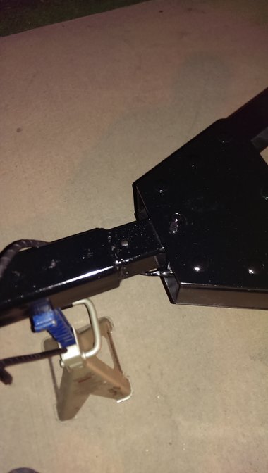

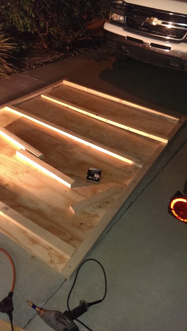

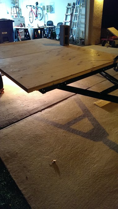

Our camper will be bare bones...just beds and some storage. I have estimated my cost to be between $1200 and $1500. I purchased a 5x8 northern tool heavy duty trailer, and I have assembled it, raised it 3 inches (for off-road clearance and to build over the wheels), and extended the toungue 24 inches. I built a frame for the floor with 2x3 pine, and attached 3/4 plywood for the floor. The floor dimensions are 75"x96" for an interior of 71x94 (2" foam side walls, 1" front, back, and roof). The front of the trailer will have a 24"x24" storage across the width, with the top extending to 32" to be a bunk for the kiddo. The bunk will have a custom foam mattress, and the main bed will be the tempurpedic full size matress from our extra bedroom (may as well camp in style, right?).

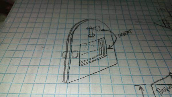

I have a couple questions to have the experts :beer: ponder...
The door will have plexiglass sandwiched between ply skins with either hardwood or foam channels to guide it. I plan to make weather stripping by covering the plexi, then temp-installing it into the door, then caulking (or some similar material) around the window opening (like you would to caulk a bath tub). What could I cover the plexi with that would not let silicone caulking stick to it while it cured (i thought maybe painters tape or parchment paper)? Also, what material would you recommend for the seal?

Postby KCStudly » Thu Feb 20, 2014 8:54 am
Not sure I understand the part with the silicone. We generally try to stay away from that because it does not take paint well and is a PITA to get rid of once it is there.
If you are talking about molding your own window seals out of it, I would recommend that you use rubber lip seal material instead (available from RV suppliers). It will keep a positive "spring" pressure on the "glass" and will provide a much more compliant seal. If you screw the inner door panels onto the door frame without glue, you can disassemble later for service/replacement (and to muck out the rotten wood caused by the inevitable leaks).
The sliding window idea is kind of neat, but frankly, I see it as a big complication and a heck of a big chance for leaks. A hinged top/flip out bottom surface mounted (...or slightly recessed) with a flange seal on the outside of the door would be much easier to build and maintain.

Postby scuba1978 » Fri Feb 21, 2014 11:05 am
Good point on my door design. I have yet to figure out how to make a flip-up window that you can adjust from the inside of the camper, and still have a screen on the inside. Any suggestions?

Postby GPW » Fri Feb 21, 2014 12:51 pm
How about just using a Velcro stick on screen inside the window ... Lift it up for adjustments, stick it back to keep the skeeters' out.... just an idea :thinking:

Postby KCStudly » Fri Feb 21, 2014 3:23 pm
Other threads have also discussed prop rod mechanisms that extend out thru a separate, smaller hole below the screen perimeter (thru the bottom sill). The rod has a separate annular seal or wiper, even those frizzy eyelash style trims would keep bugs out. The rods can have notches in them to allow the window to be propped open different amounts, and can be hinged at the base of the pane so that when they are drawn in they can fold flat to the sill and act like a lock bar.
Have you seen any of the threads about the Wiley Windows?

Postby scuba1978 » Sun Feb 23, 2014 11:10 pm
I really like the Wiley windows. I think I may do those. Thanks for the idea!

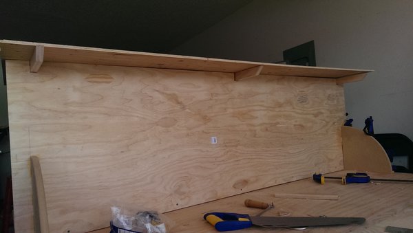

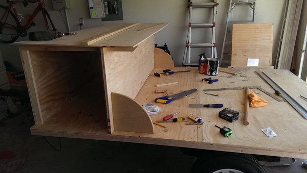

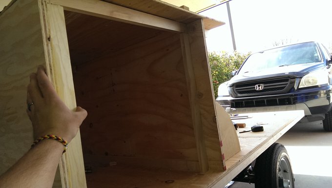

So, I framed out the storage compartment/bunk, added some square supports and the bunk supports, and purchased an orbital sander, and two trailer jacks (a wheeled one for up front and a footed one for this rear). I also drilled through the frame for the carriage bolts that will hold the tear to the trailer. I struggled to find much time this weekend, but I suppose the progress is acceptable. I also bought some mineral spirits and poly to coat all the wood. Hopefully, I will secure the bunk to the storage area (it is just sitting on top in the pics), and coat at least the bottom of the floor with the poly. Then, I wait for uncle Sam's check to get the rest of my supplies.

Postby GPW » Mon Feb 24, 2014 6:12 am
Scuba, Cool !!! :thumbsup: 8)
That’s some strong framing inside :o .... You could lighten that a good bit using some aircraft techniques... and a jig saw...and still have the strength you need ... The basis of a foamie is : Every pound you save in the construction means an extra pound of your “stuff” you can carry along !!! :D
