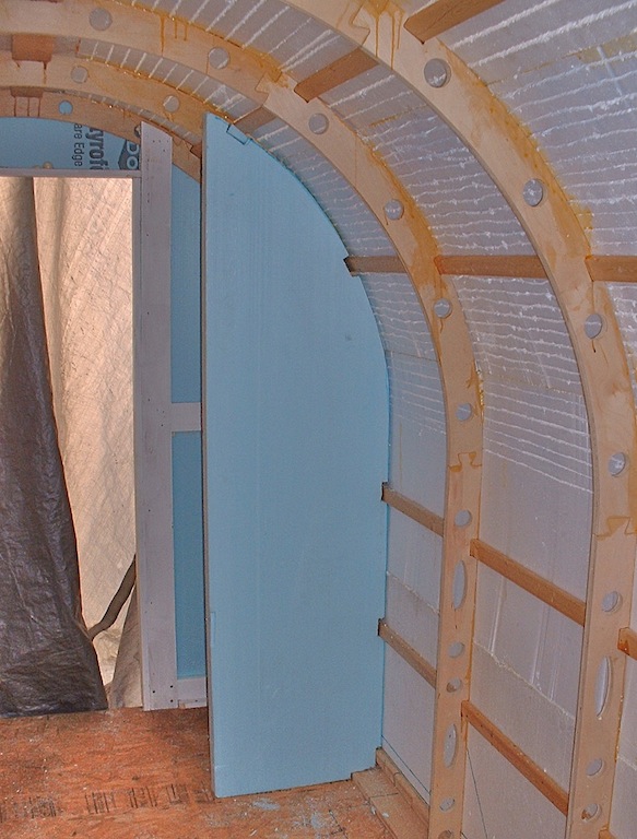

Got the Mini galley foam wall cut ... just a little more fine tuning and we can glue it in ... :D

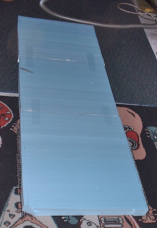

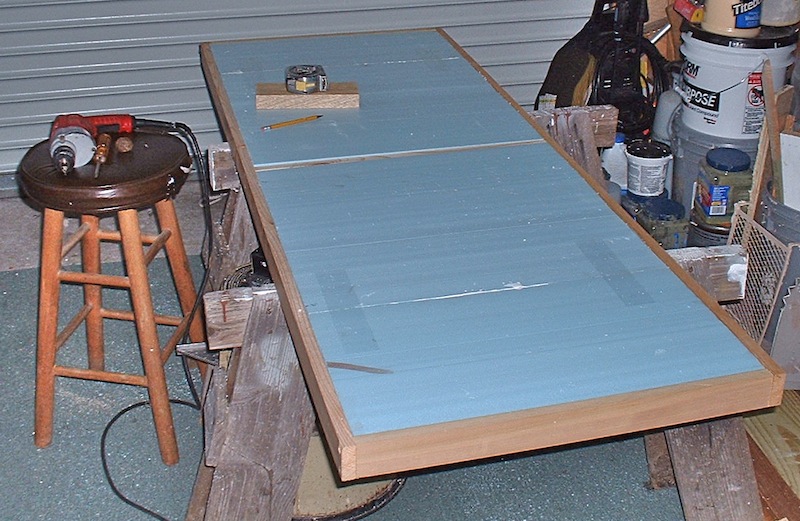

We’ll be off to Vinnie’s early to get that wood cut ...The door blank is made up of 3 sections glued together , with the Gripper ... and it’s dry and holding well ... We used packing tape to temporarily hold the Blu foam together... packing tape wouldn’t stick to the bead board at all ... but sticks fine to the extruded foam ...

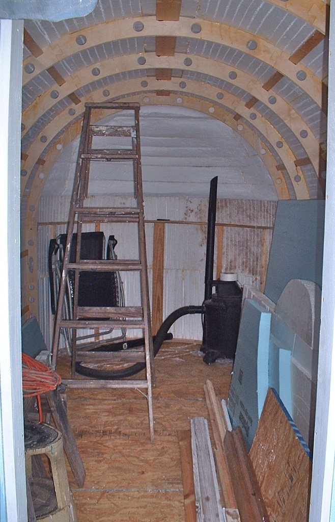

Just remembered Monday is the new band night , had to clean the Studio up (those gazillion foam bits) so people could enter... decided to temporarily store the materials in the trailer itself :o ... Not a bad storage trailer eh ? :D

Yep, just like my garage... You'll never be able to camp in it now! :lol:

Got back from Vinnies’ ... got the wood cut for the door :thumbsup: ... The last of the major woodworking ... pretty much ... :thinking:

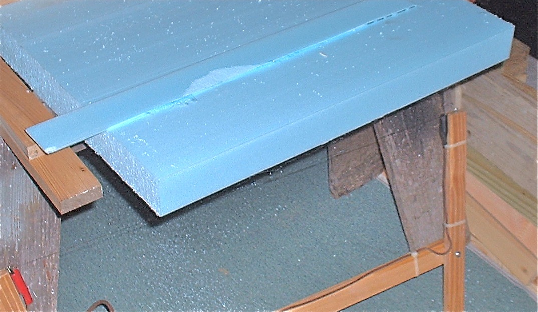

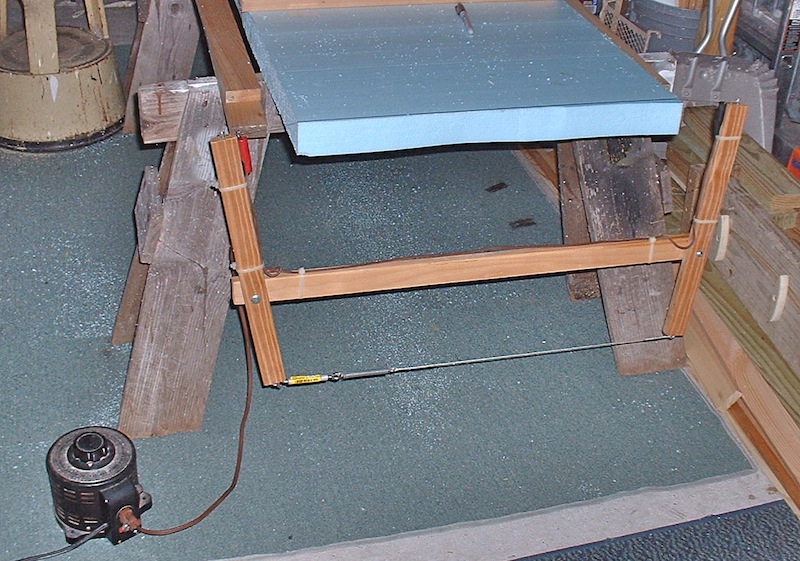

Now that the place is clean , we plan on dirtying it up some more today ... making that door ... Still awaiting the AC and windows before we can cover it , but once we get the door done , we can start by covering the back end ...That’s the start of it anyway ... Hope to make a video of the gravity plumb cutting with the hot wire bow .... so easy and always a Nice straight cut ... :thumbsup:

Made my gravity cut .... wasn’t able to get the video camera working so took a couple still pics ... First is the is the cut itself ,second the wire resting on the line pre-cutting wire resting on the line to be cut ... :thumbsup:
Got all the wood cut to length , now on to assembly ... :D
Re: FoamStream...
Postby GPW » Tue Jul 02, 2013 9:48 am

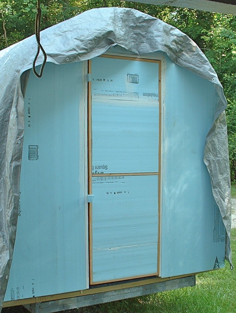

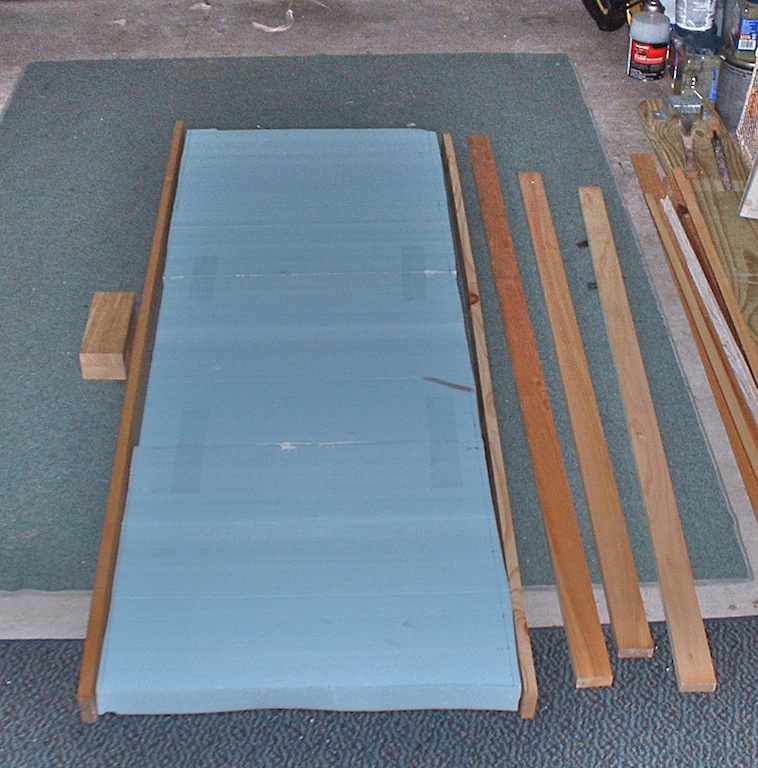

Door mock-up done !!! and checked for fit ... Now to take it apart and glue everything up solid ...

All door parts for the door glued up and drying ... T2 used for the glue up , because we have a lot of it ... :D
