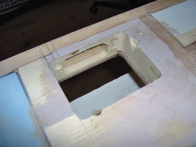

Started by finishing up the street side door latch hole cut outs. I must have changed my sequence and did both rough cuts before routing out the main latch body hole, because when I went to route it out the bottom bearing fell into the bolt hole. :thinking: The little scallop is not a big deal and will easily be covered by the latch flange. I ended up just trimming the rest of that area with a chisel. Then I went back to the curbside door and filed the clearance notches just a bit more allowing for the canvas and paint to come later. This is actually the curb side door again, but they are both similar.

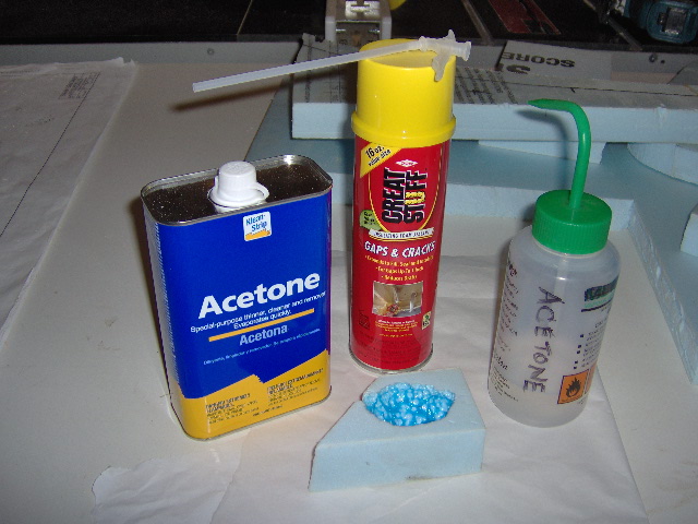

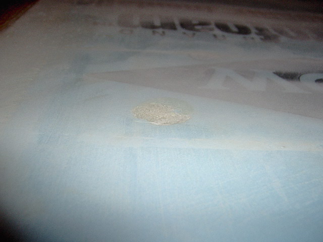

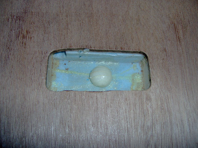

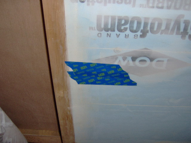

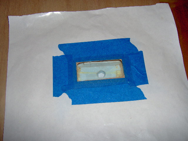

When I used the rotary broach (slugger bit) to cut the pilot hole in the skin for the street side light switch recess, I created a boo-boo. The slugger bit has a spring assisted center arbor that centers the bit and ejects the slug. You have to push down some just to get it to compress and drill. Well when the hole was completed the force that I was using to compress the spring caused me to push the broach straight thru the foam poking a hole straight thru the out surface of the wall. Even gouged the underside of the floor (work table) with a couple of nicks (I knew there was a good reason for working on the underside instead of the good side). The floor was no big deal, just laid on a couple of dabs of TB2 to seal it back up. Decided that the best repair for the hole would be to try GS spray foam. First I got set up with some acetone to clean the straw and nipple on the spray can (so that I can use some more later).
Note that the acetone does in fact melt the foam rather impressively. Thanks Wobbly for that tip; worked a charm.
Next I taped a small piece of the freezer paper to the outside face of the wall.
Then I masked off the inside panel around the switch recess to protect from any foam drips or accidents.
Then I squirted a dab down in the hole and cleaned up the spray straw with the acetone (rubber gloves, yes).

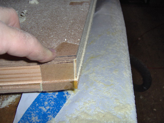

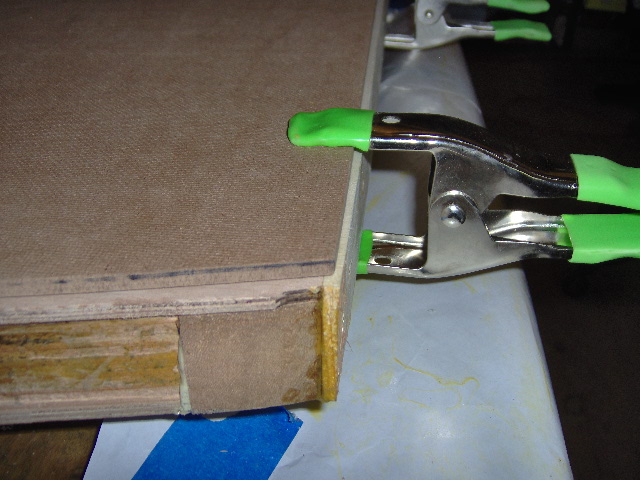

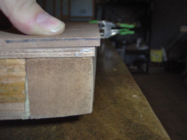

The laminated galley edge piece had so much spring in it when I clamped and glued it in that it pulled the tail end of the wall sill up almost 1/8 inch, running back to zero at the bulkhead side blocking. Here you can see the sill on the bottom, the galley skin sticking off about 1/16th, and the template bottom sticking off about 1/8th (the bottom of the wall is to the right).
Karl and I had discussed that this probably would have no effect on anything too important and the floor would likely wing up to match. Then the trailer frame would wing up when the cabin gets bolted to it. I just couldn’t stand that thought, so I flushed the skin off to the sill…
… ripped and re-sawed a slat of pine (didn’t have a big enough scrap of cedar), and glued that to the bottom rear section of the wall.
Now I can set the template in place and when I route the upper profile I can come around onto the bottom and shave the excess part of the shim back flat (a lot easier than trying to make and glue on a tapered shim). The little square scraps of ply were just used as large washers to help spread the load from the temporary drywall screws used to clamp the shim on.

Glad to hear the acetone trick worked for you.
It's amazing how little you actually use in a squeeze bottle. It's also nice to know that, if you knock it over, it won't spill and trash your work...which is looking great BTW.

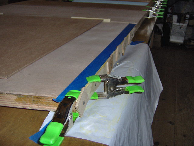

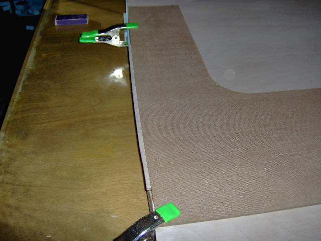

First I pulled the clamps and screws out of the street side galley wall shim and shaved it down flush to the inside panel using the little matchbox plane and 220 grit on the small block.

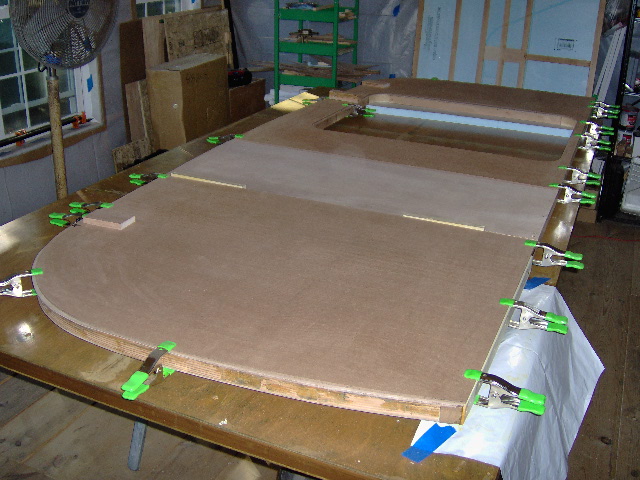

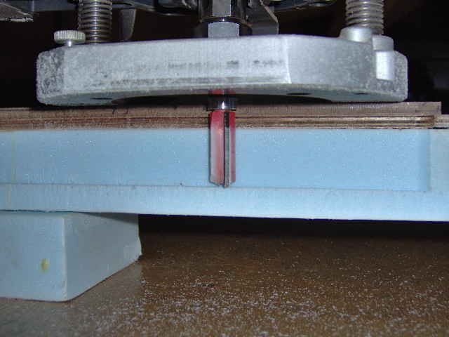

Then I set the galley CNC template using a couple of temporary cleats in the bulkhead dado to butt the template up against.
The blocks sitting on top are just larger visual cues where my marks are signaling me to stop before I get to the inverted curve (wrong) parts of the templates.
Here is a close up of the galley shim (bottom of wall is to the right). Note how the template overlaps the shim by about half at the rear…
… and not at all at the front under the bulkhead blocking (not visible in pic).

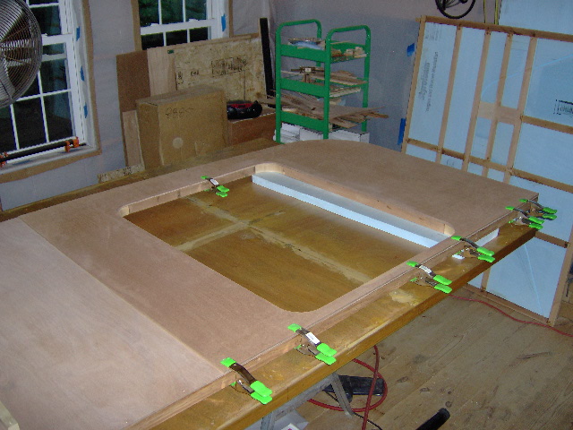

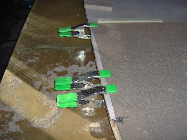

I started routing at the lower front and worked my way up the wall to the point where the small front radius transitions to the low crown radius of the main roof. Here you can see that my top bearing bit does not reach the whole thickness of the wall in one go.
That’s okay, I have a plan. The ceiling skins were cut 1 inch shorter than the outside cabin width for two reasons: (1) it allowed me to optimize the marine ply cutting schedule and saved me a sheet, and (2) by holding the ceiling panel in from the outer edge of the foam I can seal any areas of the edge that aren’t covered up by variations in this little excess ledge. Where the excess ledge is strong, I’ll just sand it down flush to the top of the ceiling skin before applying the roof foam, and where it is thin I will squirt some GS in the groove and sand that flush to the wall face. I’m hoping that this will give a softer edge so that the plywood seam does not telegraph thru the canvas.
Here you can see where I have routed the tight front radius and stopped (bottom of pic) leaving the main crown to be done by repositioning the middle template (shown in its rightful position up on the other side of the door, top of wall is to the right in this pic… the front template has already been removed).
Here the top of the wall is to the left and you can see where I started on the sharpie marks indicating the top of the hatch big radius and worked my way down the hatch. Note how the template runs the wrong way on top compared to the rough cut.
The alignment cleat is more visible here.

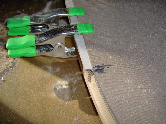

You can see how I hop scotched the spring clamps around (used scrap backer pieces of the thin ply to keep the clamps from denting the outer surface of the wall foam where necessary).

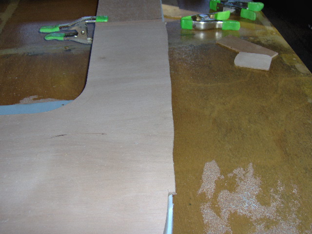

Here is a shot looking up along the sill were I have routed along the lower curve of the galley rear (bottom of pic) and back up to flush off the shim.

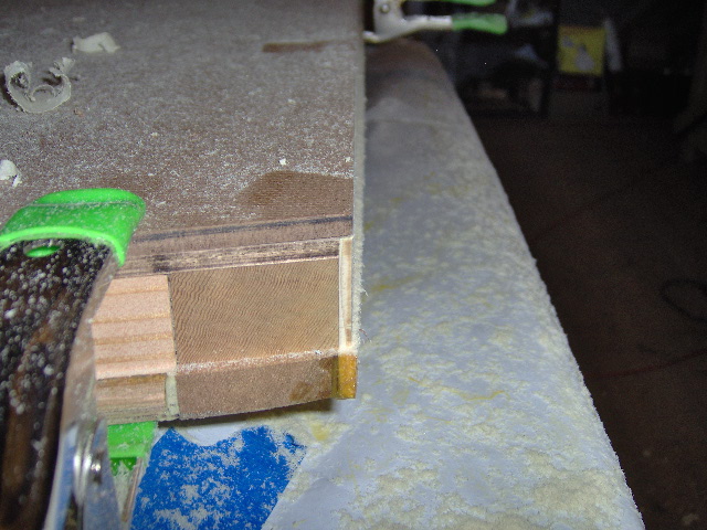

A little further along I will flip the wall over and trim the rest of the sill and hard galley wall edge using the bottom bearing bit to follow this cut from the other side. Also note the nice tight grain of the cedar.

About this time Karl and Simon came for a visit, so I knocked off from running the router and switched my attention to the light switch hole fix. That way I could visit for a bit and still keep working. I was going to try and shave the little mushroom of excess GS out with a chisel, but I couldn’t get the angle needed with it down in the hole, so I just sliced it several times like a hardboiled egg slicer and chipped the slivers out.
After Karl and Simon cut out, I finished the previous router cut and repositioned the middle template again to bridge the bad section at the top of the rear template. In this next pic the top of the wall is down and the top radius of the galley is to the lower right.
Before flipping the wall over so that the outside face was up, I did a little clean up. This helps protect the foam from getting scratched up by and/or having sawdust ground into it.
Pulled the mask off of the light switch hole fix, shaved the small bulge with a razor blade, and hit it with a quick scuff using 220 grit.
After a final round of spackle it will disappear.

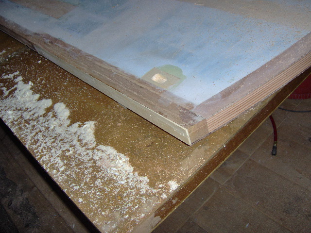

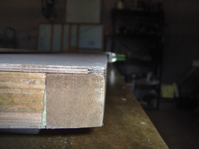

Here’s the galley sill shim after flushing off from the other side.
Like I said, 1/8 inch to nothing.
