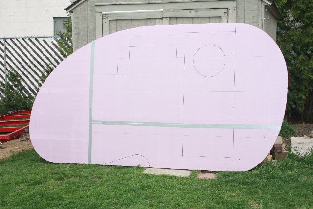

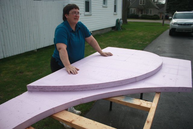

Postby mikeschn » Sun May 01, 2011 5:23 pm
Second attempt...
I got Chell to look at a CAD drawing, and even though she says she can't see the final product when she looks at a CAD drawing, she seemed to like the new profile.
So we cut it out of 2" foam today...
BTW, notice, we were able to cut two tails out of the same piece of 4x8 foam. So that means we can build both walls with a total of 4 pieces of foam.
Here's the final result....
P.S. Oh btw, it's 11' long. That was the only way to build a teardrop that is 66" wide on the inside, and still be able to get a queen sized bed in there.

Postby Cliffmeister2000 » Sun May 01, 2011 5:30 pm
pretty neat, Mike! Is the tape holding the pieces together until glue dries, or is it just taped for show? If glued, what did you use to glue the edges together?

Postby mikeschn » Sun May 01, 2011 5:52 pm
Cliffmeister2000 wrote:pretty neat, Mike! Is the tape holding the pieces together until glue dries, or is it just taped for show? If glued, what did you use to glue the edges together?
It's just taped together so I can show you guys...
My thoughts for gluing the edges together, is to find a flat floor. The floor of the carport sounds good for that. Then glue the edges with TB2. Put Duct tape on one side, flip it over, remove the duct tape and put the canvas on the other side. After it dries, flip it over again, and put canvas on that side.
But that's just my first thoughts... I've got to read this monster thread from beginning to end. :shock:
The most amazing thing about these two shapes, is that they are both 69" tall. The egg is 10' long and the standie is 11' long. But the standie looks so much bigger.
The standie...
The egg...
Postby Cliffmeister2000 » Sun May 01, 2011 6:02 pm
I wonder how much foam is required to make a door-frame strong enough to support the roof structure...

Postby GPW » Sun May 01, 2011 6:18 pm
Mike , The TB2 won't dry on just the foam to foam join ... tried it ...stayed wet inside for weeks :o gorilla Glue is the ticket ... or epoxy ... Since the foam isn't porous , there's no place for the Water based solvent to evaporate ... Looks COOL !!! Glad the wife likes it !!! :thumbsup:
Cliff ... When in doubt about the door frame , some wood may help relieve your worries ... The skinned foam is actually quite strong by itself ... Just difficult to convince the non-believers... :roll:
