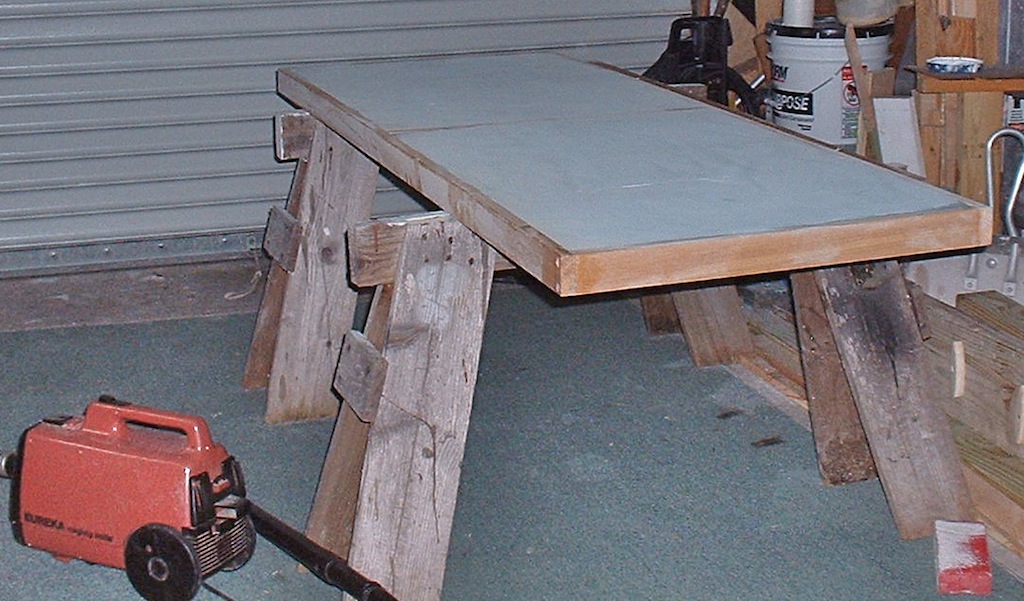

Here’s the door all sanded nice and flat ... now sawdust mixed in with the foam dust ... and cat and dog hair ... :frightened:

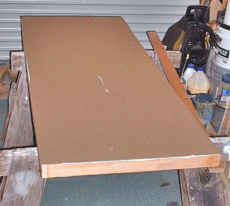

Thanks KC, it seemed “logical” eh ? OK, here’s what it looks like .... secured with straight T2 brushed on thinly but thoroughly ... immediately we were reminded that when that heavy paper got wet (from the glue alone ) it would wrinkle like crazy , leading to much lifting and smoothing .... grrrrr!!! :o The thing was to let the adhesive sit a while and tack up slightly , losing most of that excess water that would cause paper swelling .... on the places where we waited, it was Much easier to deal with, much less wrinkling ... But then , when it dries it all shrinks back really nice and Smooooth ... 8)
Actually this is even trickier than applying canvas ... :shock: For the next side , maybe papering with the Gripper ?... :NC
Kick plate ... Yes , absolutely , Thanks !!! :thumbsup:

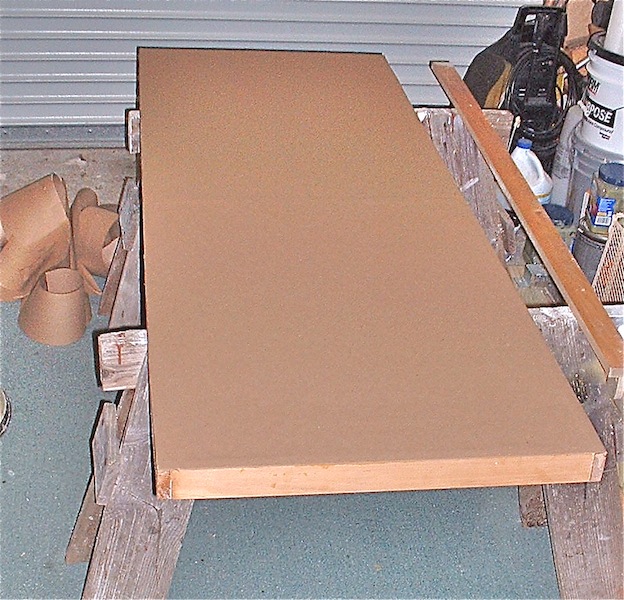

Here’s the other side done with the Gripper , which IMHO was not as good to work with as the T2 ... didn’t grab as well ,and doesn’t seem to wrinkle any less... initially ... may have to re-glue the edges ... :oops: Now that’s got me wondering if we don’t want to do the canvas covering with T2 instead of the gripper ... We know that works and how it works , having done it before ... and it’s Cheaper too ... Hmmmmm? :thinking:
