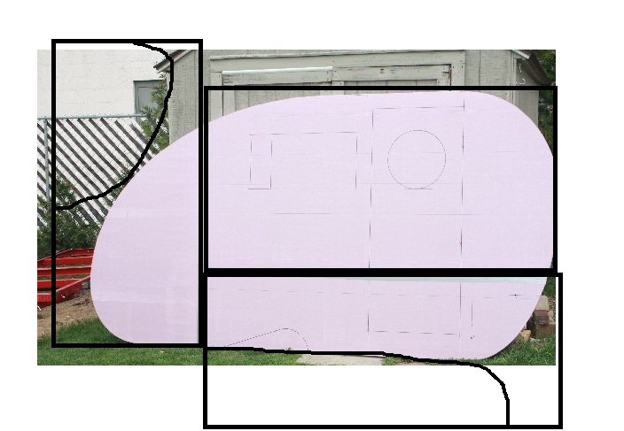

mikeschn wrote:Cliffmeister2000 wrote:pretty neat, Mike! Is the tape holding the pieces together until glue dries, or is it just taped for show? If glued, what did you use to glue the edges together?
It's just taped together so I can show you guys...
My thoughts for gluing the edges together, is to find a flat floor. The floor of the carport sounds good for that. Then glue the edges with TB2. Put Duct tape on one side, flip it over, remove the duct tape and put the canvas on the other side. After it dries, flip it over again, and put canvas on that side.
But that's just my first thoughts... I've got to read this monster thread from beginning to end.
The most amazing thing about these two shapes, is that they are both 69" tall. The egg is 10' long and the standie is 11' long. But the standie looks so much bigger.
The standie...
The egg...
eaglesdare wrote:also i thought i read where you only used 2 pieces of foam for each side? from looking at what you have, it looks like you used 3 pieces?
