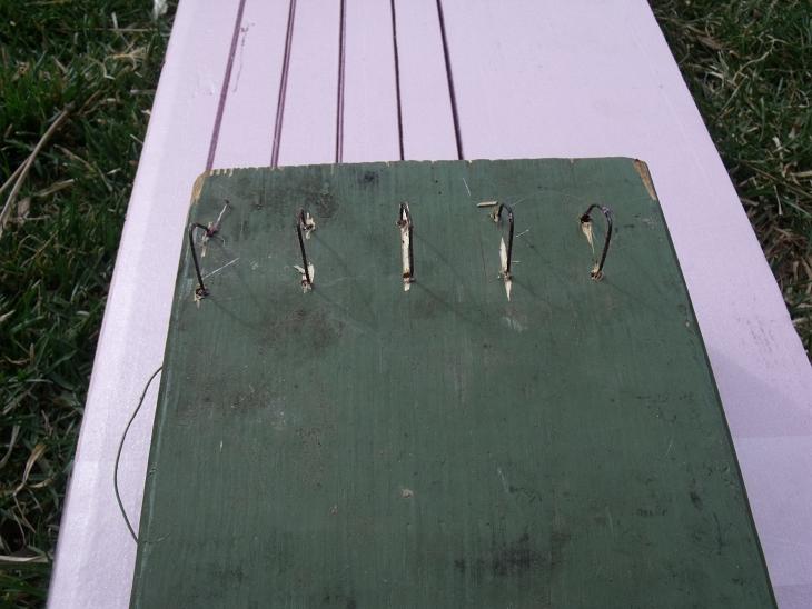

Postby GPW » Tue Mar 19, 2013 6:07 am
5 at a time !!! :thumbsup: That sounds like a great tool !!! :applause: Pics Please !!! :pictures:
Re: #1
Postby ghcoe » Tue Mar 19, 2013 5:56 pm
GPW wrote:5 at a time !!! :thumbsup: That sounds like a great tool !!! :applause: Pics Please !!! :pictures:
Here you go.....
DSCF1824 small.jpg (101.84 KiB) Viewed 2623 times
DSCF1821 small.jpg (83.41 KiB) Viewed 2623 times
DSCF1820 small.jpg (112.51 KiB) Viewed 2623 times

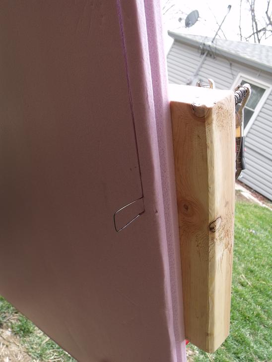

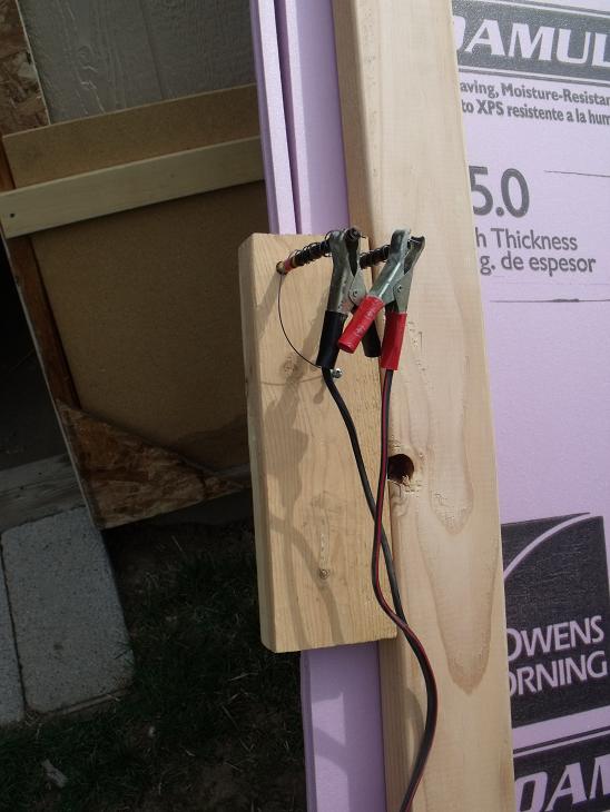

I make the jigs so that I know the distance from the edge to the wire. Just measure to the cut and then subtract the edge distance and set your straight edge, usually a real straight 2x4 for me. You can see I have the jig below set up for 3/4" on each side. I find that the foam is forgiving some so even if you are off 1/8" you should still be ok. I cut the galley all at once and then cut the bulkhead portion out of the middle so that both sides would match up perfect.

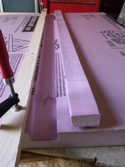

jig
DSCF1781 small.jpg (78.11 KiB) Viewed 2552 times
I like the hot wire method because I get no foam dust and the grooves make for some pretty strong joints. Also, the cut is so clean compared to the jig saw cuts.

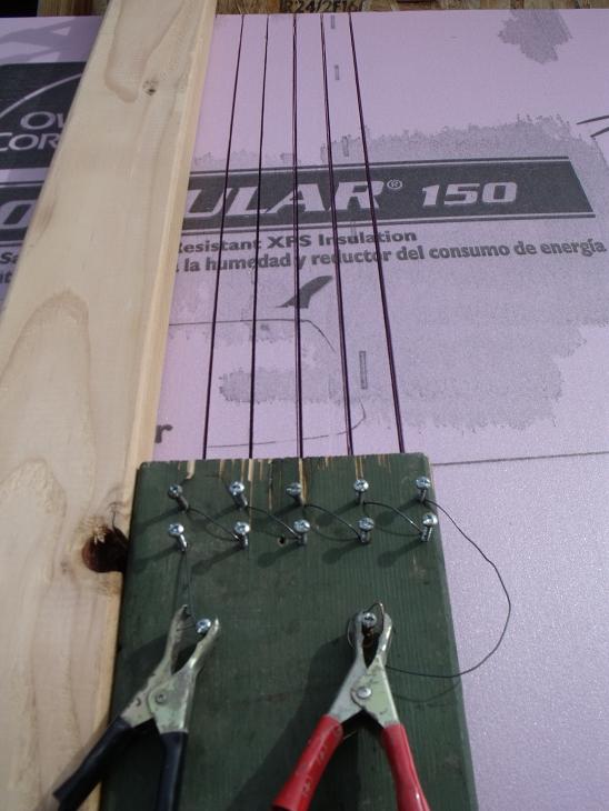

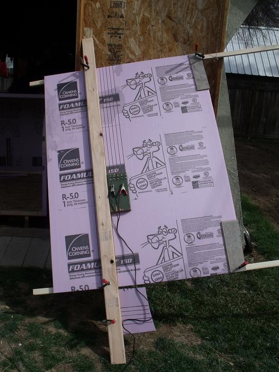

Then I fired up the new hot wire jig. :thumbsup:
New Hot Wire Jig
DSCF1834 small.jpg (80.06 KiB) Viewed 2500 times
George.
ghcoe
Posts: 1982
Location: SW Idaho

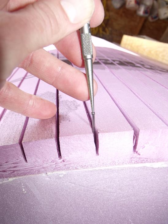

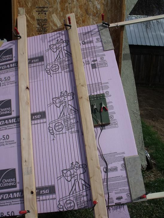

Re: #1

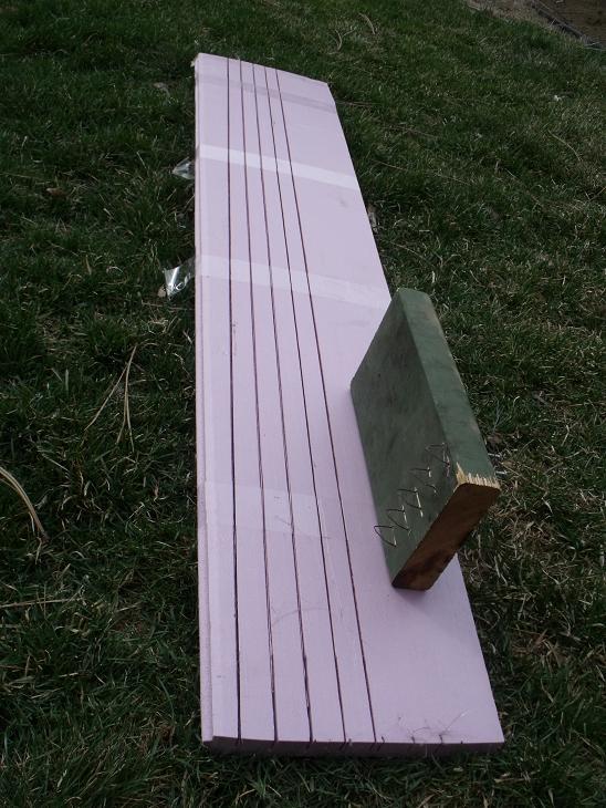

Postby ghcoe » Sat Mar 23, 2013 8:26 pm
I timed how fast the hot wire would cut the width of the foam. It took 4 minutes to cut and 2 minutes to reset for the next cut. Worked great! :thumbsup:
I could use the last cut for the next straight line. I would then double checked the distance form the end before starting the next cut. I did not time myself towards the end, but I believe I shaved at least a minute off the reset time. That makes five cuts in 5 minutes, 35 cuts = 35 minutes. 45 minutes from setup to tear down not bad. :R
Foam set up for Hot wire
DSCF1836 small.jpg (102.69 KiB) Viewed 2499 times
Foam set up for hot wire 2
DSCF1839 small.jpg (113.67 KiB) Viewed 2499 times

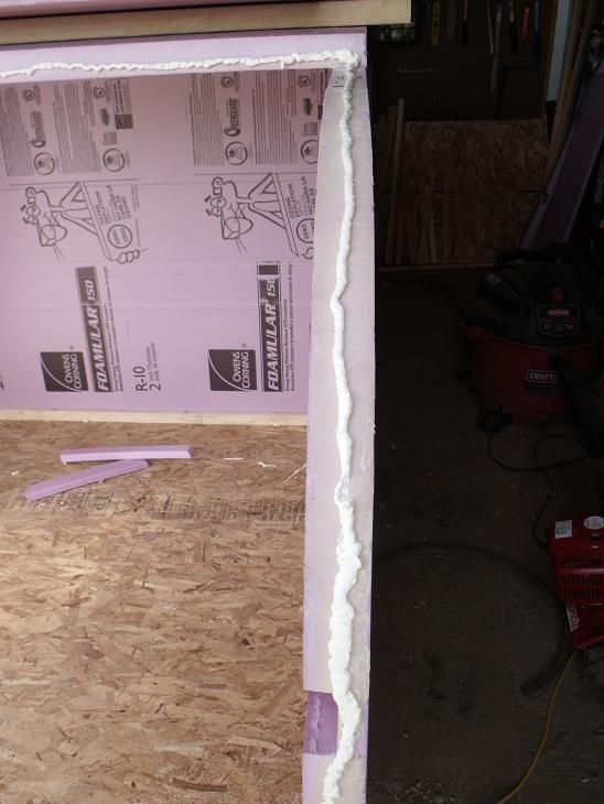

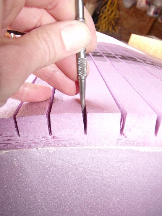

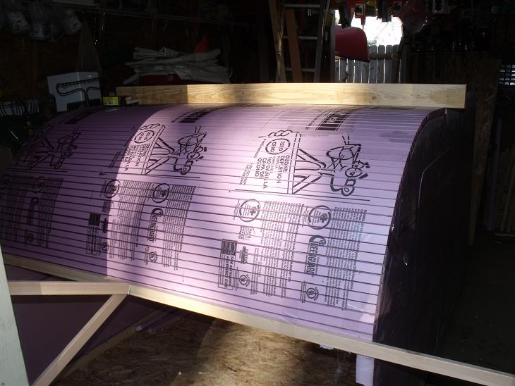

After kerfing I checked to make sure the foam would bend around the radius. I am pleased to say it bent just fine...... :) I applied some Great Stuff to the attachment points and layed the new roof section in place.
Glue
DSCF1840 small.jpg (83.92 KiB) Viewed 2499 times

Postby ghcoe » Sat Mar 23, 2013 8:44 pm
After getting the roof on I made sure the walls were flush. I did one side and then the other, then I noticed it was off again on the other side. :thinking: I fixed that and then the other side was off....... :roll: The glue was too slick and I did not want to wait till it got tacky so I came up with this. :twisted: I placed a finishing nail in every other groove, as I aligned the wall AGAIN, I would press the nail in all the way to the bottom of the groove. This fixed my problem :thumbsup:
Finishing nail
DSCF1844 small.jpg (88.99 KiB) Viewed 2496 times
Finishing nail 2
DSCF1845 small.jpg (87.76 KiB) Viewed 2496 times
After I got the walls aligned again, I still had a slight bow in the middle along the bottom. I used a 1x2 and some scrap wood to wedge it back to where it should be. It did not take too much pressure this time so all should be good...... :worship:
