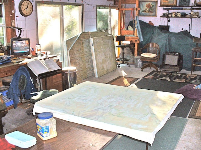

Covering is getting Much easier ... got most of it done now , just a couple little pieces to go ... Image
Still looks like a mattress ... :oops:
Postby GPW » Wed May 04, 2011 9:50 am
WARNING :.... :o I brushed against a dry panel and the corner skin popped off ... :shock: The smooth foam skin offers little tooth to adhere the T2 to , so we've taken to sanding/scuffing up the foam surface to provide better adhesion ... Just a light pass with some 80 grit on a block to break the gloss .... then vacuumed ...
I Do want to provide the Best adhesion possible so this extra step may be worth the little added effort ... :thinking:
