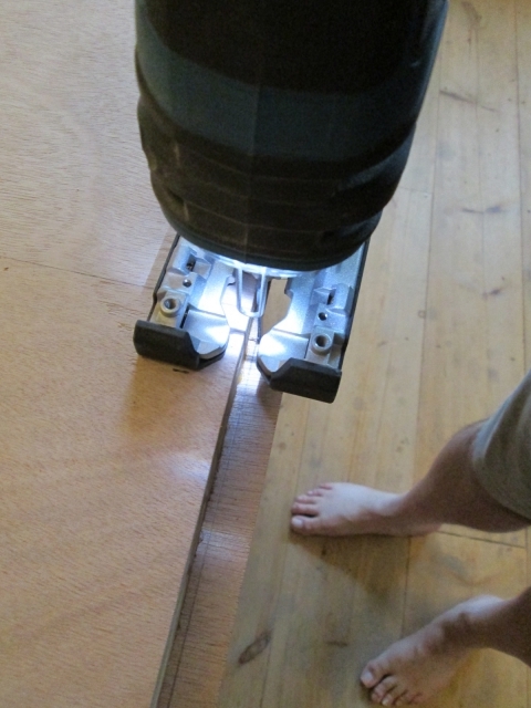

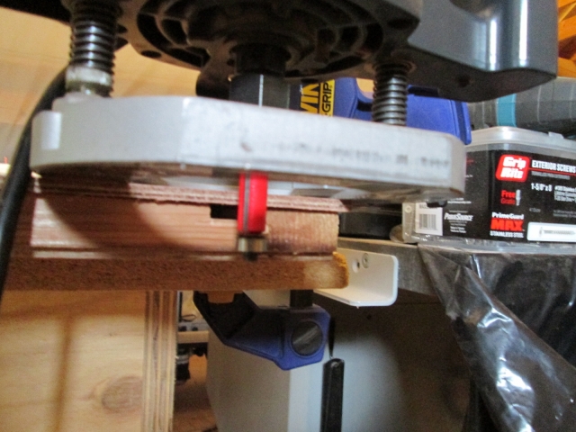

Here I am rough trimming the back panels of the bulkhead. You can see the pencil line I traced, same as before, using the width of the carpenters pencil as a gauge. And you can see the advantage of the LED lighted battery powered jigsaw (love that tool!).
Please disregard my barefoot feet. Even though it was cooler and less humid, it was still just too hot to stay in my work jeans and boots, and I had forgotten to bring my flip-flops… again.

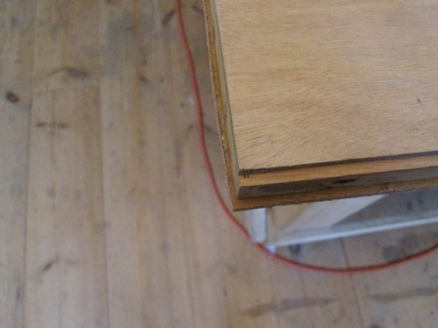

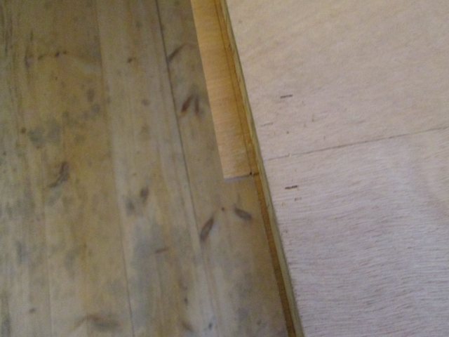

Let me try to explain this next pic. At the top right you can see the cabin side skin of the bulkhead with the rabbet along the side (lower edge in pic). Then you can see the exposed frame that will be glued and screwed into the dado of the side wall at the gap in the inner side wall panels. Then you can see the galley side panel edge after rough cutting with the jigsaw… makes for a cleaner cut when the jigsaw is pulling up into the face of the panel; less splintering; and then there is the orange squiggly line, which is the extension cord laying on the floor beyond the detail that I am trying to show.
Completed part of the rough cut, showing the cut contrasted between panels.

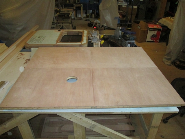

After doing the rough cut, I flipped the bulkhead panel over and remembered to set the bottom bearing bit so that it would not fall in to any holes, including the wire ways under the skin (dark area in pic).

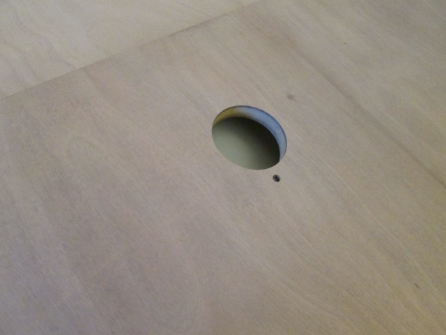

After a lot of hand sanding it wasn’t looking so bad. Also note that I had routed out the bulkhead fan hole to match the other side.

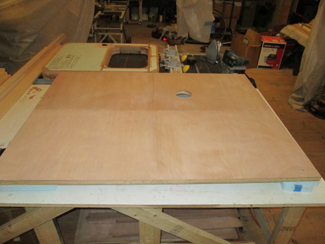

Used my marked up drawing to locate the wire way holes, measured twice, checked orientation twice, and drilled the holes. Used the prong on the end of the little circle compass to stab and dig the slug from the core bit out of the holes. Here is the top street side rear of the bulkhead where the hatch wires will come out and jump over to the hatch.
The little blue edge of foam sticking out from under the left edge of the bulkhead is just a spacer of foam being used to hold the bulkhead up off of the work table. The blue foam visible in the hole is the core of the bulkhead where the wire way trough was routed into the foam.

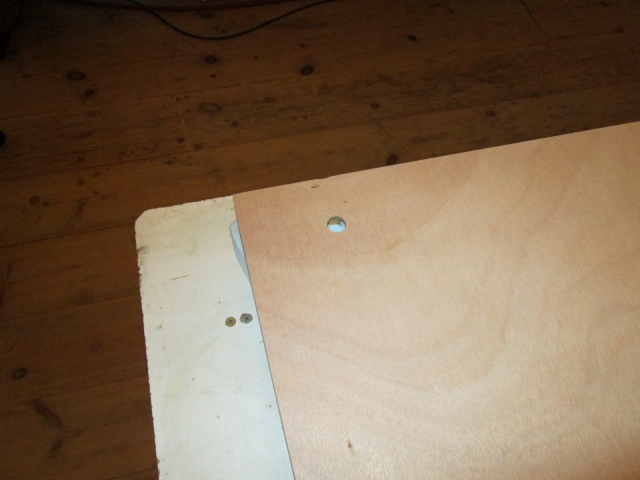

Here is the back of the bulkhead skin with the fan hole and fan wire hole cut.

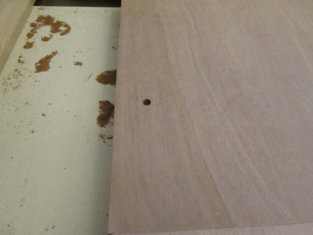

Kind of mundane, but this is the wire way hole in the back of the bulkhead skin where the hatch actuator switch wires will pass (shown upside down, curb side on left).
I won’t bother showing the holes that were drilled for the hatch actuator wires at the actuator lower bracket locations (they don’t really show up and are kind of meaningless at the moment), but here is another shot of overall progress after fairing (as best I could) and drilling all of the galley side holes.
