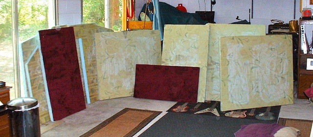

Postby GPW » Wed May 04, 2011 12:20 pm
All Done ... inside anyway ... Image
