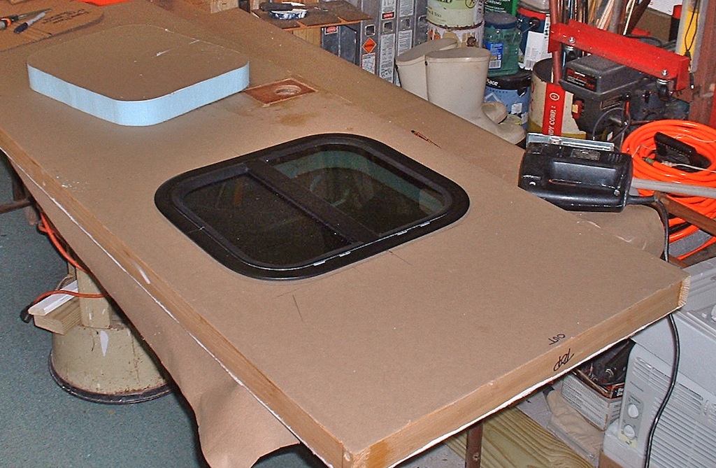

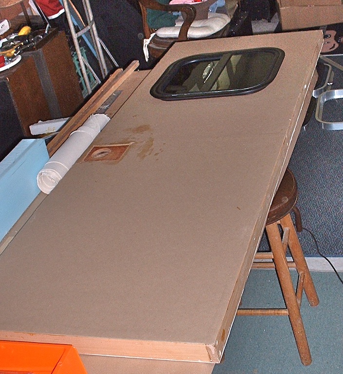

Placed the window on the door to see what it’s going to look like ... Looks Good to me ... just the right size ... :thumbsup:
Now these are the same size windows for the sides , and might appear to some to be quite small for that purpose , but since the FS is all about comfort and PRIVACY , I’m sure they’ll be OK... that and they’ve already been approved by “you know who” .... :lol:

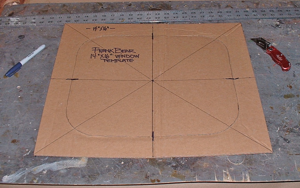

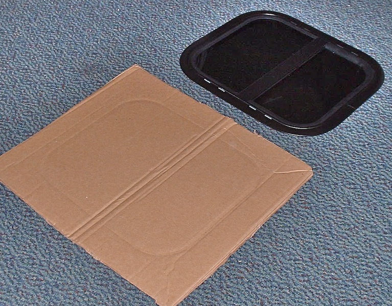

Had to run to the Doctor’s this AM (annual ) ... so lost a good bit of the cool hours of the morning for trailer work ... guess we’ll start fitting the window to the door , so we can get that all covered and out of the way , without having to work outside ... Once we get the door window fit , am going to make a cardboard template to cut out the other two holes in the cabin walls ... much quicker and easier that way ... despite having to make the template .. which BTW may be useful later on should we decide to add more windows in the future ... :o
Just in case somebody doesn’t know how to make a quickee’ window template .... just press the window down firmly into a piece of cardboard ... it leaves a nice mark of where the window edge is and can be easily traced around and cut out ... as will be seen in the following pics ...
Re: FoamStream...
Postby GPW » Tue Jul 09, 2013 11:17 am
Done !!! A few minutes invested and now we have a template to draw out all the window holes ... and it fits Perfectly .... Easy huh ??? :D 8) :thumbsup:

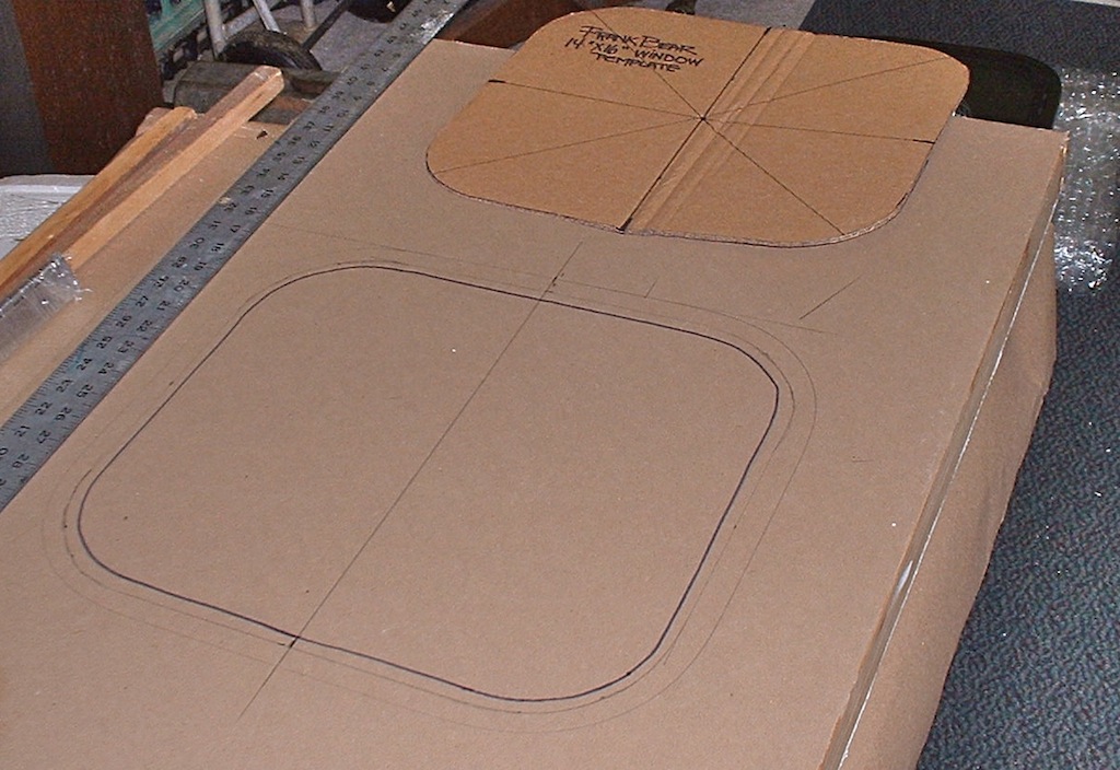

Re: FoamStream...
Postby GPW » Tue Jul 09, 2013 11:37 am
Just popped back together , squared off and marked ... Ready to go !!!
Re: FoamStream...
Postby GPW » Tue Jul 09, 2013 12:06 pm
Laid out on a centerline (door) , cut out with jigsaw and it fits !!! :D
