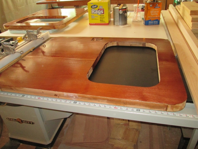

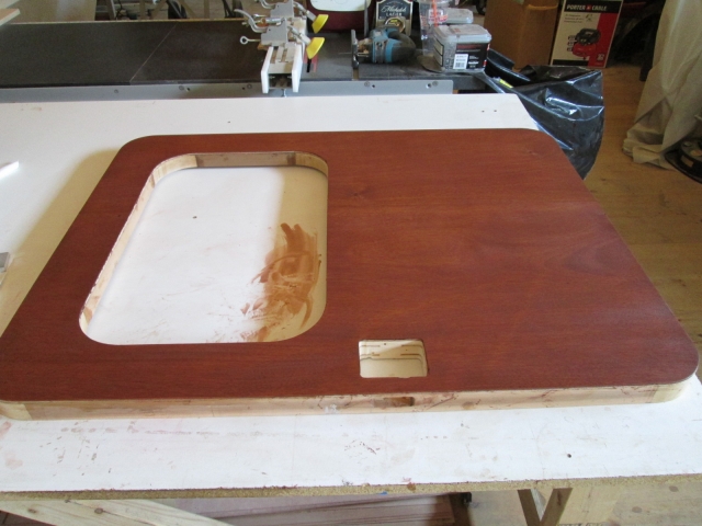

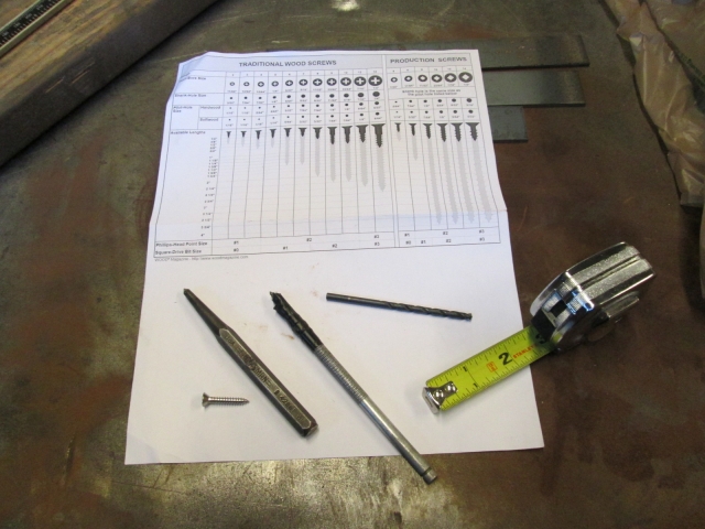

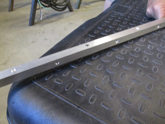

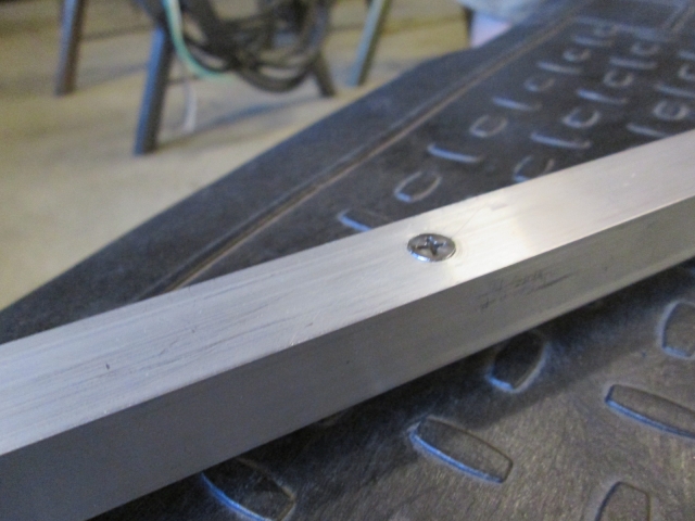

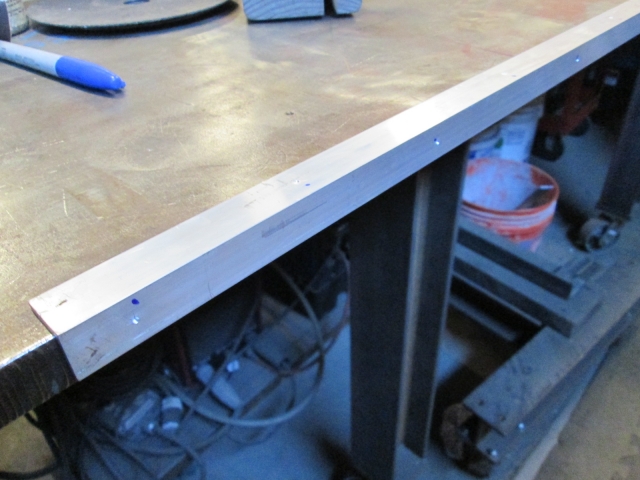

Anyway, here are some pics from last Thursday working on the rear floor trim for the galley. Wood screw size chart, SS No. 8 x 1 inch flat head screw, nice sharp center punch, layout scribe (with elec. tape on handle), measuring tape and a layout square (not shown).
After some layout work dividing the screws up 6 inches on center you can see some of the prick punch marks.
Sorry, no pics of the milling operation. Used a centering bit in the mill to drill them out, then just a quick hit with a file on the back side to remove any burrs.
The guy at the Borg talked me into this wool fleece pad for applying the polyurethane.
It didn’t cost any more than a good brush of similar size so I bit. Unfortunately, the first stroke on the galley floor left a trail of curly wool hairs in its wake. I quickly wiped that area clean with a paper shop towel, threw the wool pad in the trash, and got one of my good brushes out. (Later I dug the pad out of the trash and cleaned it, thinking that maybe it just needed to be broken in. Maybe I’ll give it another chance later.)

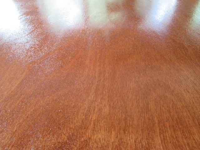

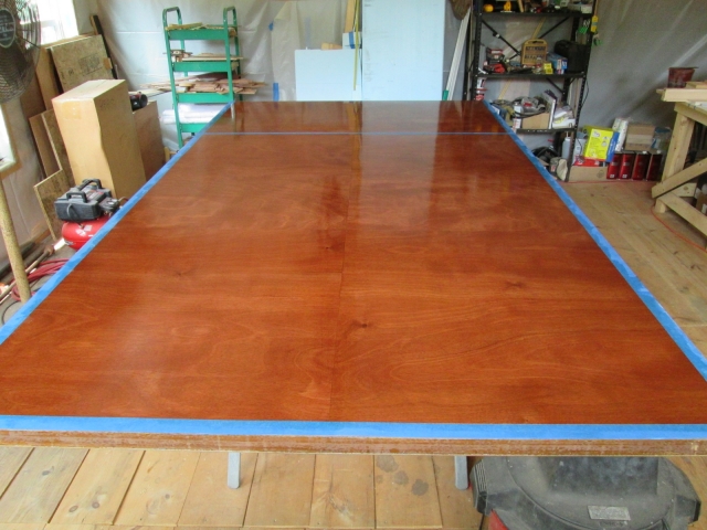

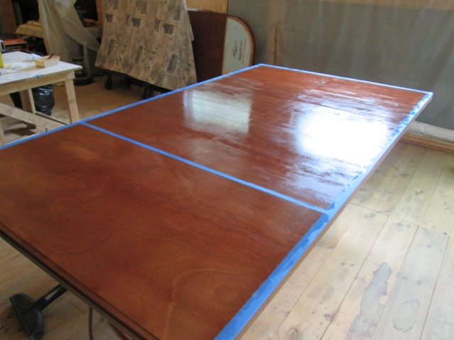

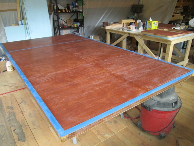

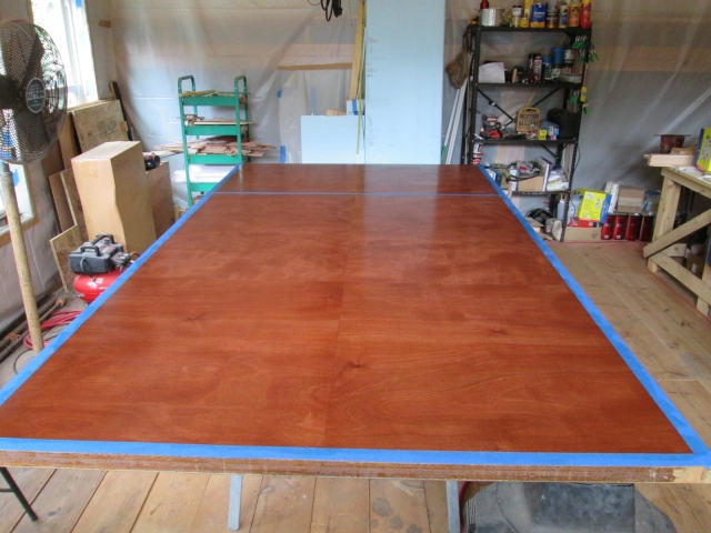

I got a little excited and took a few extra pics of the floor with the poly as it dried.
These first couple are fully wet.
While that was setting I turned to the front of the bulkhead wall. I hadn’t really thought out my sequence for the day, and kind of forgot that I hadn’t sanded this down through the grits before I had started slinging stain on it. Well I wasn’t going to sand with the floor sitting there just feet away with a wet coat of poly on it, so I just went ahead and stained it anyway.
Got a few more frizzes, but I guess I’m not too worried about it coming out okay in the end.

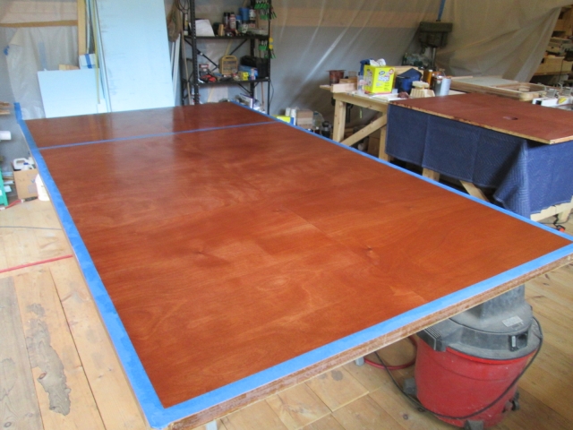

The floor after it was tacked up enough for me to feel comfortable turning the fan back on.
And this is just the first coat, nibs and all.
Judging by how this looks already, I think I will be thrilled with the final outcome.

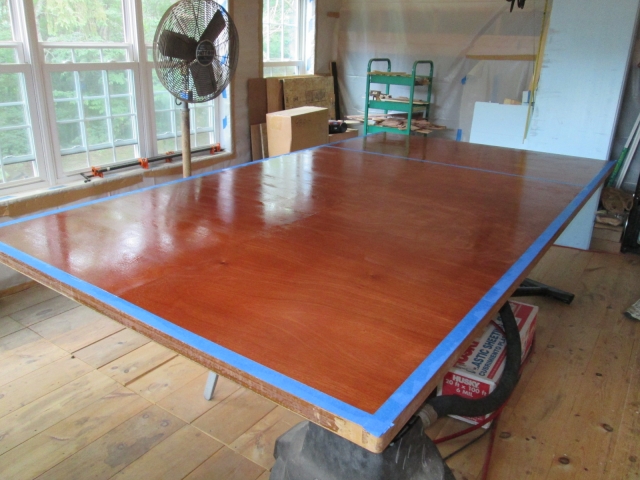

I had resorted to rolling up one of the staining rags, soaking it in the water at the bottom of the ice chest that I brought with me, and wrapping it around my head to help stay cool. Sat for a while in front of the fan.

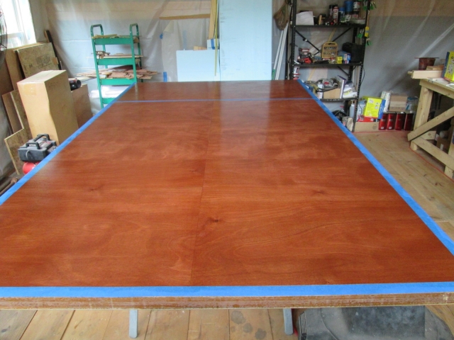

Here it is again pretty well dry.

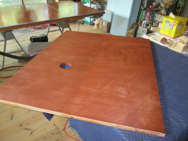

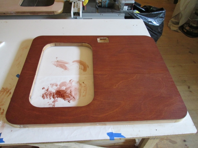

Now that the floor was pretty well dry, and the fan was blowing again, I felt comfortable sanding the inner skins of the doors.

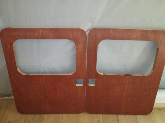

Curb side door stained.
Street side door stained.
And together.

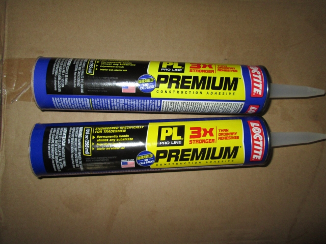

I did a little online searching about the PL375 I had bought, looking for application techniques, and found a lot of users complaining about how it has been reformulated and how they were very unhappy with the curing time and runny texture; so on the way home I took it back for a refund and got the PL Premium. Unlike the 375, it says it’s water resistant and paintable.

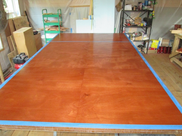

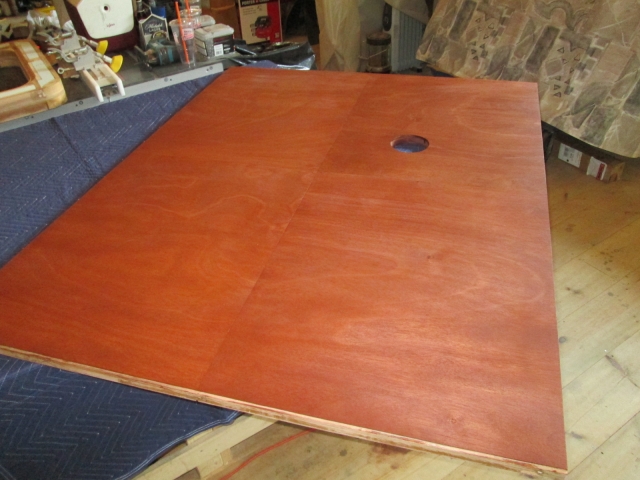

Started by blocking the first coat of poly on the floor using the small block and 220 grit, hitting the high nubs, then switched to a greenie pad to scuff in the low lying areas. Nothing here is that level and I didn’t want to break thru the finish on the highs to get to the lows, but I wanted to make sure that there was enough “tooth” for the next coat.
Wiped that down with paper shop towels and laid down the second coat.
I thought I was laying it on pretty thick (it is “high build” poly), but when I went back for a closer look after doing the first coat on the doors I could see a few dry spots. I will probably do a little touch up in those areas during the week before scuffing it all again for what will hopefully be the final coat.

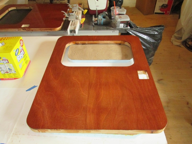

Speaking of the doors, here is the curb side door inner with the first coat.
And the street side door inner.
This is probably the least flattering angle that I could have possibly taken to show the panel joint in this door. I had been worried about the panel seams not looking too good and whether I would find them acceptable after finishing. I think I can live with this just fine… well, fine enough.
