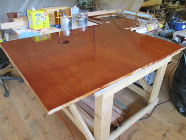

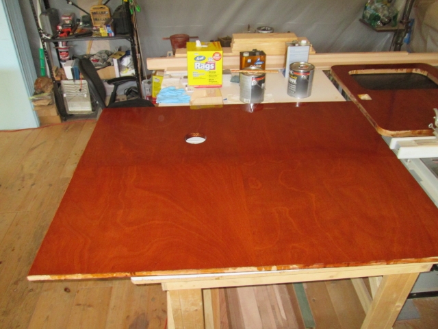

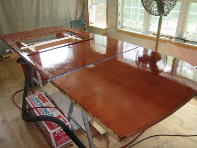

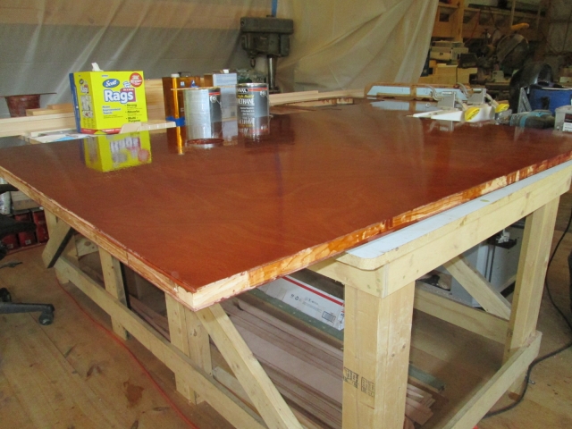

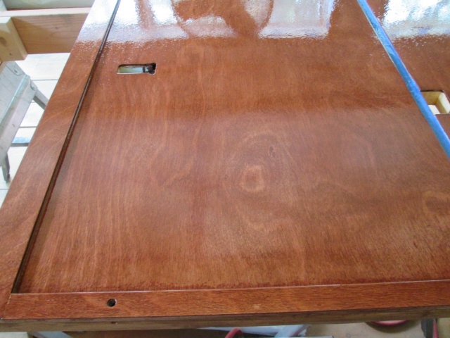

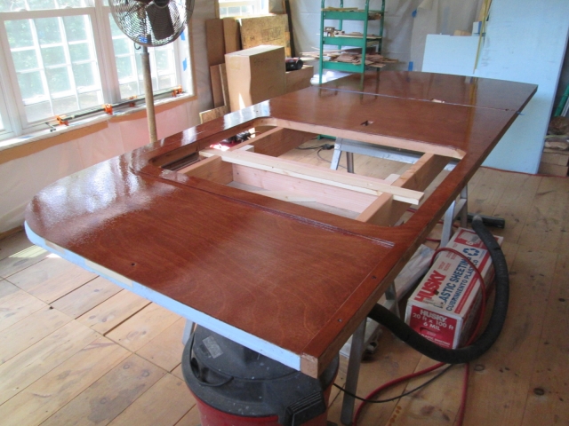

Forgive me if I’m posting too many pictures of the wood finish. I feel like a magpie with a shiny object… just can’t resist taking them. Call it newbie exuberance.

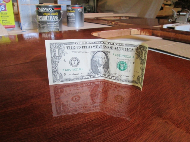

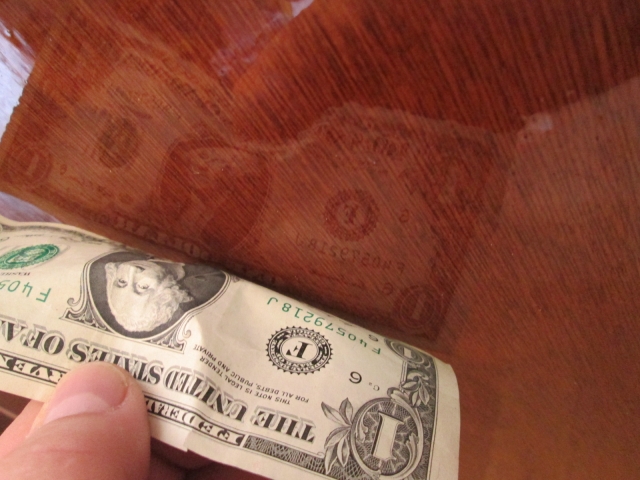

Here is the dollar trick on the galley floor. Maybe later I will cut it with some polish and wax? Probably not, but it is tempting.

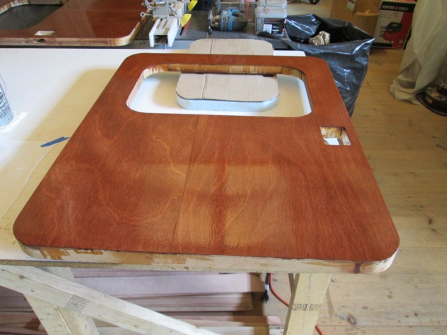

And the curb side door after the third coat.
Second wet coat on inside of bulkhead. There are some major sanding scratches in the wood, but they will be inside of the cabinets so not a big deal. Still, I wished I had planned better and not rushed past that step of finish sanding.
Second wet coat on the curb side wall.
Weather is much better but it was still warm up there by this time, so that was it for the day; just a couple of hours of work.

Never say never! Probably not, but maybe. The thought had crossed my mind. Get rid of the last of the little bubble craters and slight orange peel.
On the other hand, it is still just a camper and good enough is good enough, beyond that becomes some sort of obsession, maybe? :?
Thing is it would take it to the next level... but might make some of the warts stand out more. :roll:
No, I think this is where I need to stop. Maybe. :FNP
The wood work my buddy Dale does on his boat gets wet sanded, buffed and polished. Looks great, flawless. Then again he is using hard teak and mahogany (IIRC).
