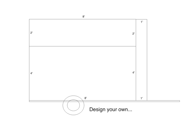

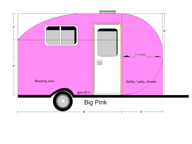

Just felt compelled to do yet another drawing ... :o Just two gently bent surfaces to deal with , the rest all straight cuts... Image
Postby eaglesdare » Sun May 08, 2011 8:29 am
i love your drawings. tell me, would a 9x6 be a wierd shape? 6' tall?

Postby GPW » Sun May 08, 2011 9:26 am
Probably not , and you might be able to arrange it on an 8' floor , only two partial sheets of ply ??? Best made the 6' + the width of both walls ... for a true 6' inside ... :thinking:
You want me to make a drawing that size that you can print out and draw on ???

Postby GPW » Sun May 08, 2011 9:37 am
Here ya' go .... Just size it to what you want and print out a few copies (saves a lot of erasing) Draw in what you want , and compare it to your other ideas, that's why several copies... ;) Image
