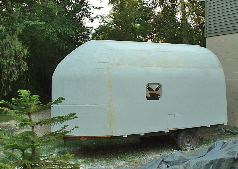

What ??? You don’t like the “Design Element “ ??? Actually my hot wire sheets weren’t all the same thickness.. :o The paddleboarders took the uniform sheets and left me with the C**P... (No good deed goes unpunished eh ! ) So I had to "make do and mend “ ! As you see , the front bottom wrap is considerably Thicker than the sheet above it ... ( My Bad! ) :oops:
smoothing /tapering it into the other sheet would have been a Lot of sanding , and look kinda’ Dumb!!! But being an Artist , we just changed the “mistake” into a “Design Element" by declaration ... Artist’s prerogative :R ... Looks kinda’ cool , sorta’ train-like ... gonna’ be FUN to cover... :roll: :frightened:
SJ, I absolutely have to measure THREE times now ... True !!! :duh: Smiling ... obviously a “Happy Camper” ... :lol:

Oh then yes, I can see a problem with covering that. You might just want to do that in layering sections rather than one sheet that has to adhere? More work in doing it this way, but you don't want that to become an "air pocket" area.

It will be “challenging“ since my heavy canvas won’t stretch much .. Thinking of a “reinforcing strip" over the ledge , then the canvas over that ... 3 piece ... :thinking: "Tis’ a puzzlement !!! "

I'm wondering if you might not cover that ledge very simialr to the way you did your window cut out edges. :thinking:
After the main sides and top are on, do the bottom piece first wrapping the sides straight back and pie cutting darts for the little angled ledge. Then a strip for the little ledge and part way up (say a few inches). If darting is required, overlap the lower section darts. Then wrap the middle section above that so that it overlaps. By breaking this elephant down into smaller bites, you can concentrate on the trouble area more during each phase, rather than fight it while juggling the bigger areas.

KC , Thanks ... was kinda’ thinking along those same lines ... stretching it isn’t going to happen ... too thick to mould around anything ... Your suggestion seems the Best way !!! :thumbsup: 8)

Whoa !!! here’s a neat trick .... Steam ... :o I had a couple bubbles from this morning’s covering job :shock: , likely non uniform glue application , although I tried... My little hobby iron didn’t do much, until I got a spray bottle with water and sprayed the bubbles ... then ironed over then with the hot iron .... Pssssss!!! bubbles gone , surrounding areas nice and smooth ... I’ll have to remember that one ... :thumbsup:

I’m going to have to EAT some words ... (again) :roll: ... I said that we weren’t going to use a primer and paint directly on the canvas .... WRONG!!! Tried it , and this thick canvas soaked up the latex like a sponge and it’s not that particularly attractive , and nowhere the Gloss the paint is supposed to be ... :o So . I took the last of my 3 quart , 1 pint ,14 oz. can of Gripper and primed every bit of canvas already on the trailer .. :D

For the ledge, can you cut a thin strip on the bias (weave running 40 degrees from the edge)? I know it works with fiberglass cloth--not sure how it will work with your thick canvas. Maybe two layers of light canvas strip cut on the bias. If it works, would beat the hell out of having to cut and smooth all the darts.

Saturday !!! :D Well we’re off to the store today ... First to the Home depot for a 5’er of Gripper ... Lots of projects around the house , so lots of use for the Gripper , it won’t go to waste ( and it doesn’t go that far either , our 3qt, 1pt, 14oz. can only covered < 200 sq. ft. ) ...and I thought of trying the Gripper to adhere the rest of the canvas to the top of the trailer and nose... Might as well try it out ... another test ... and we find the T2 takes a little longer to dry Completely in our Intense Humidity ... and the thick canvas (unprimed) just tends to soak up moisture , further retarding the T2 drying underneath ... Now having painted the Gripper over the already laid canvas, we’re hoping the T2 underneath stays dry ... We really appreciated the tack and grab of the T2 when canvassing the vertical walls ...by ourself , but on the top , the Gripper “should” work well , and dry faster...and more completely ... Maybe ??? And we’ll have plenty left to paint over the canvas , now that we Know it’s really needed to prevent the paint from soaking in .....

Ton’, this canvas doesn’t wanna’ stretch in any direction :o , but I thought fiberglass tape might conform , then cover over that ... all glued down with the gripper .. Still considering the options ...
