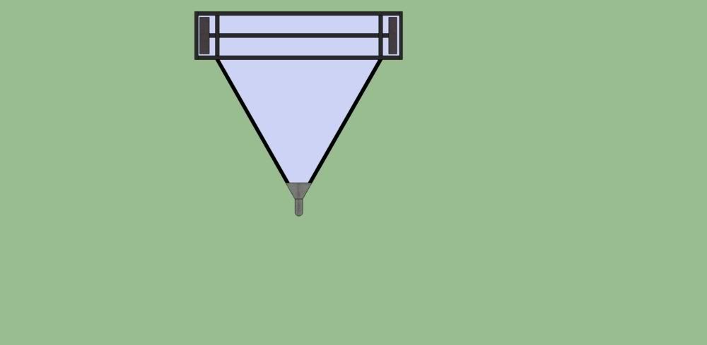

Postby swampjeep » Wed Feb 01, 2012 11:59 am
GPW wrote:snip
Considering what the Old Timers got away with makes me wonder if we need a conventional trailer “frame “ at all ...at least on the smaller Foamies ... :roll: :thinking:
I really think you want some frame to take the abuse of the road, having the axles or springs fastened right to the camper would have the camper taking a lot of abuse when going down the road, every bump and pot hole pounding away with nothing cusioning it but the tires... I do however think you could minimize the frame to only what would be needed for the axles, and out to the hitch, with maybe a couple cross beams, here's a scetch of a 2 axle, although I think you could even get by with one axle.
note: drawing is very out of proportion

Postby GPW » Wed Feb 01, 2012 12:11 pm
SJ, yes, I see what you mean ...
Postby loaderman » Wed Feb 01, 2012 4:24 pm
I was thinking much like Sj
Basically a sub-frame with uni-body design trailer on top of it. Could even use some rubber mounts between the trailer body and the sub-frame.

Postby swampjeep » Wed Feb 01, 2012 9:03 pm
I read your other thread talking about 2 axles, that's actually why I put 2 axles on my drawing. lol
one question on yours, where would your springs be? or are you planning the more expensive torsion axles?

Postby loaderman » Thu Feb 02, 2012 12:06 am
Because I am looking at an 8'-4" or so trailer the wheels will be below the cabin of the trailer. If you are going between the wheels it is easy. do the angle iron triangle thing that is posted elsewhere.
For a double axle just make the boxed area bigger so 2 axles fit in - probably what I need to do.
The springs would be on the cross bar that is parallel to the wheels and just inside the wheels. The ones outside the wheels is where the cabin would bolt to.

Postby linuxmanxxx » Thu Feb 02, 2012 5:07 am
I'd recommend just getting the torsion drop axles from northern tool and then you just adjust them out to the width you want and mount them up. Since they are swing arm style you don't have an axle crossing to determine your width and then as long as you are in DOT guidelines width is not an issue at all for cabin sizing plus the torsion would give a smoother ride and not be near the stress on the structure. They are rated 500 1000 and 2000 and the upper two sizes are in stock not sure if the rating is per axle or as a pair.
http://www.northerntool.com/shop/tools/category_trailers-trailer-parts+trailer-axles+rubber-torsion-axle-suspension-units
Ok the capacity I finally found is for the pair not single.
So a complete setup with hubs axles bearings and even lugnuts is about 230 and for torsion axles at 2000 lbs that is a good price. Just need the wheels and tires to make it all complete.

Postby loaderman » Thu Feb 02, 2012 8:28 am
Steve - Torsion axle are a good idea if your cabin is narrrow enough that you can go inbetween the wheels. For me they are close to double the cost of a regular axle.
