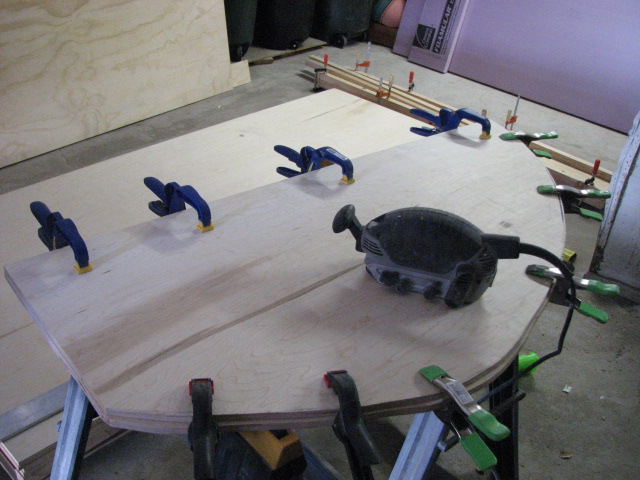

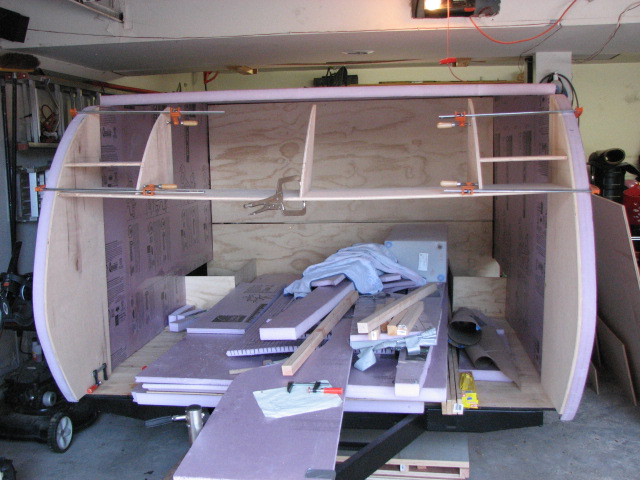

I finally got some work done on the Road Foamie this week. After about a month of no progress, it felt good to spend most of the weekend working on it. I started working on the front bulkhead cabinets. Building cabinets is easy work for me but curving the front of it to fit the curve of the nose is a PITA. Slow work but I got stuff done. Here's some pics...

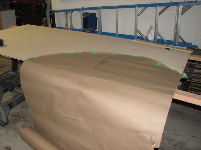

I took the template that I used to cut the side and used the front 24" to cut the sides of the cabinet
I cut the sides out using a jig saw, clamped the two pieces together and sanded down to the outline with my belt sander

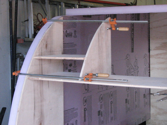

The shelf across the front was cut and then the partitions for the top were cut and you can see them clamped in place here. Eventually they will be fixed in place with glue and pocket screws. The bottom of the front cabinet still needs to be put in place. The sleep platform floor will be about 11" up from the "basement" floor and there will be two more partitions to divide the remaining bottom of the cabinet into 3 sections. The middle will be the dog's bed. There will be the heater and storage on the right side, the electronics and storage on the left
The upper portion of the cabinet will house 6" x 9" speakers and the lower cabinet on one side will hold the receiver/ipod/cd player. The lower cabinet on the other side will probably just be an open shelf for the odds and end stuff that we tend to accumulate while camping.
