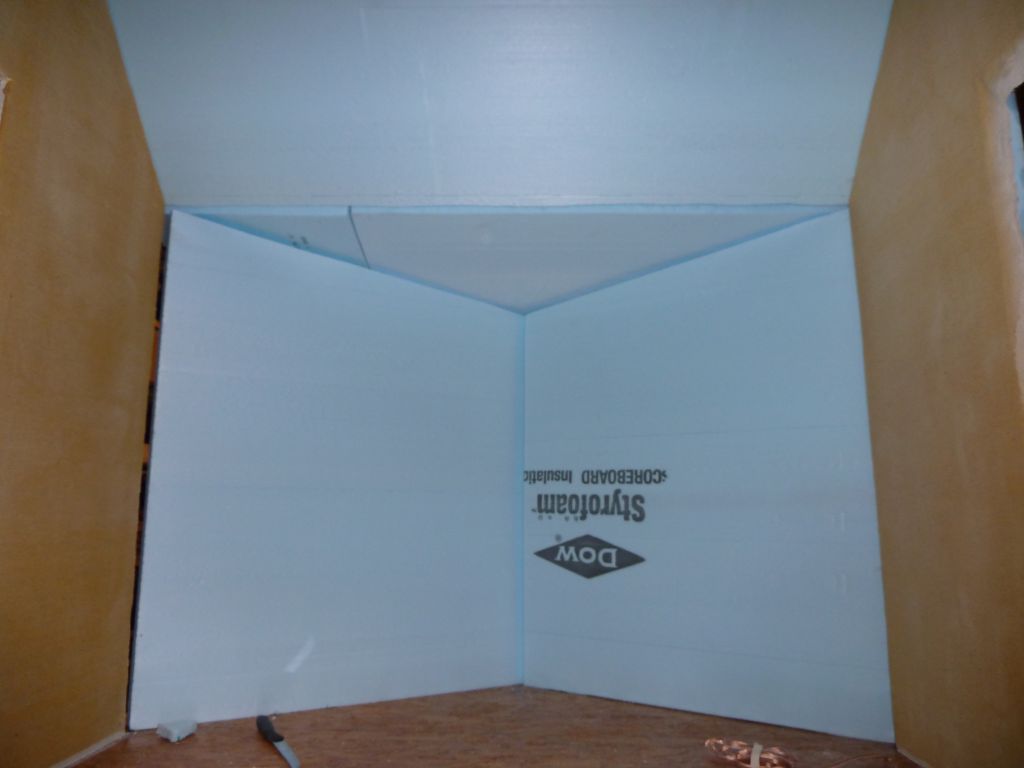

Postby Fred Trout » Tue Jun 16, 2015 4:55 pm
Progress so far today was interrupted by T-storm. :x Will go back out after - too much to do.
Cut the rough panel configuration for the nose - takes me a long time measuring everything many times to make sure I don't screw it up too much. The panel covering the 45 degree roof angle & the two vertical front pieces are pretty much complete to size & placement other than edge fairing. The other lower angel roof segments need to be joined & cut to size once the rest is in place since small adjustments mean big changes to those.
Still need to fit the filler pieces where the angle meets to main walls but I have that all shaped & angles modeled.
nose panels roughed in (outside).jpg (93.49 KiB) Viewed 7189 times
nose panels roughed in (inside).jpg (68.14 KiB) Viewed 7189 times

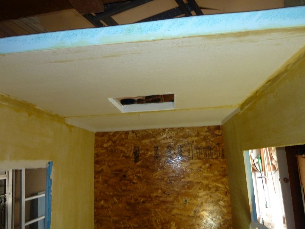

Postby Fred Trout » Wed Jun 17, 2015 3:02 pm
Second roof panel w/ TB II canvassing on inside went upside down and stayed in place. Was able to take my time & go back after the foam panel adjustment & taping down was in place to do the overlap on walls & adjacent panel. Winner - TB II :thumbsup: Did not put TB II on top of canvas to save glue & it did work fine. Great Stuff is really good for gluing foam panels together & the manipulation of GS on a palette until the consistency of peanut butter a great success for minimizing bubble size. H/T to rowerwet !
Looks like Latex paint may not be useful for gluing canvas to roof because it's stickyness timing window is not obvious or because it does not stick well until almost dry. More to come and pix later in this post.
EDIT: no comments on my crummy canvas trim job please :lol: Still getting my technique down - should have it down after I am all done :shock:
Added Pix:
Canvas added on the flat on nearer panel, after installation on further - used staple gun to hold canvas in place while smoothing in
Inside roof canvas 1.jpg (109.04 KiB) Viewed 7125 times
used Gripper here - hopefully it sticks better to metal but it will be held in place & hidden by the fan.
Inside roof canvas fan cutout.jpg (89.74 KiB) Viewed 7125 times

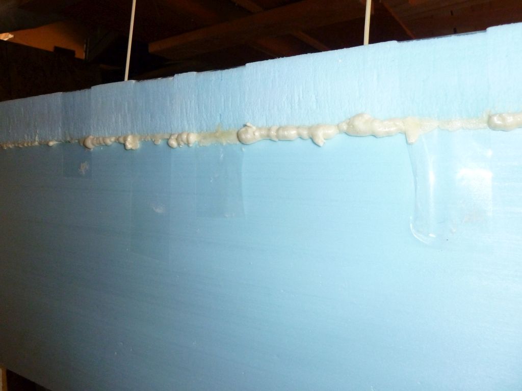

using this technique gives better control of foam coming out all over
Great Stuff massaged to peanut butter makes small bubbles.jpg (85.35 KiB) Viewed 7125 times

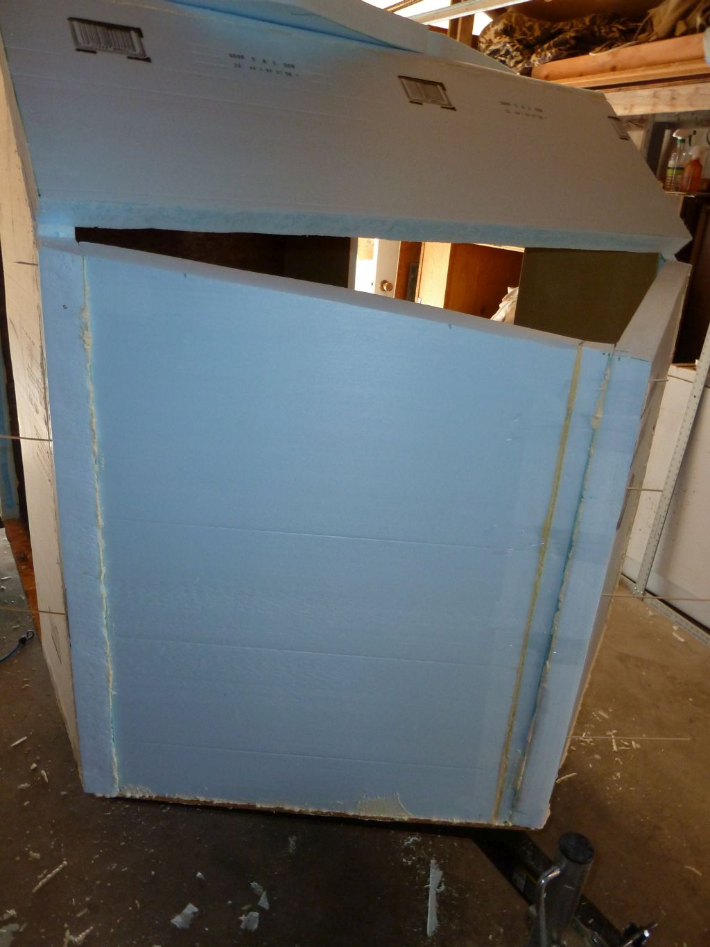

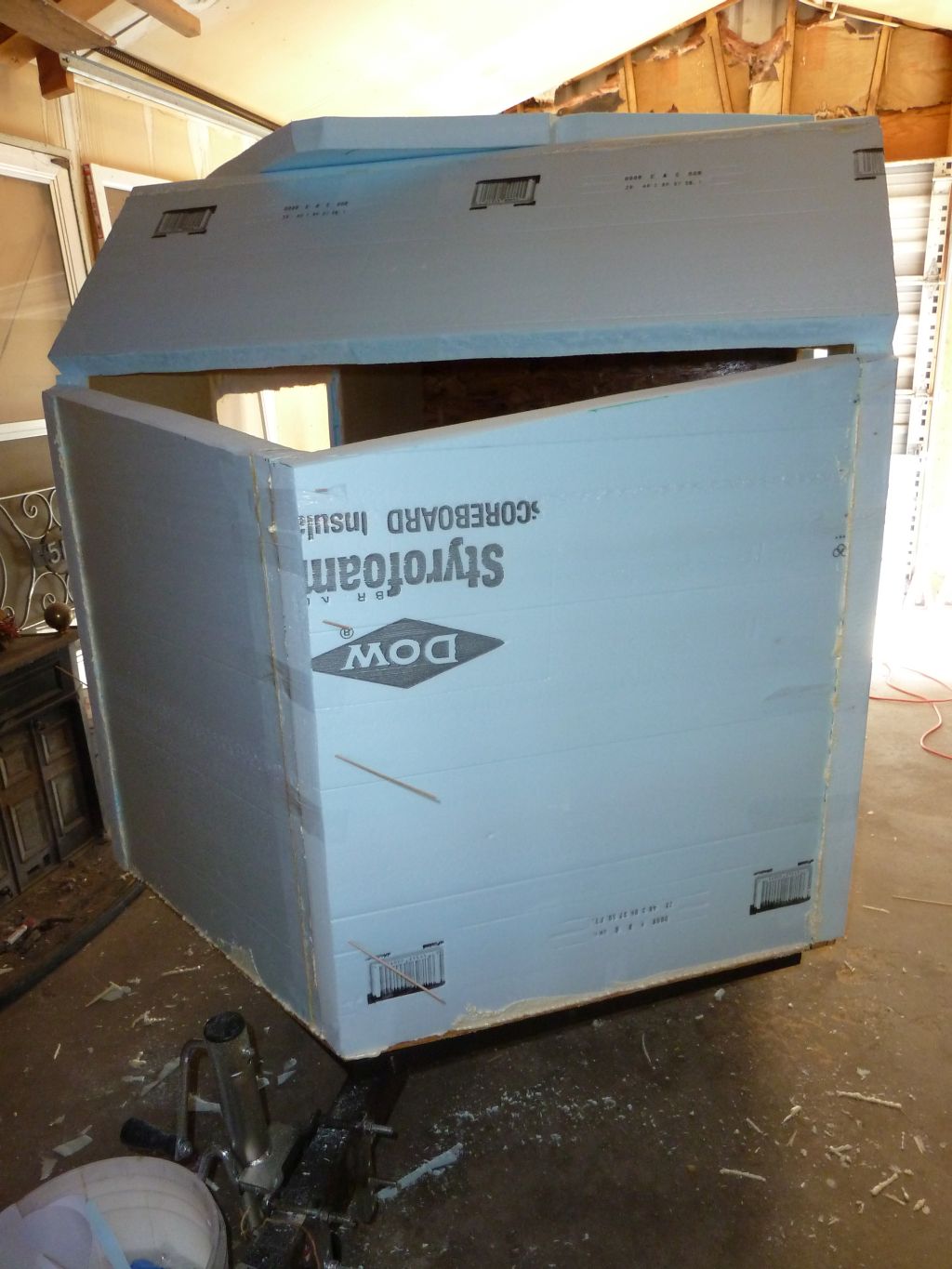

Postby Fred Trout » Mon Jun 22, 2015 7:31 pm
Spent WAYYYY too much time cutting and sanding the front panels to fit. One panel I trimmed a bit off - too long - trimmed a bit off - too long - trimmed a bit off - blam blam too short - now I had to glue in some more width and wait for the GS to dry (see 2nd pix below) . Bah :x
Anyway, got it all together correctly fitted - more or less and used GS to put the two front panels in with dry-wall-screws holding the panels to the floor, bamboo skewers & tape clamping them in place. Looks pretty decent and needs minimal fairing. The low angle roof is ready to be trimmed for final fit and GS glued in place tomorrow.
Pix:
Closing the front 1.jpg (174.38 KiB) Viewed 7077 times
note the extra width added back after too much trimmed off.
Closing the front 2.jpg (147.41 KiB) Viewed 7077 times

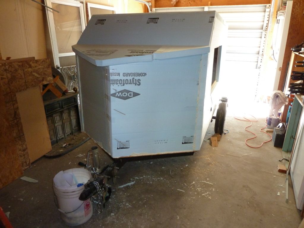

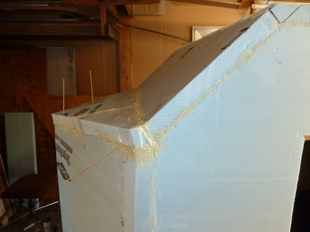

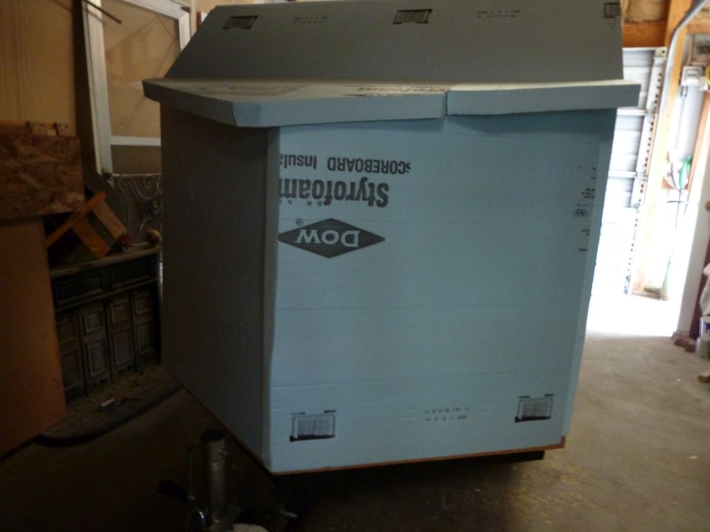

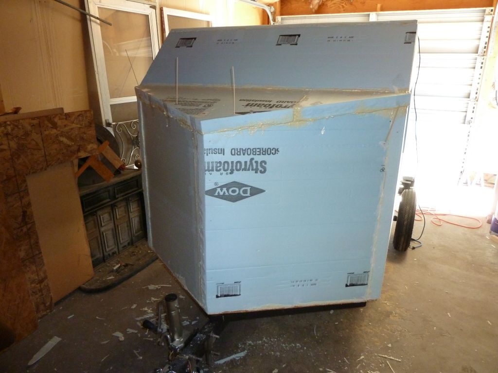

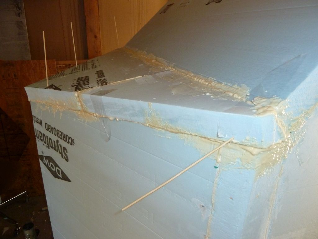

Postby Fred Trout » Tue Jun 23, 2015 7:02 pm
Thanks for the kind words, GPW. Better shots with it installed below.
This was the last wall piece needed to close up the foam-skin. Now onward to fairing, canvassing, painting and doors. As you can see, I applied extra GS to seal all joints as well as possible since this will be the most complicated orientation and the most likely to leak while driving. After I get all rough fairing completed, I have been applying paintable-caulk to all joints since GS is open-cell foam and can absorb water. I know all will be covered by TB II, canvas & paint but I am a belt AND suspenders kinda guy -- Murphy says if it can leak it will.
Last roof piece 1.jpg (101.34 KiB) Viewed 7001 times
Last roof piece 2.jpg (120.41 KiB) Viewed 7001 times
Last roof piece 3.jpg (97.29 KiB) Viewed 7001 times
