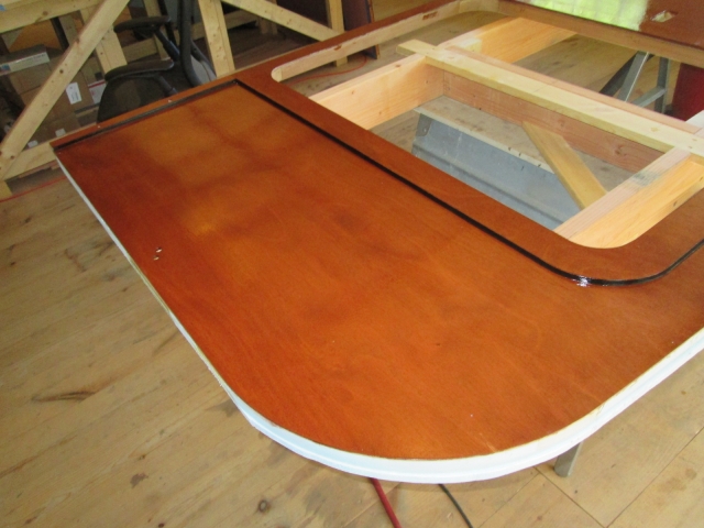

Didn’t get as much done as I would have liked today, but I did have a nice sleep in, and breakfast, so have kicked vacation off just fine.

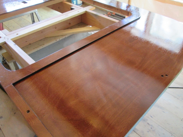

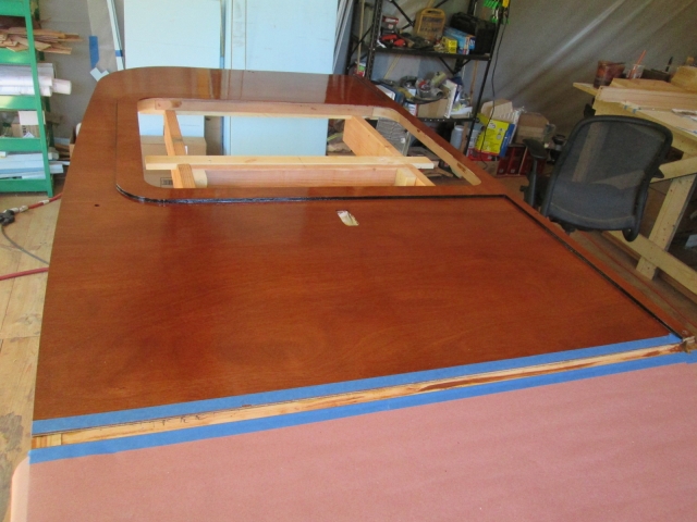

Started by adjusting and trimming the curb side bulkhead dado so that the bulkhead drops right into place now.

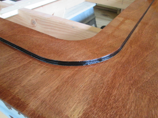

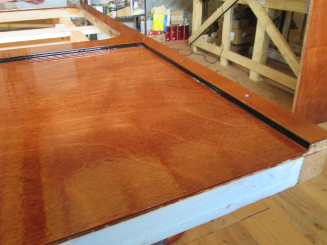

Then I spent a good deal of time masking off and painting the edges of the door seal flange and toe kick board with gloss black Rustoleum oil paint. Scuffed it with a small piece of greenie after masking.
There are a few spots where the brush left streaks where you can see the brown thru the black, but I have a small hobby brush that I can use to touch that up w/o having to mask again. (I wanted to pull the masking while the paint was still soft in order to get a crisp line w/o lifting the edges.)

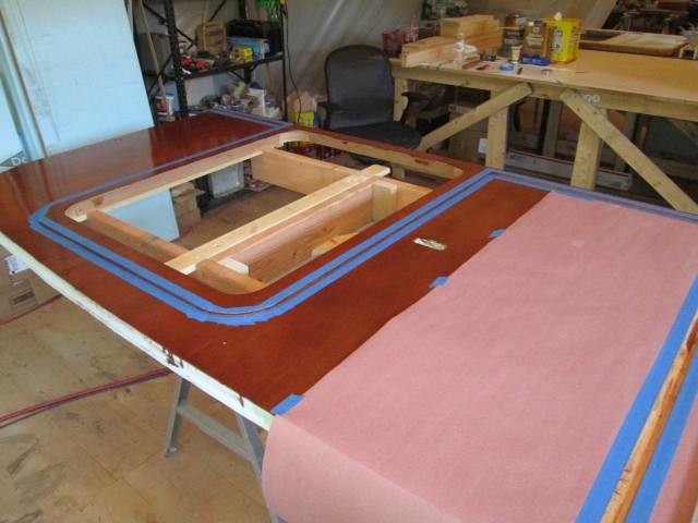

Sunday, Sunday, Sunday… Race fans, hot rodders! It was a great day to be building. Cool morning with midday temp’s in the 70’s, humidity in the 50’s. Got a reasonable start and for the first hour or so I didn’t even turn the fan on. :thumbsup:

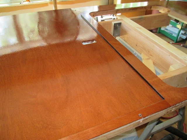

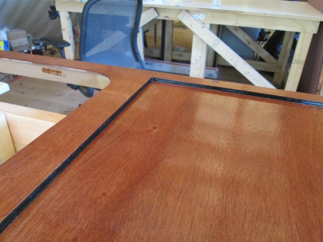

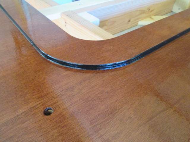

Went back at the curb side wall with the little brush and touched up the black trim paint. Didn’t bother to mask and it was easy to wipe any small over runs from the top side of the flange and tow kick.

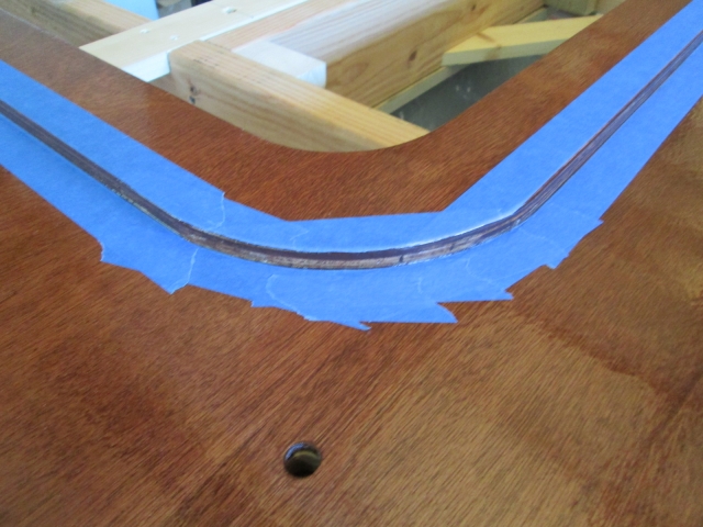

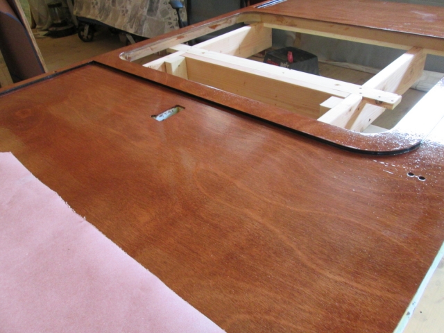

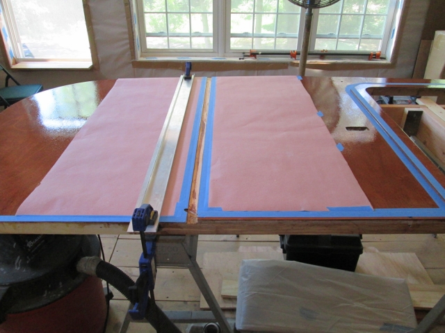

Swapped back to the street side wall, checked the fit of the bulkhead to dado (was a touch tight), masked it for routing, and did the trim edge as well.
After looking at that last pick on the camera I went back and trimmed the little bulb of tape on the top right where it doesn’t quite look fair.
First I routed the dado. On the curb side I had taken a scant 32nd and had to take a second pass, so on this side I just went straight for a 1/16th. Turned out just a little free, but I’d rather have that than have it fight me dropping into place while I’m gluing and screwing and trying to hold square.

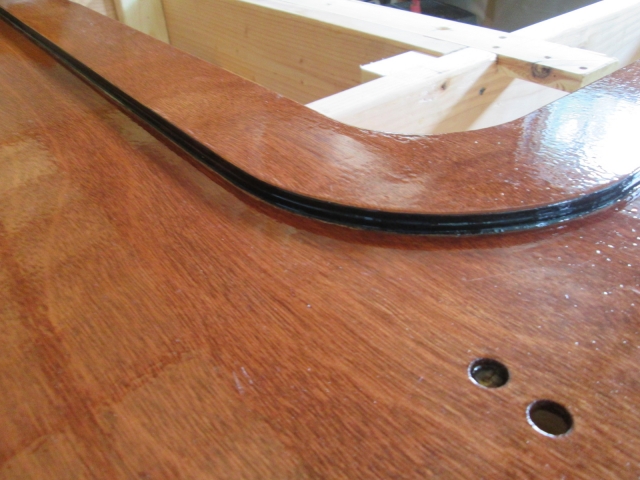

Next I used the small brush and painted the edge of the trim. It took a little longer, but I had better control and was able to coat it out in one go.

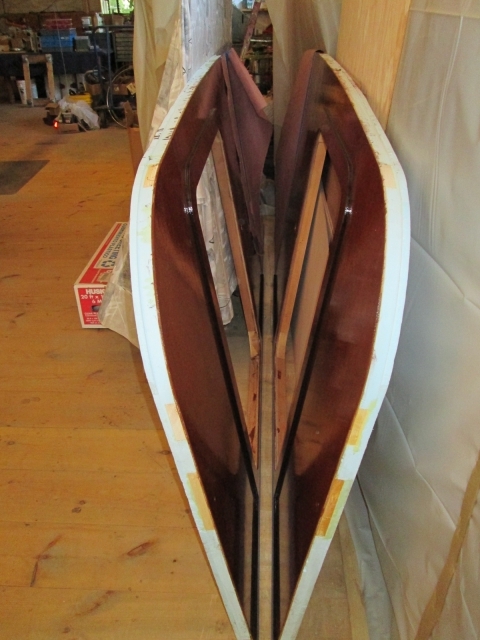

Karl helped me shuffle the walls and floor again. Thought this “Valley of Walls” pic was a bit neat with sort of a mirror effect.

KCStudly wrote:... Thought this “Valley of Walls” pic was a bit neat with sort of a mirror effect.
Love this pic.
