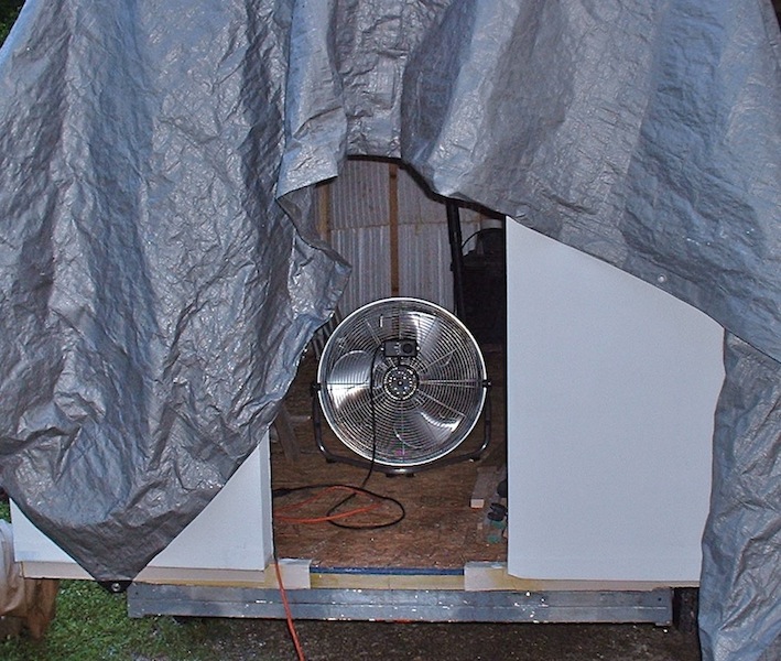

Here’s what we’ve been doing to keep the moisture under control, running the fan inside as much as we can ... not at night or during a rain ... It helps , but we’d rather not have the dampness in the first place... :roll:

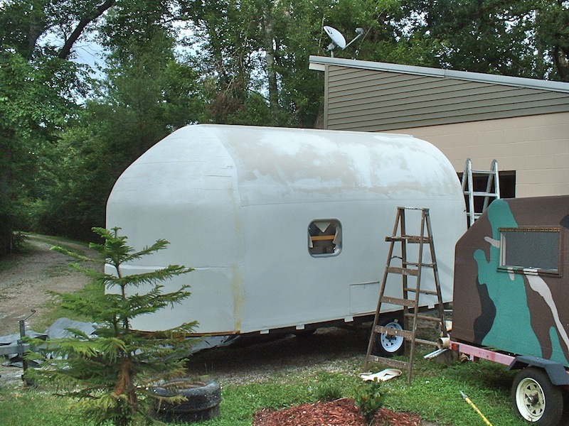

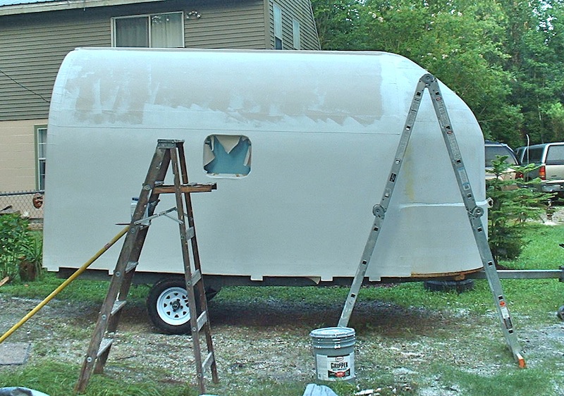

Now then .... despite the warnings of the weather service , we went ahead and added a top panel to the trailer .... using the Gripper ... Seems to work OK .... we’ll see how it dries ... which BTW is pretty quick in this heat ... I did find a few “bubbles” :o that I brushed some Gripper over and rubbed in with my hand (a mess) , that seems to have taken care of those little annoyances... gripper works pretty good so far ....
Tomorrow is supposed to be “mostly sunny “ , so we’ll get a chance to cover the other side top and then start on the nose ...
Note , Mr.Thrifty chose not to go rent scaffolds , and used the shaky ladders instead .... Stupid eh !!! :duh:
Re: FoamStream...
Postby GPW » Tue Jul 16, 2013 6:58 pm
Just checked , the Gripper is dry , or feels so .... everything stuck fast ... no bubbles ... so we covered it up with the tarp and called it a day ... :beer:

Well, it’s not raining ... yet :roll: So I snuck out early and installed that other top panel ... :thumbsup: And actually got it a little straighter than the other one... :oops:
Finding as the Gripper sets up it (naturally) becomes more tacky and we have to go back and smooth the edges for the best adhesion ... just a little watchful rubbing after the fact ... ;)

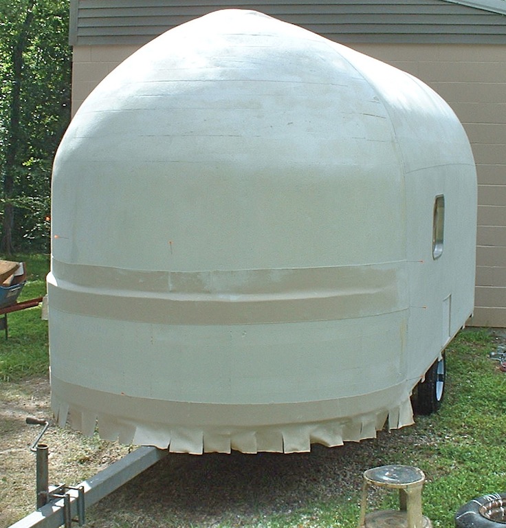

Added the “reinforcing strip “ and the design element transitional strip ... Moving right along ... :D
