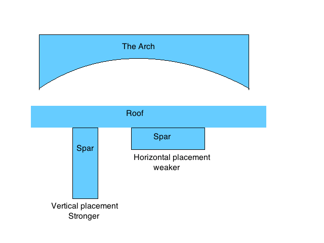

Spars ... That's why I thought of using the foam arch , which spreads the loads out effectively where needed .. a spar , covered and glued in so it's perpendicular to the roof , should be plenty strong .... if you don't plan on standing on it ...

the arches across the front provide small corner shelves, but are actually support for the side to front
GPW is this what you had in mind?
Ratkity wrote:I love the CAD drawings!
I'm glad you showed the arches. It sorta looks like a place to bump the head or have to continually duck around them. I think I still like the straight line of the spars inside.
I wouldn't use foam covered in canvas as flooring. Underneath there would be horrid rock and road debris dings - and inside, it would get dented or eventually totally compress in walking areas (I'm thinking of the standy) because the canvas does have a wee bit of flex to it.
