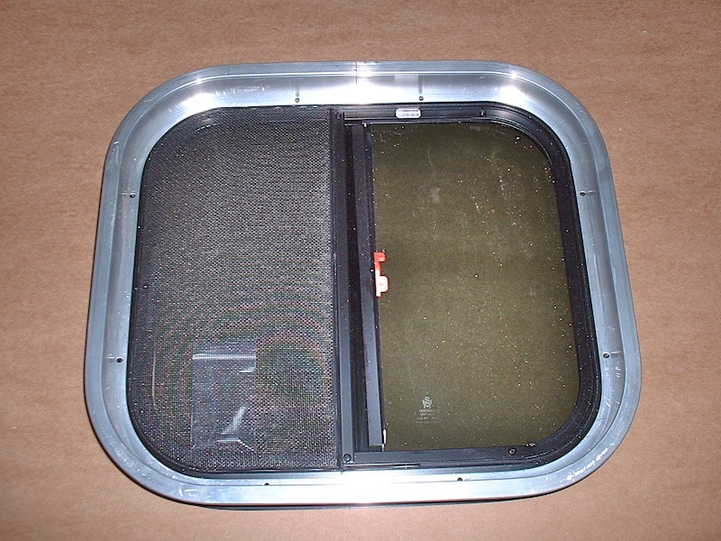

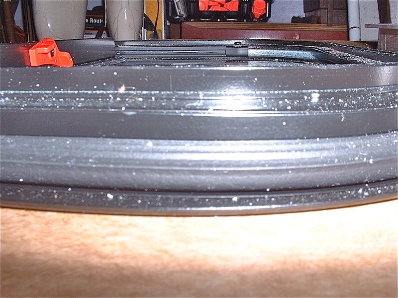

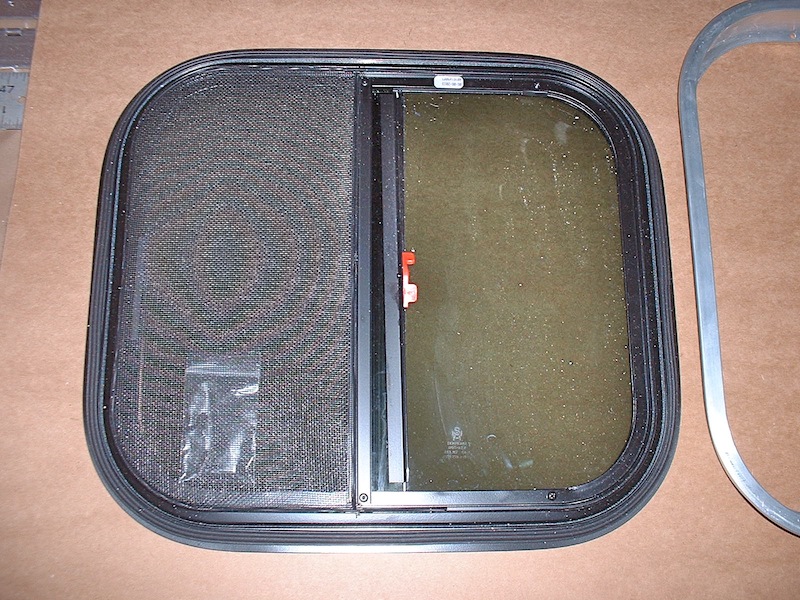

What about pre drilling some tiny pilot holes ? I see we’ll have to use almost exact length screws or punch through the front .. :o Not much working room ... The screws seem to fall into a groove around the edge ... is that right ??? :NC
Some pics of same ... Please forgive the foam dust pollution , try as I may ,it’s still Everywhere!!! :frightened:

If you size the screw so that, when assembled in the wall, the tip just touches the frame +1/4" or so, you'll get plenty of clamping without going through the front. It's the sealant under the flange that actually holds the window in, not the screws. You should have 1/2-3/4" depth on that slot.

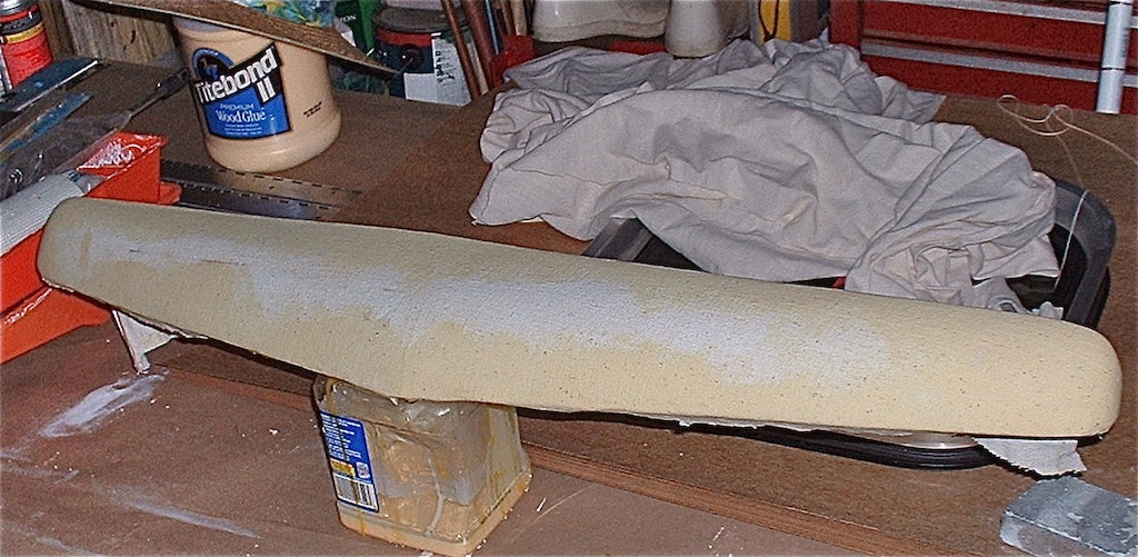

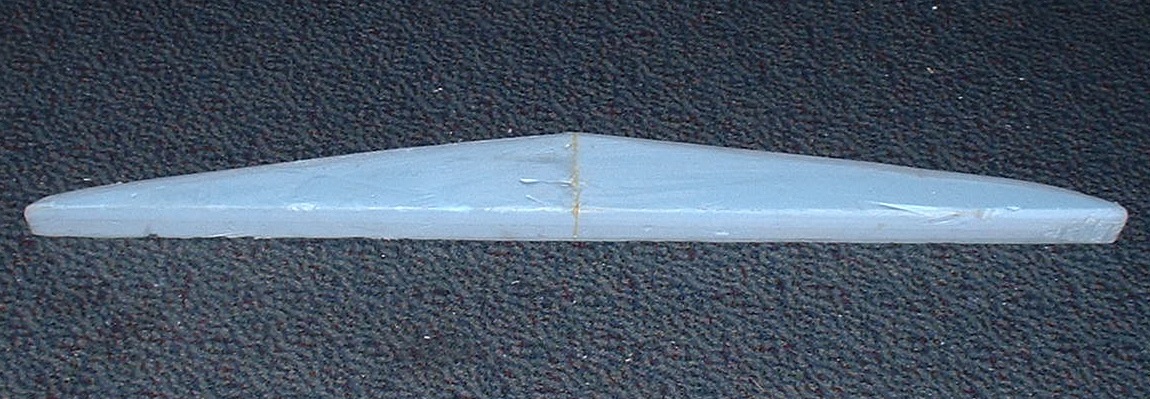

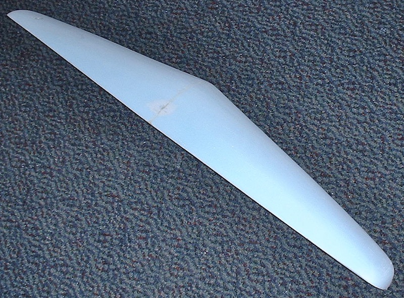

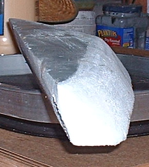

Here’s one we carved for the Foamie’#1 but never used it ... a little touching up with sandpaper and some covering and this would work fine over the back door .. :D The bottom is undercut sloping forward to direct the rain off the door ...

Postby GPW » Sun Jul 21, 2013 7:46 am

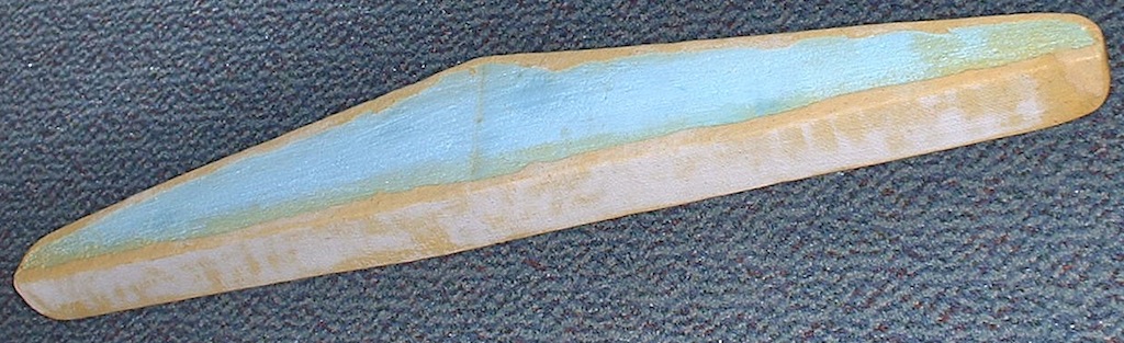

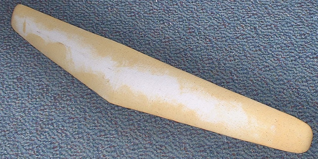

A little sanding and shaping transforms the above ^ to this ... ready to cover ... :D
Found some of that much lighter canvas we used on F#1 ... going to cover it with that (stretches) ... easy !!! And saves a few bucks too ... Thrifty Drip Caps :thumbsup:

Got the Drip Cap covered ... drying now ... and already today it’s threatening Rain ... again ... :rainy:

Postby GPW » Sun Jul 21, 2013 9:01 am
Picture of the glue drying ...

With the help of my little hobby heat gun (400F) was able to get it all covered and dry , front and back ... Ready to glue on , caulk , and Gripper ... :D

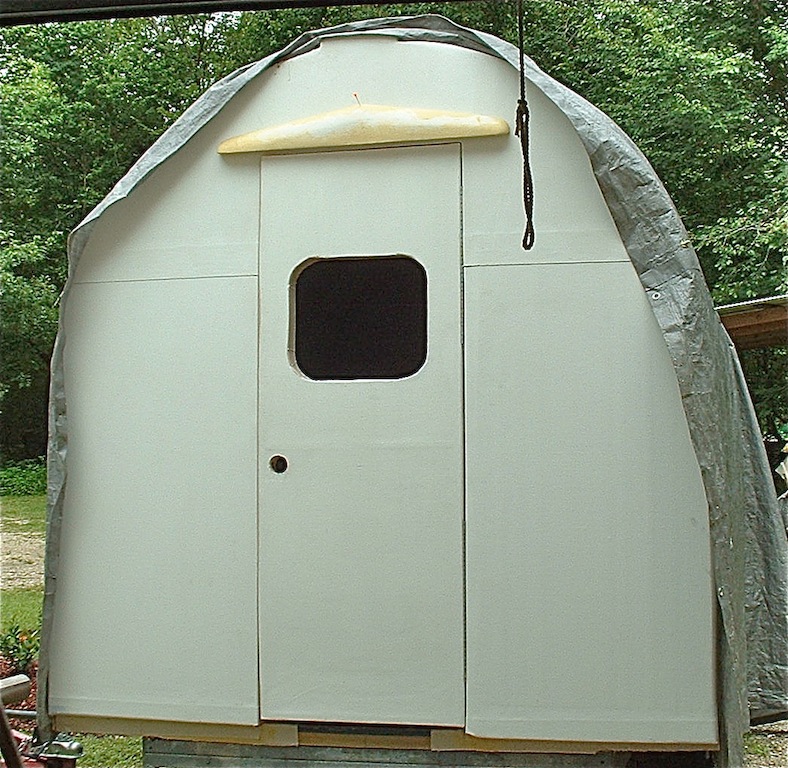

Cut the 36” Al hinge in half , making two 18” hinges .... then hung the door ... and it fits as expected ... :P Tried the drip cap over the door (pinned) ... that fits too ... :D
