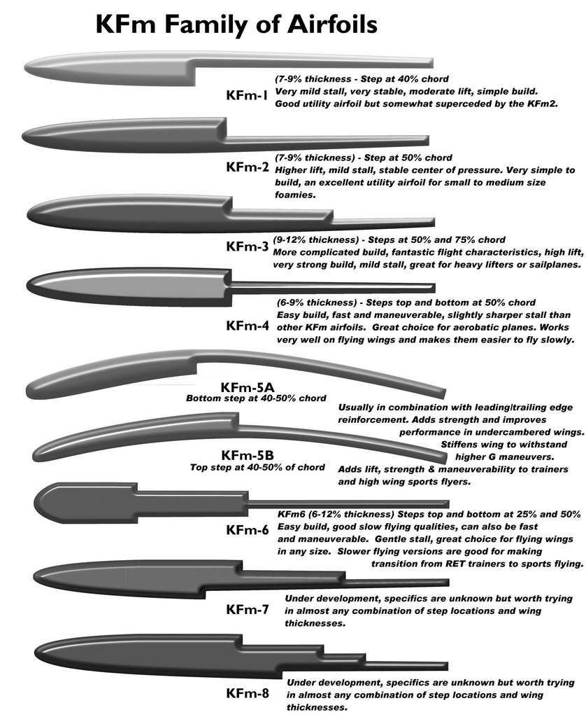

just thinking ... It should be all too obvious now that with the common TD shape , the flow separates too early off the extreme back taper, similar to a flat bottomed airfoil at higher angles of attack . ... so may not be the most efficient shape ..as previously mentioned,that could be improved with a Kline -Fogleman “step” which creates a circulating bubble that allows the air to smoothly flow over it ... worth investigating ... :thinking:
Re: Foamie aerodynamics.
Postby GPW » Tue Dec 18, 2012 8:33 am
Here’s a sampling of the popular drag reducing KF airfoils ... possibly adapted to trailer construction ... ??? crumbs for thought ...

GPW wrote:.....with the common TD shape , the flow separates too early off the extreme back taper, similar to a flat bottomed airfoil at higher angles of attack ....
Yes, that's right, all that curving down to the bumper is just 40s aero styling and that was no more scientific than any other generations' styling.
My general rule of thumb is that 15 degrees is as much of a slope as you can expect airflow to stick to and even that had better have a really smooth curve leading to it.
Most teardrops add a hurricane hinge at the top of the hatch which is a perfect flow separator - there is no way anything behind that hinge is important since the airflow won't be touching it.
That's what is so often ignored in favour of aesthetics. Of course, the actual number is dependent on instantaneous airspeed, but there is always that point where the laminar flow lifts off the camber - now you've shot yourself in the foot and are actually creating induced drag rather than reducing it.
Re KF foils - I thought the main problem with them was specifically that they didn't scale up to full size models ?
Great for models but not for large foils (like a TD)....especially given what the interior would be like to maintain the outer shape. Same reason you don't see large shapes dimpled like a golf ball.
