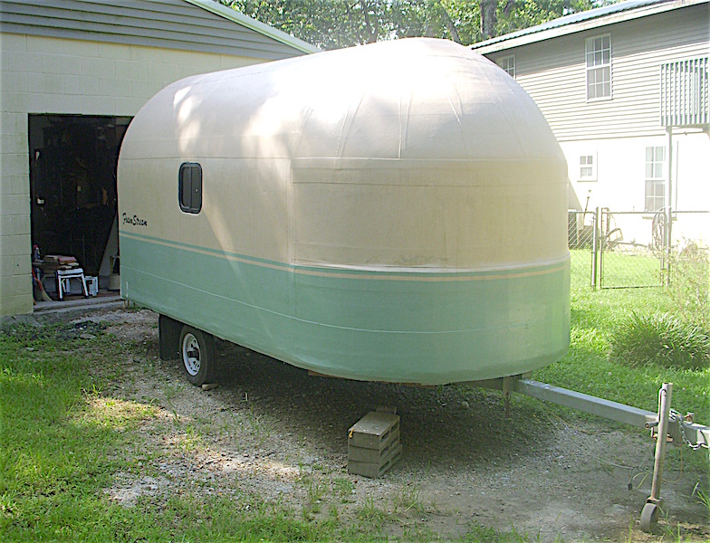

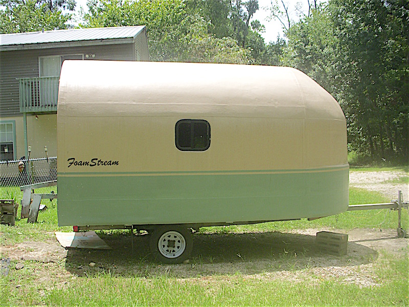

Paint not even dry yet but looking better … First coat … moving right along … Have to work real early , or real late to avoid the hellish heat … 95F today Heat Index , a Million :sweaty:
I do like the new “Cleaner” look of the FS . :D

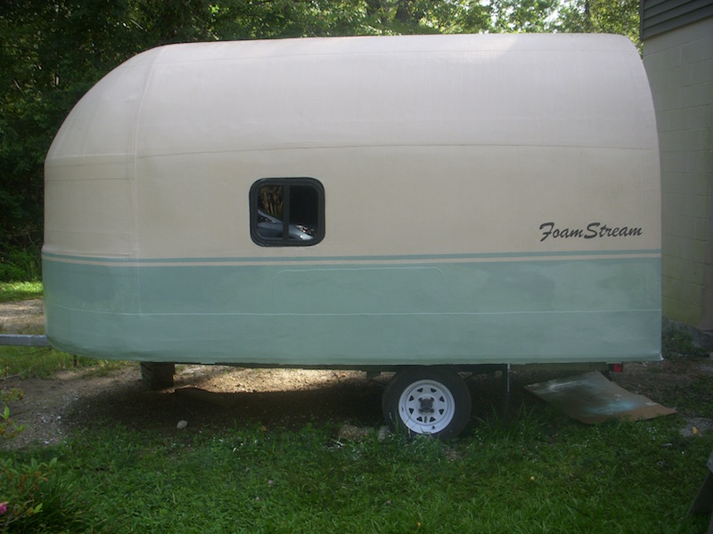

Postby GPW » Tue Aug 14, 2018 1:02 pm

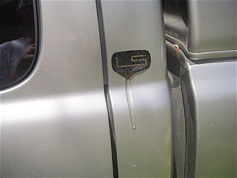

You Think it’s HOT ??? My truck emblem is melting .. :frightened:
Just a couple pics of the dry first coat … The Wife was very Happy !!! :P Second coat this evening … No rain yet …

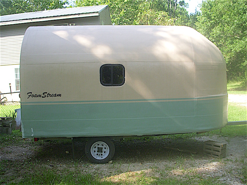

With no rain yesterday we got to put the second coat of green paint on the trailer …. all except the rear which got spray foamed in some more to fill the smaller cracks and spaces still visible … This morning we’ll trim that with a serrated knife and apply the canvas over that … which should pretty much finish up the outside repairs … :D
Ps. since the back only needed a little foam , I didn’t want to waste the rest of the can , so we went up in the nose and filled in more kerfing slots with the extra foam … adding more strength and a little more insulation too … It’s pretty well sealed up all over now …
And I put out some Ant traps too … ;) :thumbsup:

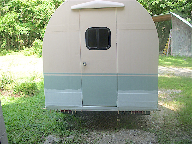

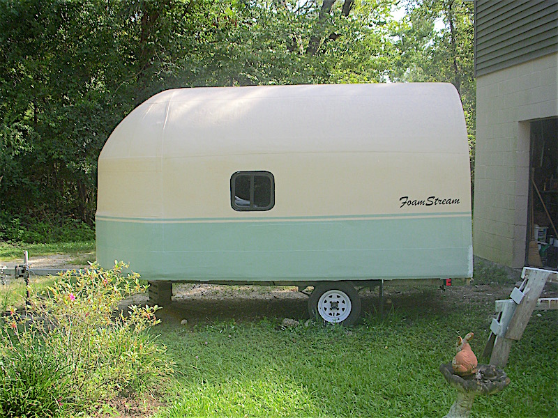

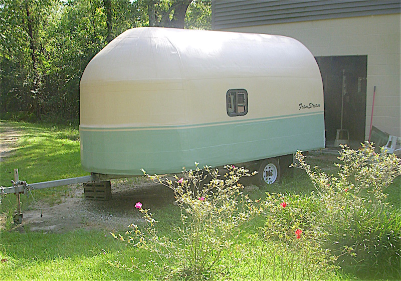

And for those who haven’t gotten enough pictures yet , here is a couple shots of the back canvas in green prime and finished paint all around the rest… We installed the front nose cards and swept up , ejected a little green frog intending on homesteading… Getting close to done now … There’s going to be a Party at the finish … :beer:

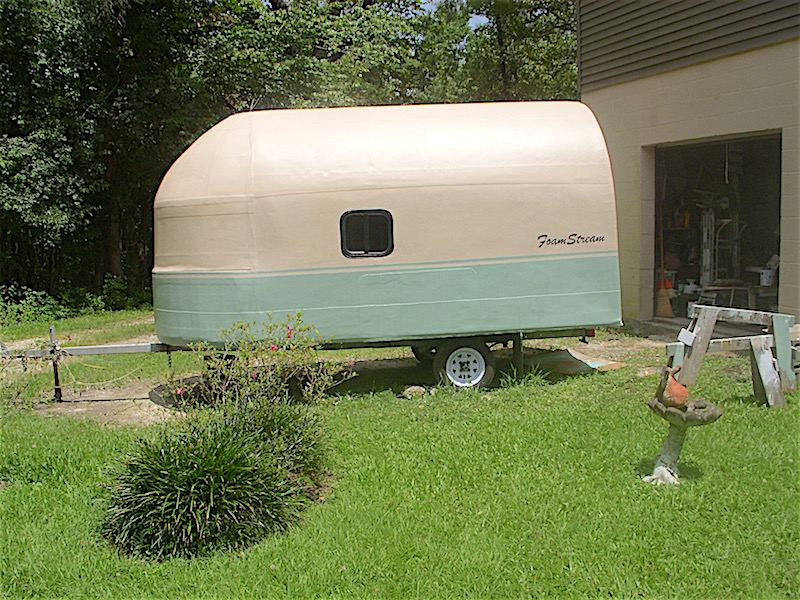

Postby GPW » Wed Aug 15, 2018 9:47 am
and the rest … probably the last of the outside for now ... :D
Re: FoamStream , the restoration … a lesson learned .
Postby GPW » Wed Aug 15, 2018 9:56 am
Notice that from baking in the HOT summer Sun , all the roof dents are Gone … :o Gotta' Love Foam … 8) FoamStream 5 years old this month ( Aug 2013 ) , living outside … Best one yet and now with the new renovations it will better last a long time now ... :D

Painted the back … and we’re DONE !!!! :o :shock: :D 8) :beer: :P
Really , we’re finished !!! :thumbsup: The outside … now I still need to do a little caulking inside , and find a Rug …
This wasn’t so bad … !!!
