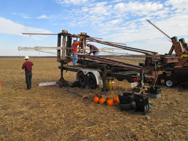

Mr. B on Wheatley Farm, Bridgeville, DE
The orange pumpkins in this pic were just in case we couldn’t find better ones on the field (most teams have extras of the preferred breeds that they are willing to share).

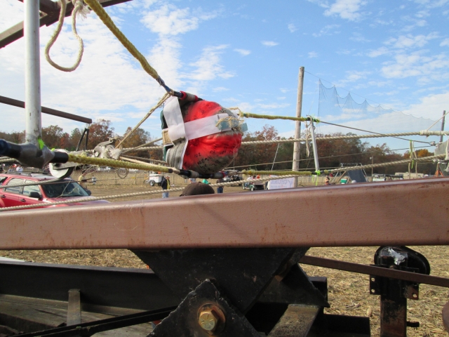

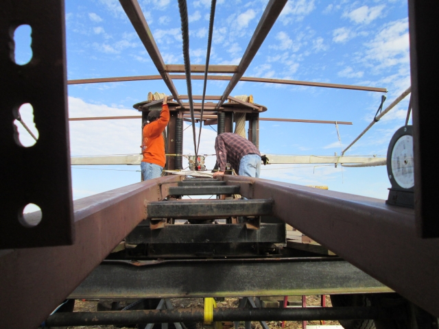

Pumpkin’s eye view from battery position. Eric and Amy are fitting the pumpkin to the pouch. The folded up lawn chair is just there as a safety net to catch the pumpkin if it should fall out… once the pumpkin has been officially weighed and painted the day’s color by the official, it is the one and only shot pumpkin for that day.

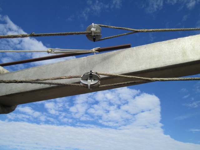

The rope couplers that I made last year have worked well.

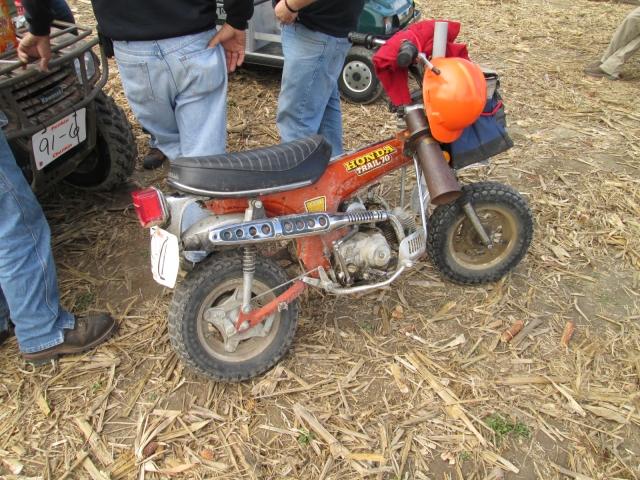

The field is really big and it is a long way from one end of the firing line to the other, plus they only allow one support vehicle per pit, so there are a lot of ATV’s, UTV’s, golf carts, and mini bikes buzzing around. Walking the field had me wishing for a mini bike (this shot is for Kirk/CampmasterK).

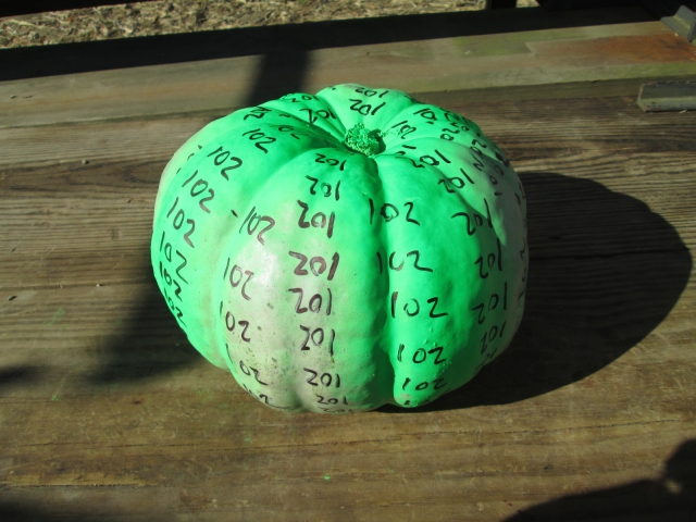

Green pumpkin painted Day-Glo green and marked liberally with our pit number to help the spotters find it (or the broken pieces).

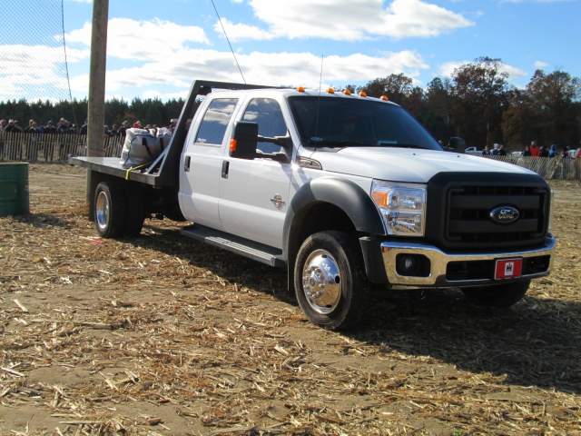

Forrest’s F550 chassis crew cab with fabricated stake body made towing Mr. B over 700 round trip miles a complete breeze.

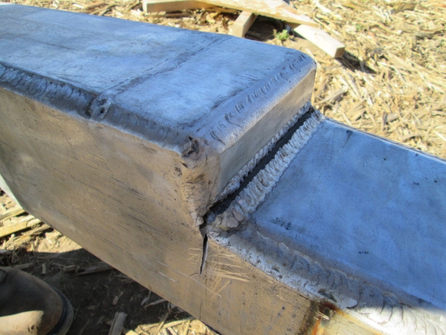

Just before stuffing the arms into the bundles we noticed some cracks in welds between the hilt and some spacer pieces that were added back when we fixed the arms from the first time they broke. The cracks were on the compression side during pull back and did not extend into the doubler plates that had been scabbed on previously, so we decided they would get us thru the weekend, maybe. Despite careful adjustment to our arresting rope system, on the 3rd and last shot we switched from the lower powered compounded shots to the standard bow full power shots and ended up breaking an arm.
Just more incentive to build the new machine for next year.
