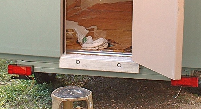

Oops !!! went to add the threshold and found out we didn’t have enough “hold" for the thresh ... :o Had to add another piece of wood so it would all work , and being a Step, we glued it with Liquid nails , and screwed in two giant lag bolts ... then grippered' it ... Now it all fits ... thankfully !!!
Re: FoamStream...
Postby GPW » Sun Jul 28, 2013 6:40 pm
Used the last of the tube of 3M 5200 to seal the threshold ... The one tube went pretty far ... 3 windows and a threshold... still have a whole unopened tube left ... :o Not going to post a pic of the threshold , everybody knows what that looks like ... :D

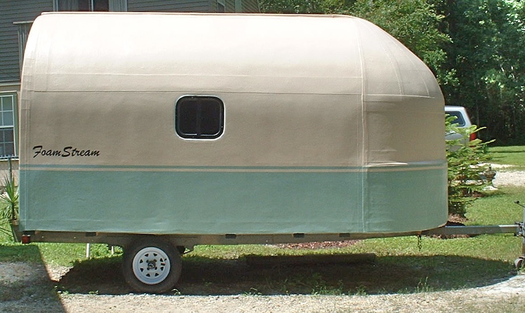

Postby GPW » Sun Jul 28, 2013 8:31 pm
Working on the Logo ...Printed out the tiled version we made earlier on 3 sheets of index card stock , then punched a LOT of holes around the letters ... Tedious !!! :o 24” long ..

Postby GPW » Mon Jul 29, 2013 10:31 am
A little hand painted “graphic distraction" goes a loooong way ... :D

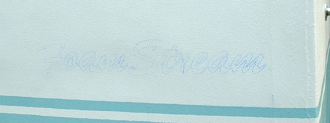

For those that would like to do a little Lettering on their trailer .... this is what it looks like after you pounce the stencil with the chalk bag .... then it’s just fill in the dots ... :thumbsup:

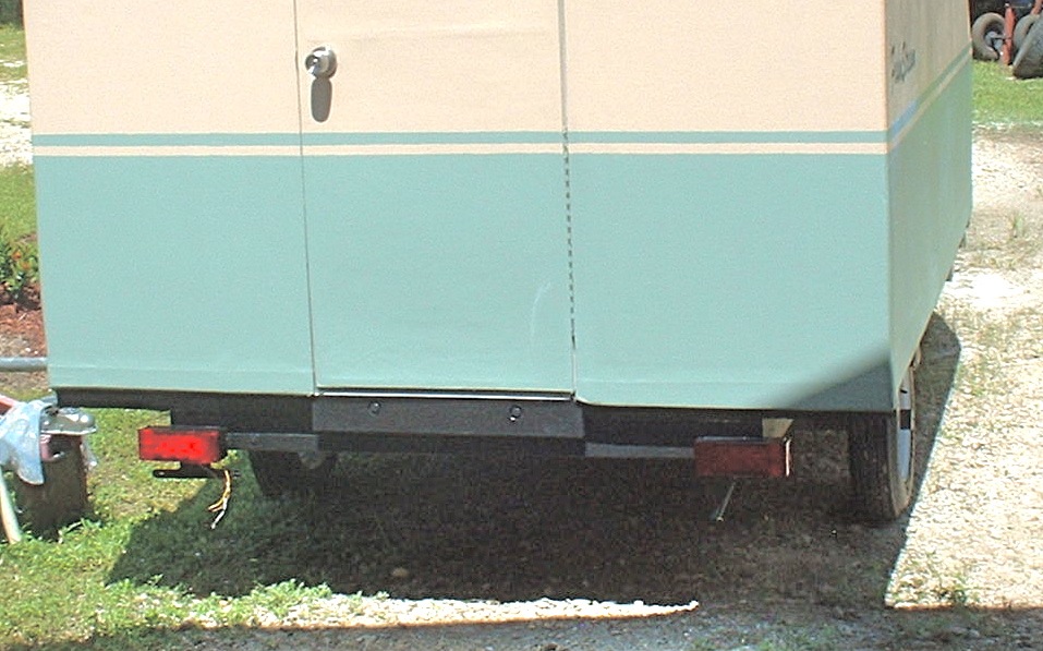

Postby GPW » Mon Jul 29, 2013 11:43 am

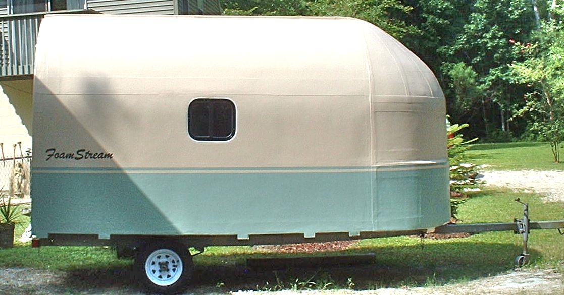

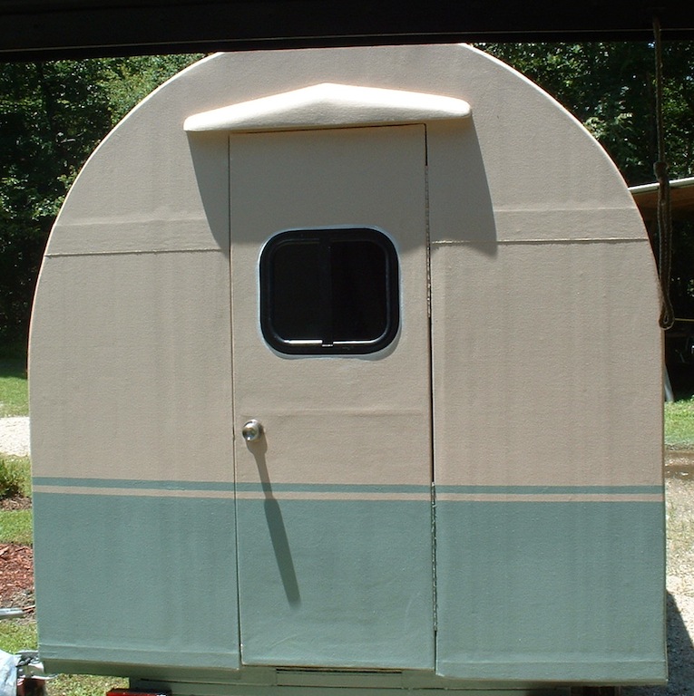

While we had the Black paint out ... decided to black out the cross member ends (too distracting ), yet still a good place to hang a “skirt” or reflectors, etc.
Painted the back of the trailer too ...looked better than the Green (opinion) ... :thinking:
Re: FoamStream...
Postby KCStudly » Mon Jul 29, 2013 11:50 am
Amazing how much better it looks with just that little paint trick!
Re: FoamStream...
Postby GPW » Mon Jul 29, 2013 11:53 am
As we learned long ago ... paint covers up many sins ... :o :roll: :lol: :lol: :lol:
