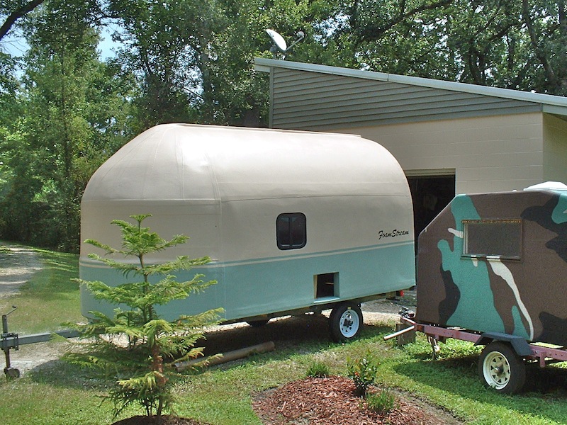

Second coat of the Green is on ! All the little touch ups ... Done !!! :dancing: :beer: Only painting left is the Black nasty stuff on the bottom , a chore we dread , just cause’ it’s so Messy ... :frightened: ... onward to the inside ...

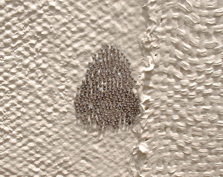

Living in the woods , there’s something already colonizing the FS ... what looked like a smudge turned out to be a gazillion tiny spheres... likely eggs of some sort .. No idea what will emerge ... :NC
Ps.. the Mudflaps just arrived ... 8)

Curious !!! A closer look .... anybody know what these are? Hope they don’t eat foam ... :frightened:

GPW wrote:Curious !!! A closer look .... anybody know what these are? Hope they don’t eat foam ... :frightened:
Butterfly eggs..or moth eggs. Something in the colour must be attracting them to lay on the trailer. ;)

3N, We do have a serious amount of butterflies around this year ... kinda’ Nice really !!! So we’ll let them stay ... 8) :D

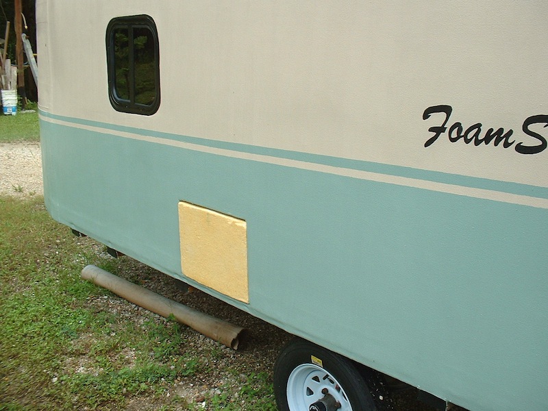

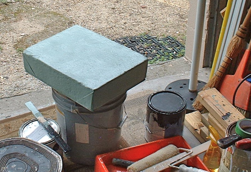

Postby GPW » Tue Jul 30, 2013 5:49 pm
Oops !!! Forgot about the AC hole “plug” :o ... so we took the foam piece that came out of it and covered it with the F#1 canvas with thinned TB2 using the art canvas fold to fully enclose the foam . Then made a plywood back for it , coincidentally from the cutout for the AC wall mount (nothing goes to waste eh ? ) Clamped it with the advanced Newton Clamp ... drying now ...
Luna moth eggs?

Luna Moth... just had to look that up .... Nice !!! We’ll enjoy some of those ... 8) :D

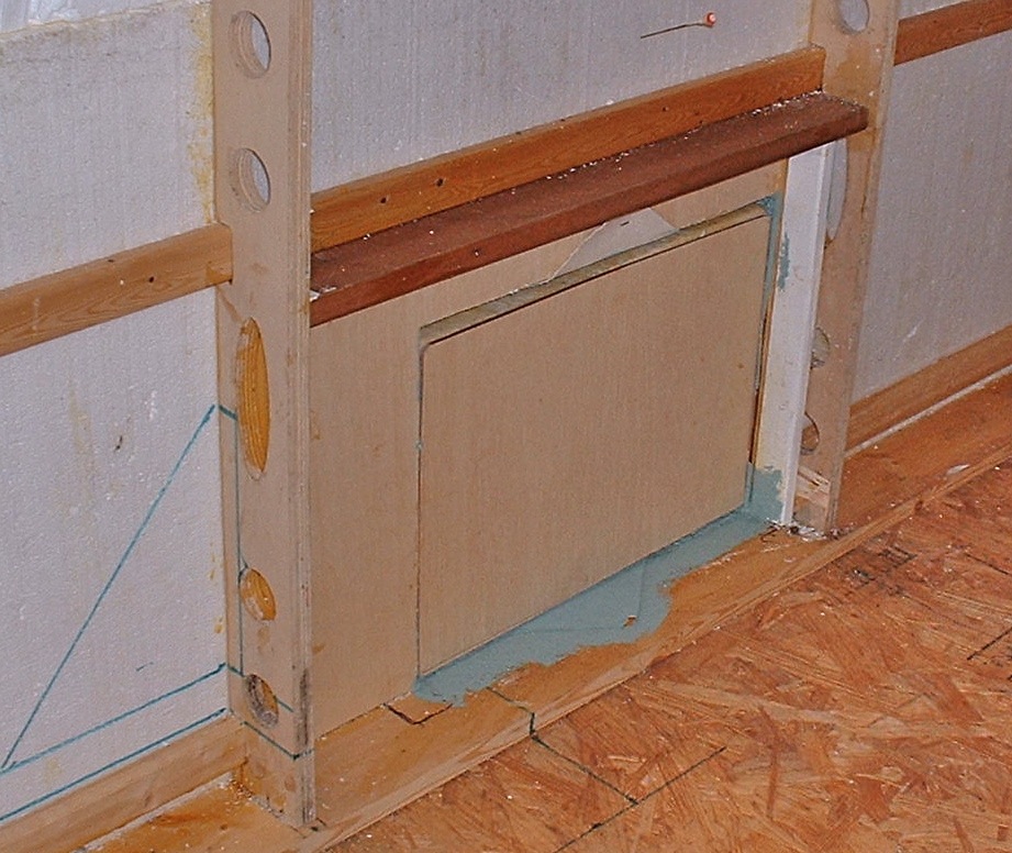

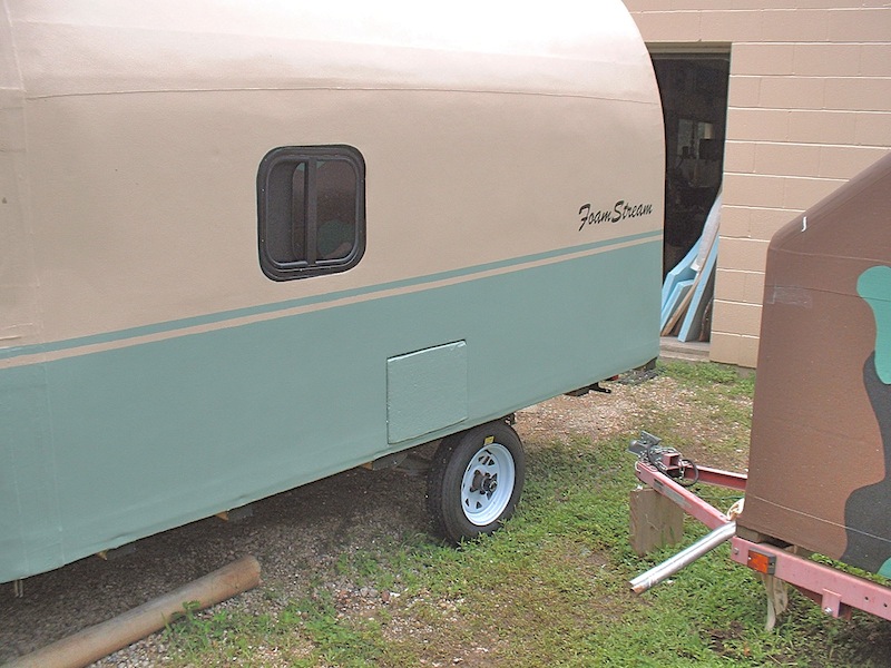

Postby GPW » Wed Jul 31, 2013 8:29 am
Here’s the AC opening plug ... inside and out ... naturally weatherstripping foam will be stuffed in the top to seal it ... and here it is painted ... drying now ... we’ll use some little clips (like the temporary door catch) to keep it in place ...
Ps. that window looks pretty straight now ... :roll: we’ll never tell ... :oops:

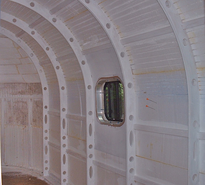

Postby GPW » Wed Jul 31, 2013 12:56 pm
Just finished putting the Gripper all over the framework inside ... I did Gripper over the chipboard and that worked just fine ... no lifting or buckling ... everything nice and smooth ... :thumbsup: But those little foam bits are driving me CRAZY !!! :? They just get into Everything , no matter how many times we’ve Hoovered’ the inside ... :twisted:
We’ll have to do a little touch up sanding and scraping to get the annoying little bits out of the primer (grrrr!!!) ... and , oh yes, lightening holes are really cool , but a real BEAR to paint ... :frightened:

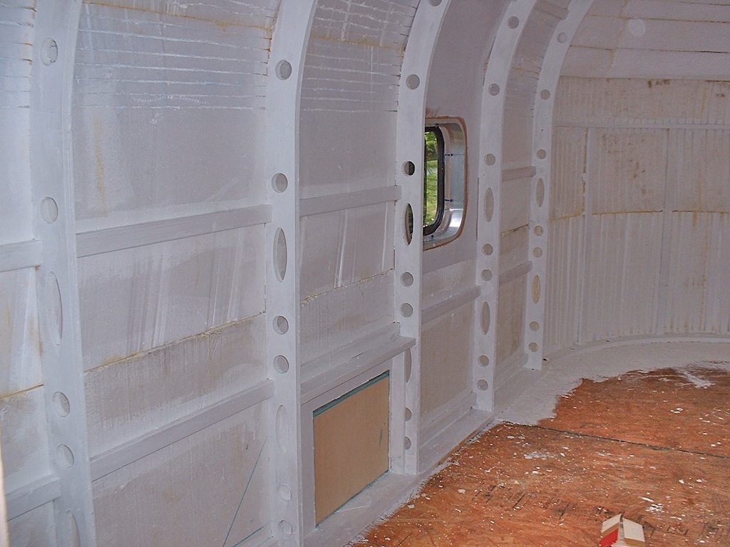

Postby GPW » Wed Jul 31, 2013 4:43 pm
Latest pics ... the AC plug in the hole , and some inside shots ... You can see how nicely the Gripper worked over the chipboard around the windows ... :D
