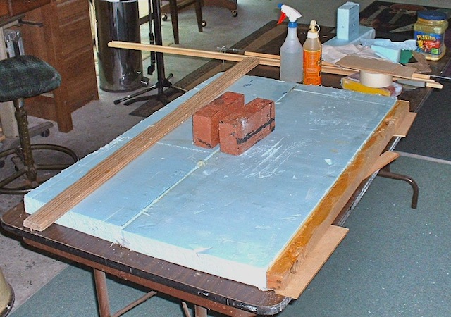

Got my rough door assembly glued up , the 2 panels (didn't have one piece big enough ) and the door hinge support ... once this dries (foams ) we can cut it to fit ... Image

Postby GPW » Tue May 17, 2011 11:51 am
The doors do seem to be the more difficult part ... :o I've given more thought to that one door , than I have the rest of the trailer .. still comes down to cut and fit ... :thinking:

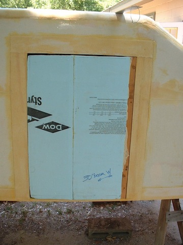

Postby GPW » Tue May 17, 2011 1:56 pm
Got my door to fit ... marked the lines for the outer wood framing surrounding the foam ... Now to cut and fit/glue that accurately ... :roll:
DJ, I'll be running the interior reinforcing strips once we're done on the outside ... 8" wide with a centerline ... 4" overlap in each direction ...
Postby Ratkity » Tue May 17, 2011 2:18 pm
GPW wrote:Got my door to fit ... marked the lines for the outer wood framing surrounding the foam ... Now to cut and fit/glue that accurately ... :roll:
Very nice fit! I'll be interested how you do your corners for the door. With the solar panel cover, I just allowed extra room because of cloth folding.
I'm thinking if we had just covered the front and back of Eagle's doors and then put a reinforcing strip on the edges, that would have eliminated a lot of bulk.
