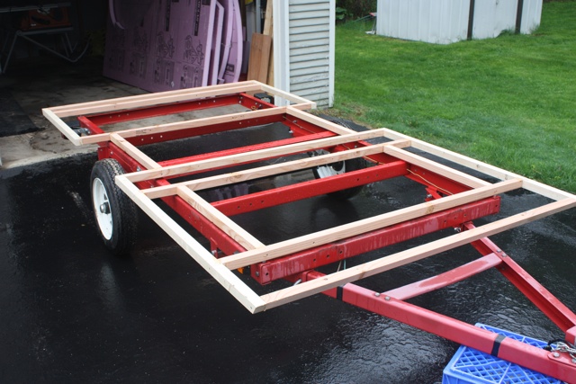

I got the sub-floor built. I have 2 more cross members (you can see them in the back of the photo. They go where the plywood joints are, to give me something to screw into, and keep the water out!
and dry fitted to make sure I didn't mess up the numbers... Yes, I haven't moved the 2nd cross member yet!

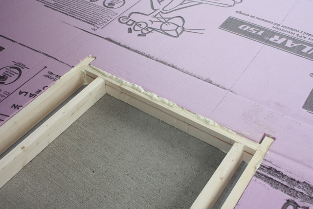

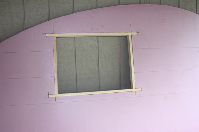

Then I experimented with a window frame. My first attempt: I built the wooden frame with glue and screws. Then I dropped it in the hole. It's not bad, but it's not especially snug.

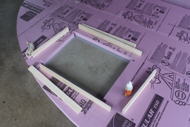

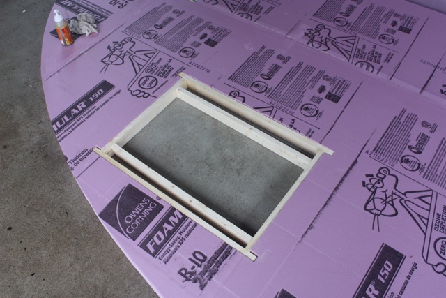

So for the second window I decided I would glue each piece in individually. First the two horizontal pieces. Then I cut the two vertical pieces so that they were tight, and pressed the horizontal pieces against the foam.
Then I cut two more horizontal pieces which would press the vertical pieces tight against the foam. (These would later be removed and thrown away.)BTW, did you notice the duct tape on the opposite side?That'll hopefully keep the glue from ozing out the back side.
As you can see, this joint is much tighter!!!

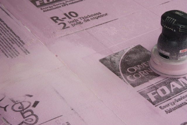

Meanwhile, I discovered that a random orbital sander roughs up the surface of the foam nicely in preparation for skinning with canvas and T2.
Postby eaglesdare » Sat May 14, 2011 6:43 pm
hmm, is there really a need to rough that stuff up? i know the kind gpw had was a glossy skin, but the stuff you are i am using is not.
i did not rough my surface up. so do you think this is necessary? is there an added benefit to it?
Louella
May the foam be with you.
eaglesdare
Posts: 3168
Postby mikeschn » Sat May 14, 2011 6:46 pm
eaglesdare wrote:hmm, is there really a need to rough that stuff up? i know the kind gpw had was a glossy skin, but the stuff you are i am using is not.
I can test it both ways!
