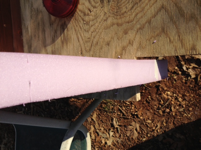

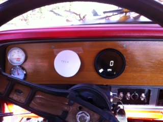

Postby Papi » Sun Nov 20, 2011 5:24 am
I've been busy lately, but not much progress on the camper. I installed gauges on my D100 (since it didn't have any) and made some wood to mount it to. The truck also didn't have a wiring harness, but it was free, and had only 29K on it, so it was worth it:

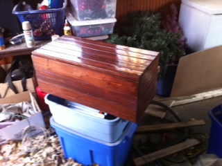

I also worked on the wheel wells, and added 2" to each one for tire clearance. They're stacked on top of each other here:

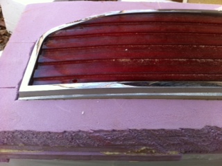

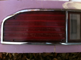

Just goofing around with the tail lights, trying to figure out how to mount them:
I like them a little recessed better:

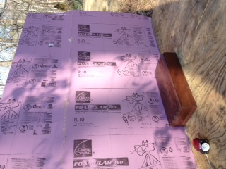

Postby Papi » Thu Dec 08, 2011 3:30 pm
Not much progress to date, with all the bad weather in my outdoor garage, family piling in, and whatnot. But it was nice to pull the tarp off this afternoon and saw some "keys" into the floor. Hard to describe what I mean, so I'll steal someone else's pic to show you.
Mine are not quite as thick, being that they are the actual plywood floor, but it will all get reinforced with cabinets, etc. I hope Santa brings me some foam! :worship:

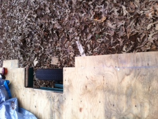

Postby Papi » Tue Jan 31, 2012 12:13 pm
Not sure why my pics turn sideways when I post them, but anyway you get the idea.
Today was the proof-of-concept fitting of one wall. This is not the final profile shape, that is still being noodled out. I am going for a somewhat Scotty look, sort of. I think. Nothing has been approved by the project manager, a.k.a. the wife.
And here you see how the wall is mounted to the floor. The cabinets and wheel arches will help support the walls even more:
And just another view:

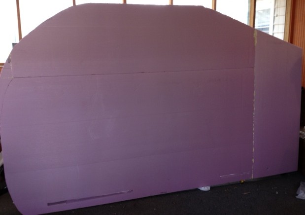

Postby Papi » Tue Feb 07, 2012 2:43 pm
Had a few minutes before work today, so I played with the fauxmie. This might be the final profile, subject to approval by She With The Opinion. :lol:
I plan to put the door right above the tire. I'm not so worried about aesthetics as function; the wheelhouses will give us a place to sit and take off our shoes. Note that the roof is almost flat. This is so I can possibly put in a skylight or opening sunroof, because both of us love to look at stars and meteor showers.

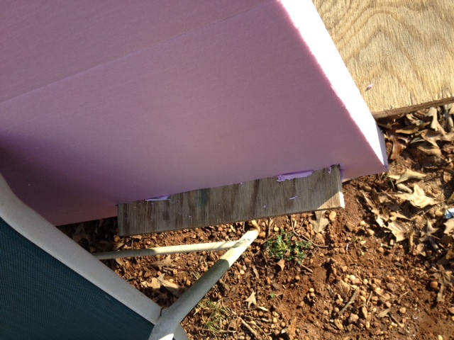

Slow and steady wins the race, and that sums up my build. Slow. Been busy with a million other things, but did carve out some time for the foam (pun intended). I honestly thought the doors would be the easiest thing, but it turns out they are hard! :shock:
Basically, I built a door frame out of poplar (because I had it) and glued that in place. My original idea of rounded doors turned out badly. No matter how many kerfs, how much steam, or even ammonia, the wood split before reaching the desired arch. So I angled them off and am happy. Good thing about foam; goof and you can glue it back!
