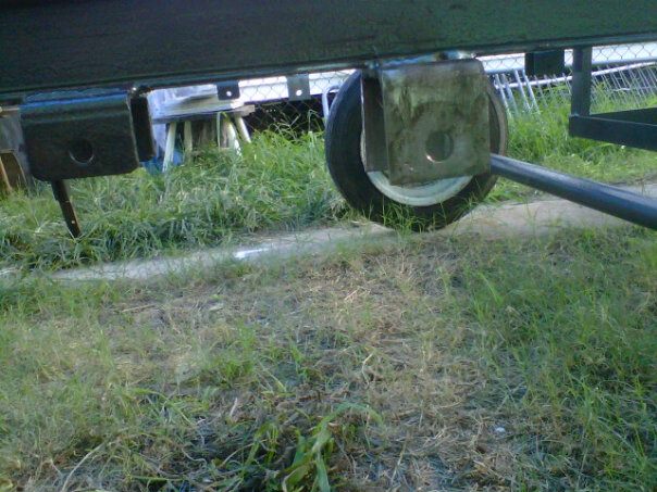

Ran into a bit of a delay this week. :( I was planning on painting the springs and re-installing the axle on Wednesday. When I got the springs all cleaned up to paint I discovered a crack in one of the leaves. Guess it's better to find it now instead in the middle of BFE, Texas.
Thursday morning I went by the spring place and found out they no longer make springs as long as the old ones. Spent a good share of the afternoon measuring and contemplating :thinking: . Finally decided to go with some springs 19" shorter then the old ones and ordered them from etrailer.
Got a new pair of rear axle hangers , so I'm going to have to grind some of my new paint off the trailer and weld the new hangers on, then repaint.

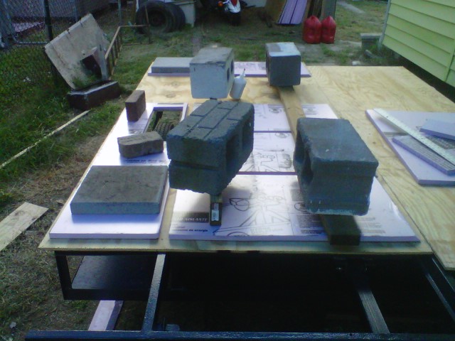

Monday- Came home from work and took a quick nap. Then went to the big orange box for some foam.

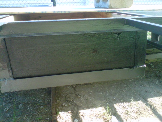

When that was unloaded, I staerted working on the dropped floor.

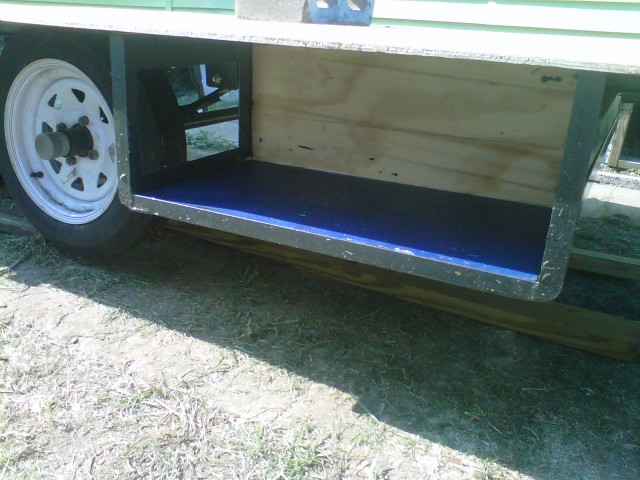

I had a piece of 3/4 oak ply left over from my kitchen remodel, (just big enough for the dropped section)already stained blue like my cabinets, so I guess I'll have a blue floor. Good thing I like blue :)
Black goo spread around.

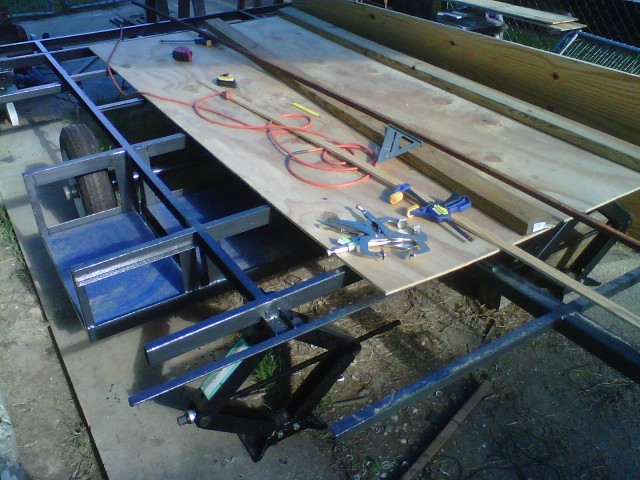

Tuesday- When I woke up I found the new springs had arrived from Etrailer.

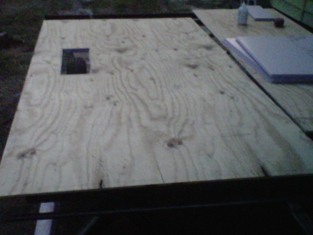

With the axle reinstalled we were able to push it down the driveway and turn it around. Then I started working on the regular floor.

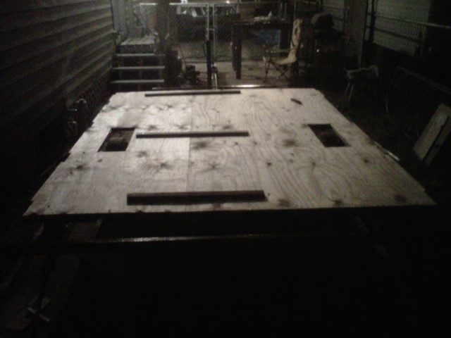

The work on the floor continued through the week
I'm trying something different on the floor. I stuck strips of canvas about 8"wide along the edges of the bottom side of the floor which will get stuck to the foam. Then I can coat the entire bottom of the floor with black goo and make sure everything is sealed. Oh yeah, I did use some SUPER FOAMIE THREAD WATERPROOFER on the bottom of the plywood too.

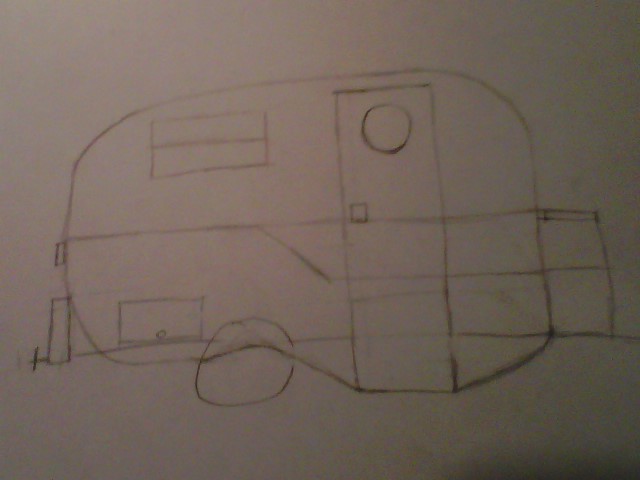

Here is a high quality 3d drawing of my plan (not to scale)

Really coming along now Rosey !!! :thumbsup: Glad you don’t have to rush ... Your design looks COOL, blue floor and all ... 8) 8) 8) :thumbsup:

Rosie, I really like that design. It has a classic look to it. If I recall you do your own welding. There's a skill I wish I had. I agree with you, treat it as a hobby and it's less frustrating. 8) 8) And BTW, I love the blue floor. I bleed UCLA blue... Go Bruins!!
