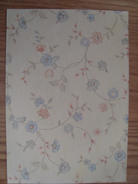

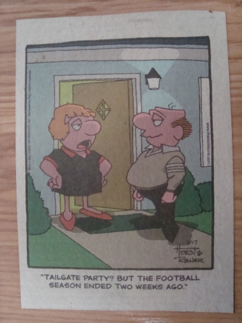

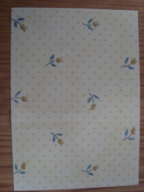

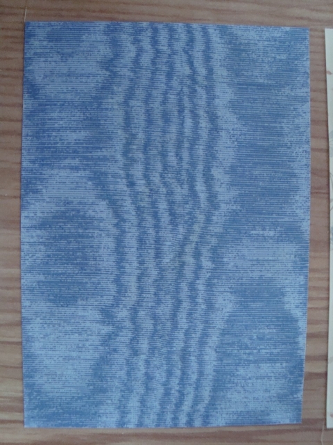

Well, I have the day off and it is cold and snowy, I already did my taxes so what to do...glue some wallpaper to a board. I had three different wallpaper scraps and one comic. Image
I had to tape some of them down because they curled so much.
Here are close ups of each to get the before look.
Here is a link to my wallpaper gallery if you want to see bigger images
gallery/album.php?album_id=2865
I didn't have any foam so I used an old piece of laminate flooring figuring it would not be porous like regular wood, just to be fair. Then I glued everything down with a 50/50 mix of Titebond II. Then put a coat over top of the samples.
You will notice that the one has some air bubbles. No matter how much I brushed it, I couldn't get them out. Guess testing a sample beforehand is very important so you aren"t cussin' and spittin' when you are done.

yes, bubbles will form, no matter how much you work it. some will come out not so bad, others ...well... you have found this out. now what i did find out with this stuff is that you can sand it down. it will look like the bubble is there, but it really won't be. i was working on a floor with the brown paper bag, and had bubbles. i go out the sander and went to work. nice a smooth to the touch, but still looks like a bump. if you decide to try the sanding, experiment with different papers, light sand ones, to harsher ones. :wine:

Well, it has been four hours. So far I like the newspaper the best. It didn't bubble at all and really seemed to soak up the glue (the wallpaper did not). It did take on a bit of a yellowish tint but it just made it look like old newspaper which I liked. The top two faired samples fared pretty well although do have a bit of yellow. The bottom left sample was the one that bubbled and it shows a lot of discoloration.
I think the Sunday comics might work. Worst case scenario would mean having to put canvas on it later. The upside is it would be cheap,look fun,and you could easily repair it just by slapping up another sheet of newspaper. I guess I should start saving the paper (or do a little dumpster diving for the comic section)
I am going to let them dry for a few days and then do a water test.
