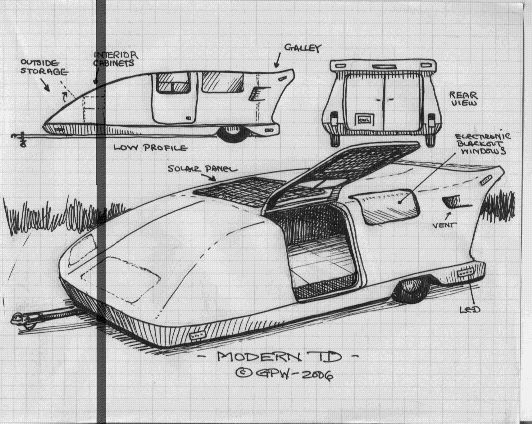

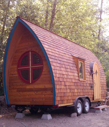

Ah here we go , I thought you had drawn out something like what I wanted to do to the door .
I like your style door here because it would keep the rain off of me when I opened the door . And I could sit under it with out getting wet . The design could be used in a tiny VSF . Of course I'm thinking of making the door about 54" wide and only 30" high .
I think my final design will be somewher between your spaceship TD and this vardo style trailer . Hopefully it doesn't look half baked when I'm done .

OK... I closed my eyes and thought about it and I'm not sure what a hybrid of these two designs will look like. They seem like polar opposites to my eye. My eye tends to lean towards GPW's designs. He and I share a liking for the wide and low look. Every once in a while I'll look at that design and think of the steps I would need to work through to build that. Sure a long way from from his Very SIMPLE Foamie. Both are very cool in their own way.

Wider doors sure are helpful !!! At my age, I like to be able to sit at the door edge , and sorta ‘ just roll right inside ... :lol: With the way you can build with foam , adding and subtracting , seems most anything (shape ) is possible !!! :thumbsup: You can see some of my earlier designs were more plywood based (till I learned the truth) but could be easily adapted to foam ...
The plans submitted above ^ was merely an attempt to produce as Simple a foamie trailer build as possible ... and not be just a “box” ...
Some observations .... for a simple camping trailer , the 4’ inside hight is Plenty of head room for most folks (allowing the use of full foam sheet sides) ... but the real key to Comfort is having the foamie wide enough !!! My little foamie is only 44” wide inside , and really not big enough for two ... 60” or more would have been Much better ... The idea of the Magic number of ~ 50 sq. ft. of floor space seems accurate ... for me anyway (@ 6’3” )

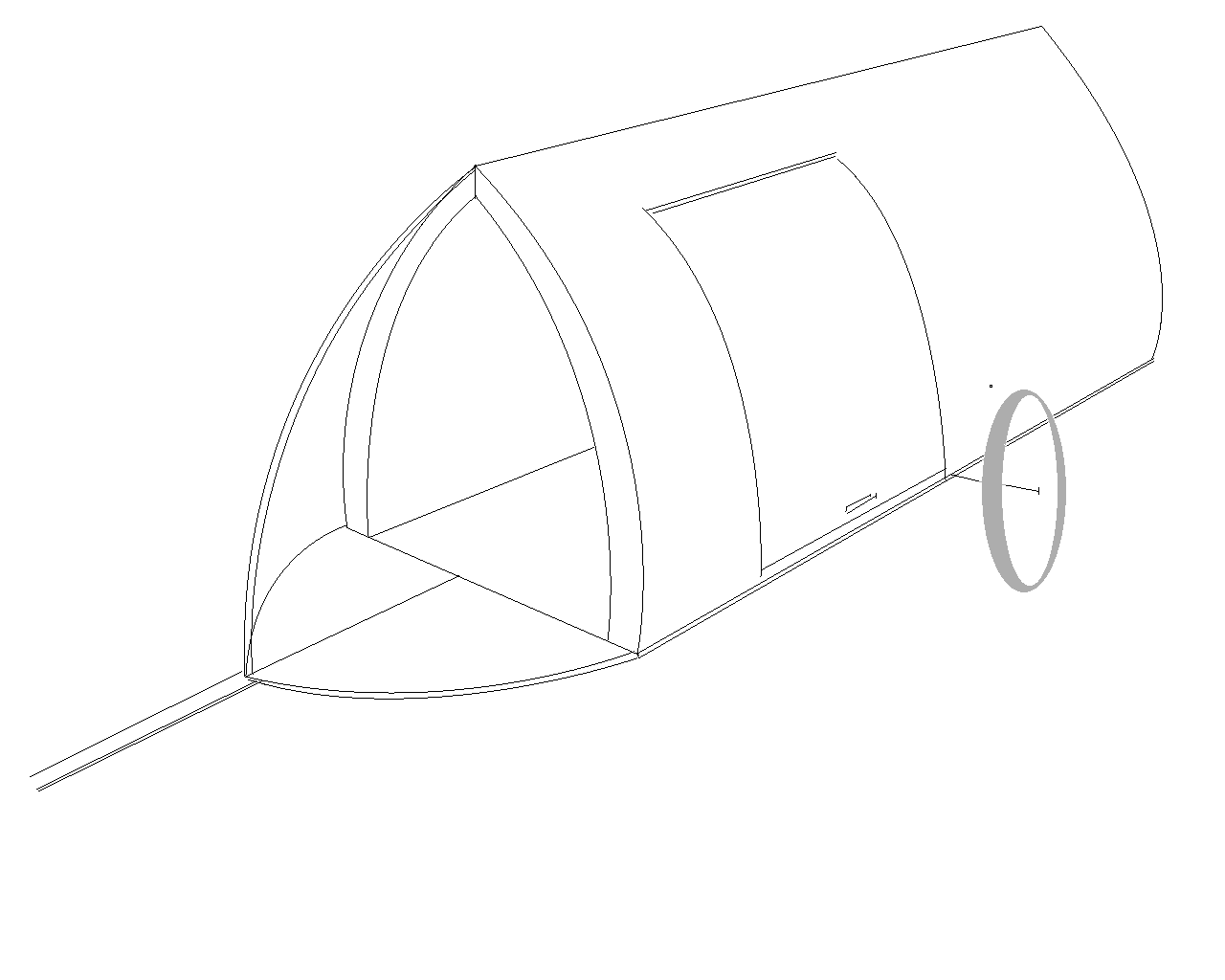

Razz, I see your idea now , and was thinking , you know a sheet of foam can be bent into any curve you want , by bringing the temperature to around 190F , bending it into the desired shape and fixing it to that shape (a form) till it cools , then it will retain that shape forever, stays bent 8) ... so that sorta’ bulgy A-frame would be entirely possible, quite Strong , and easy to fabricate once you have a temporary form built ... Cool idea !!! :thumbsup: 8) Could be built Very Light ... :thinking:
Re: Very SIMPLE Foamie’ ...
Postby GPW » Sat Mar 23, 2013 9:21 am
Something like this ? :thinking:
Postby razzer » Sat Mar 23, 2013 9:43 am
GPW , that is exactly what I am envisioning . :thumbsup: If I weren't so computer dumb I would have figured out Sketch by now so I could make the design to show everyone myself . Alas I'm learning to use a word processor to update my resume . All the companies want you to E-mail your resume and fill out applications on line . I was thinking of a short knee wall at the bottom to raise the arched roof up a bit but after I'm done you probably won't be able to tell anyway . I hope to experiment with the heat bending this weekend . Oops need to make a form first . :thinking: I'm not taking your thread off topic am I , let me know and I'll be more careful .
