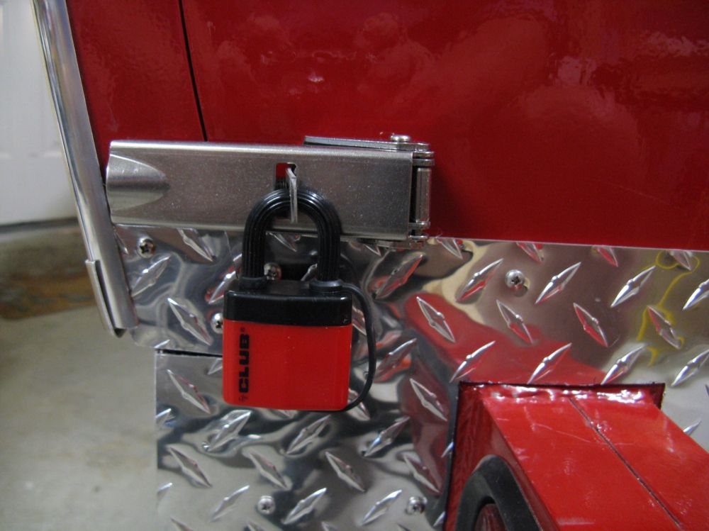

GPW wrote:What about a padlock and a hasp ?
That is what I used on my galley hatch :thumbsup:

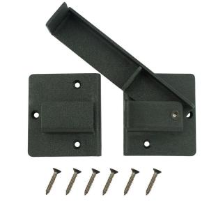

Though not a foamie, my Plywood only trailer was built with secure doors that may be applicable to all (unconventional appearing) trailers. Not pretty, but functional. The 3/4" thick plywood walls and doors (cutouts from the wall) are each secured with dual slide-action bolts and padlocks, with triple hinges.
108386 All the door locks and hinged are secured with a combination of carriage bolts/security bolts/locking nuts where none can be easily removed or pulled loose from the outside. When inside the trailer at night, all latches can be padlocked open, and I (or my wife) can use the inside drop-bar latches to secure the doors. 105191 The 3/4" oak dowel is a tight fit in the slots and cannot be loosened from the outside, and the force required to shear it is significant. If I were to do another build (of course, another unconventional one), I would probably use these latches on both sides of each door. I couldn't find any like these at the time, now's too late.

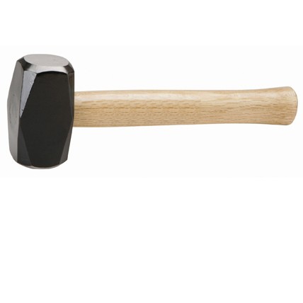

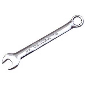

I hasten to add that , if my wife couldn't unbar the door, or someone managed to lock the doors from outside, then there's always the inside-cabin toolset:
combo wrench.jpg (5.63 KiB) Viewed 929 times
