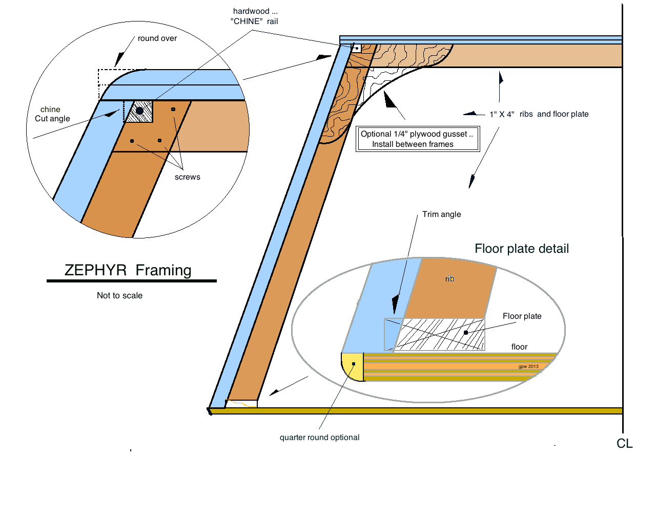

Postby atahoekid » Thu Oct 03, 2013 5:38 pm
For my likes (remember I have the propensity to overbuild), I think the gussets are an excellent idea. The quarter round at the bottom could be used to feature some "decorative" wood trim along the bottom edge (maybe add a ledger board for looks, well waterproofed and finished, though). Should look great against the canvas. 8) :thumbsup:

Postby GPW » Thu Oct 03, 2013 6:10 pm
OK, here’s the drawing , showing the gusset ... Remember , it has to be installed BETWEEN the framing members .... won’t work any other way ... unless you make filler blocks (that’s a PIA) :roll:

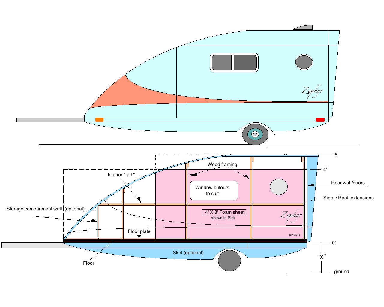

Postby GPW » Sun Oct 06, 2013 7:01 am
Just another drawing , again :roll: ... working out the details and possibilities ... :thinking: Still in the planning stage .... We’d most welcome anybody wanting to throw their $.02 in ... :thinking:
Ps. I’d really like to try those little FAT pop up tires on this ... 8) Shouldn’t be any heavier than a pop up .... maybe Lighter ...? :o

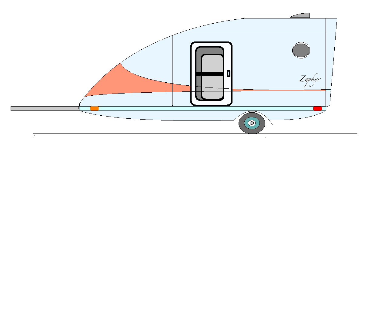

Postby GPW » Mon Oct 07, 2013 7:21 am
Zep with “commercial “ door ... kinda’ Nice really !!! 8)

Postby GPW » Tue Oct 08, 2013 9:12 am

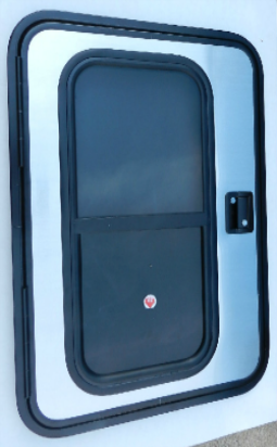

Gotta’ admit I like the side doors, KC ... it definitely would be one of those raid the “piggy" bank for items , just because they look Cool !!! ...Or, may be able to DIY ... or just have one (curbside) door($$$) and the two back doors (Foamie’)... The only reason for those is , you could actually use the trailer to HAUL materials around..more full size sheets of foam , plywood , lumber, etc. ..when needed ... Multitasking for the "new age"... It is a “trailer” eh !!! :thinking:

Postby R_W » Tue Oct 08, 2013 12:20 pm
Have you looked at truck toppers/caps/shells (whatever your local term is) on Craigslist? You can get a topper with 2 good sliding side windows w/screens and a 4' hurricane hinge in back (if you pick the right brand) for $50 if look.

Re: ZEPHYR...
Postby GPW » Wed Oct 09, 2013 5:23 pm
Tom , it will be close -ish’ anyway ... sorta’ ... :lol: Figuring the slanted sides and rounded edges will help ... wish I could draw better , maybe do a completed drawing of what it would look like finished ...
