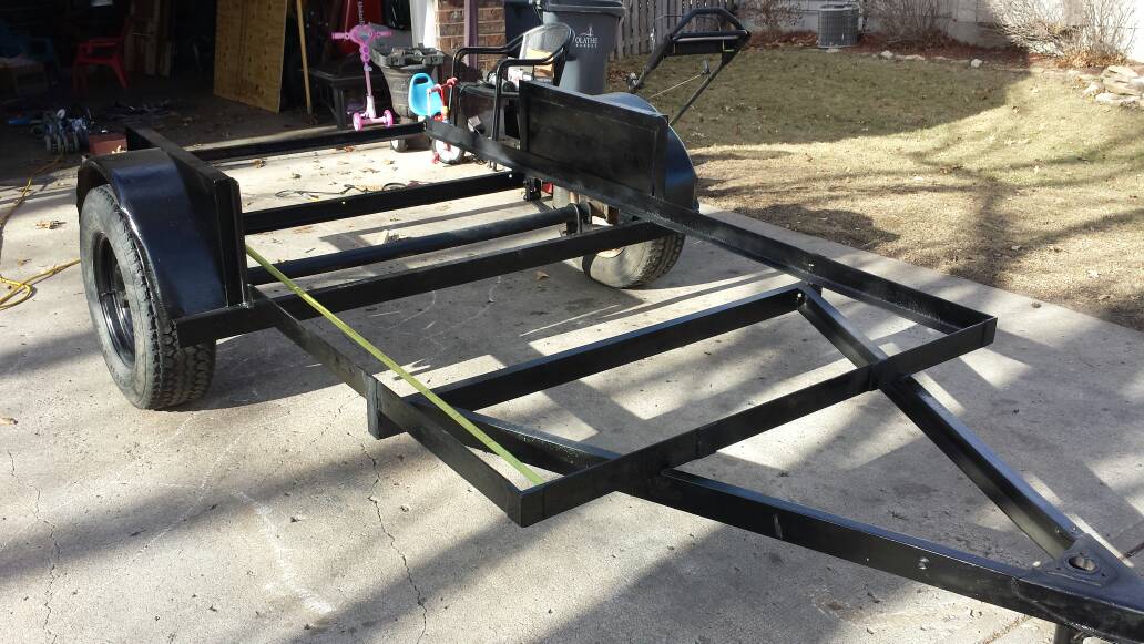

Postby be_a_jayhawk » Sun Jan 26, 2014 2:07 pm
Harbor Freight grinder burnt up on the 3rd cut.....sigh

Re: Planning my foamie
Postby KCStudly » Sun Jan 26, 2014 3:20 pm
Are you pushing them too hard? You need to let the rpm stay up. If you bog them they will burn up due to high electrical draw.
Postby be_a_jayhawk » Sun Jan 26, 2014 3:52 pm
I used the 20% off coupon I printed (again) and upgraded to rhw next model for 2 bucks. The better model and figuring out what I was doing did the trick. I cut grinded and now touched up with primer! Time to finalize my flooring ideas!
Postby GPW » Sun Jan 26, 2014 5:43 pm
Nice looking trailer now !!!! Ready to build ... :thumbsup:
