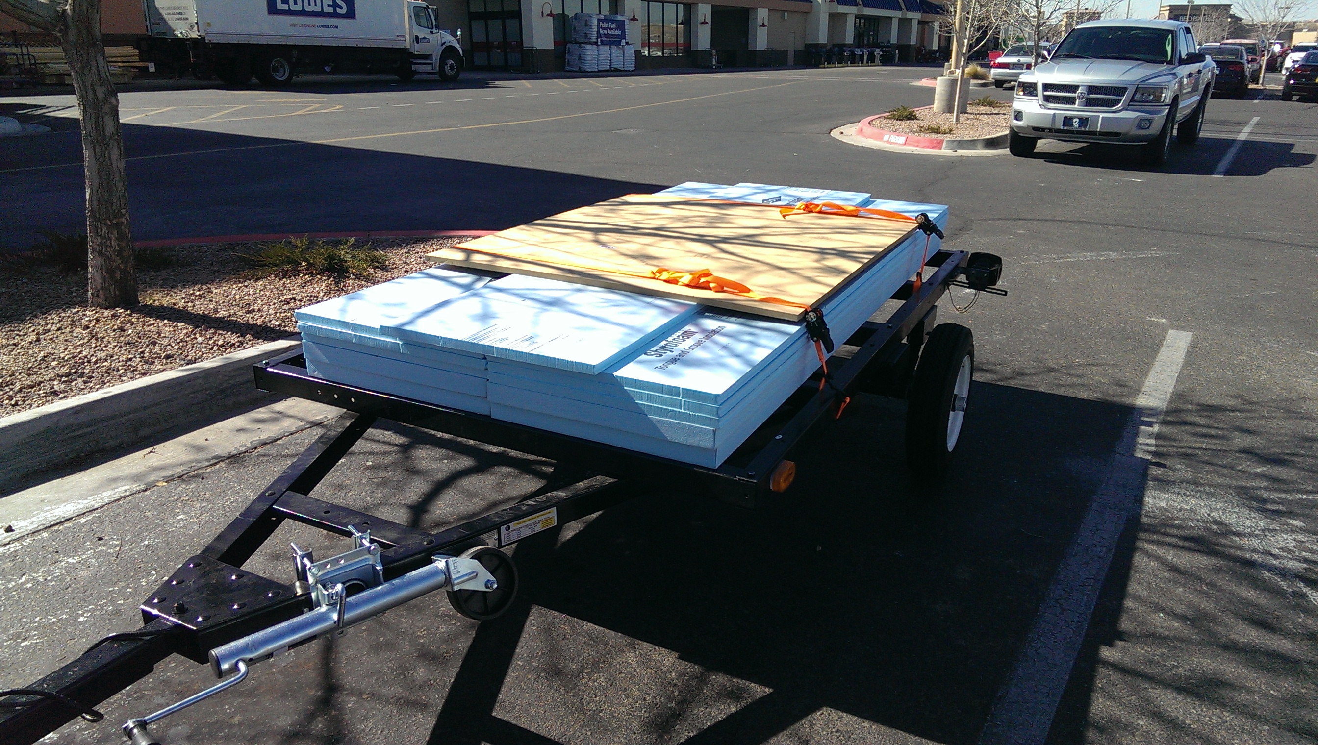

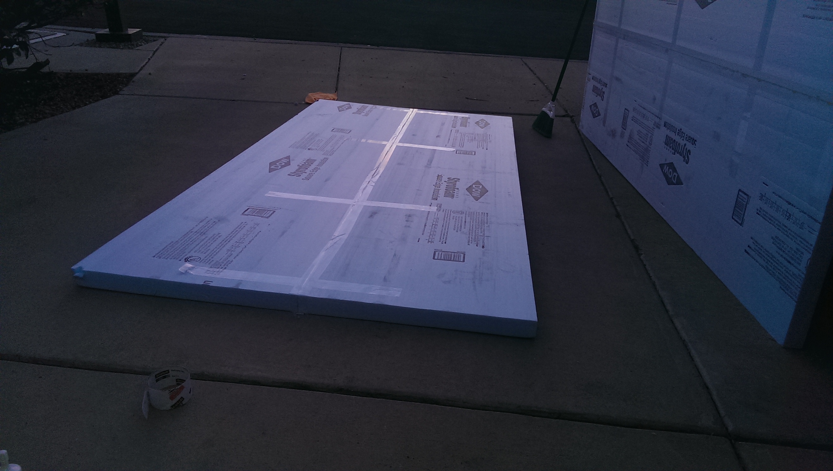

Big blue only had 2 foot foam panels, but I did not want to go to the orange store, so I had to glue them edge to edge. I started by taping one side,
then I flipped it over, and exposed the seam.

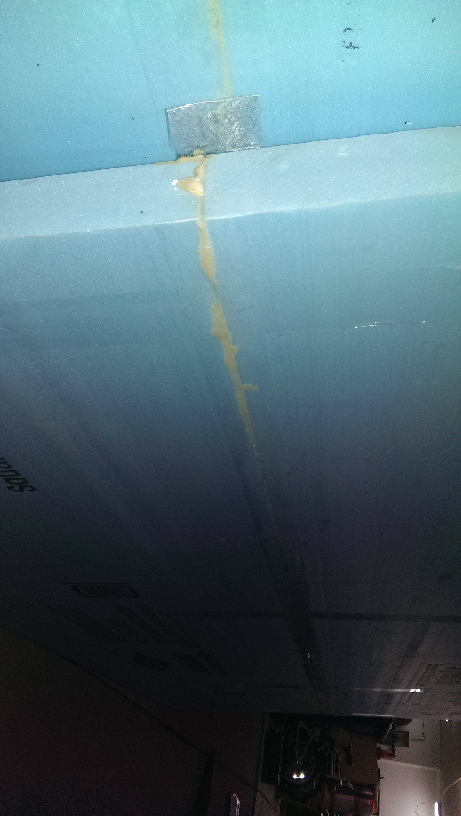

After I glued a spritzed the seam, I laid it flat and taped the other side like the first side. With time to wait, I finally glued and screwed the bunk on top of the storage area. I got creative with weights, as I only used a few screws (mostly for clamping purposes).
I went to check on the glued foam panels, and the GG is filling the seam nicely without too much uncontrolled expansion. I forgot who recommended the packing tape, but thank you, whoever it was!

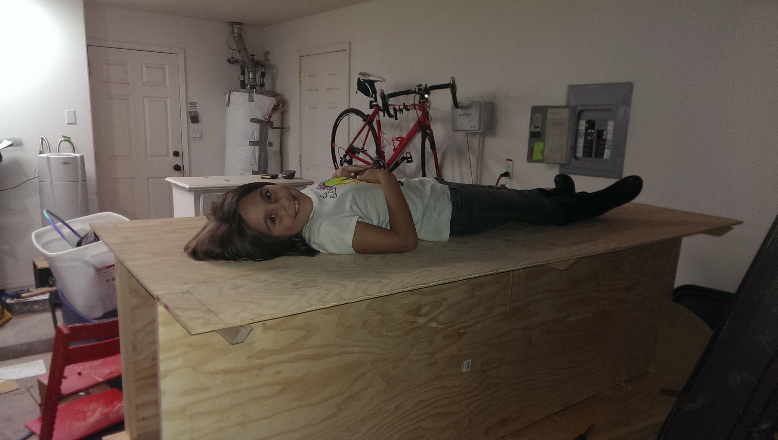

Finally, it was dinner time, and time to see if the bunk will fit the munchkin!
I'm pretty happy with the day's work. I did get a 3rd and 4th coat of water proofer in the storage area before I attached the bunk. I would have liked to get a coat on the bottom of the floor, but c'est la vie!

One thing I found is that the GG is highly susceptible to climate. After spreading the GG evenly on one side, in humid weather it was enough to just wipe the other side with a damp cloth. My spritz bottle shoots a rather course spattering, rather than a fine mist, so that may have had something to do with my results, but I found that when I sprayed I would usually get a lot of expansion and cleanup work after the fact.

KC , in our infamous Humidity , we don’t use a water spray or anything , unless we actually want it to expand .. Handy sometimes with “less than perfect” building ... :oops: That and we’ve learned to keep an eye on the drying GG and scrape away early, any excess that seeps out .... much easier while it’s still soft ... less hassle later , just time consuming , needing almost constant attention till “set” ... and that depends on the weather pretty much (climate ^ like KC said ) ... The warmer , more humid it is , the faster it fires off... Takes a while to get used to ... The biggest problem is using Too Much ... you only really need a THIN uniform film , anything else is just a waste and eventually a mess, if left unattended... Less is More ... ;)
Ps. Got a 24” monitor here, pics fit , but just barely ... :o Scuba, just re-size in your Photo software .. You’ll get the hang of it !! Easy ... :thumbsup:

Scuba, your munchkin fits the bunk well & with room to grow. You're making good progress.
KCStudly wrote:After spreading the GG evenly on one side, in humid weather it was enough to just wipe the other side with a damp cloth. My spritz bottle shoots a rather course spattering, rather than a fine mist, so that may have had something to do with my results, but I found that when I sprayed I would usually get a lot of expansion and cleanup work after the fact.
Great to know. That would probably work well here.

KC, I live in Albuquerque, so no humidity to speak of. I pulled some of the tape today, and I will have very little to clean up!

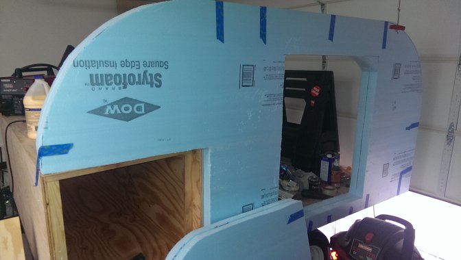

I also got my daughter to help me cut out the side wall and doors.
I cut them halfway through with a razor knife, then completed it with a sharp steak knife! Low-tech but effective! Then I used a rasp-plane to square and straighten all edges in pairs. The walls are ready to be put on, but I have yet to waterproof the bottom, and I want to before this camper gets too unwieldy.

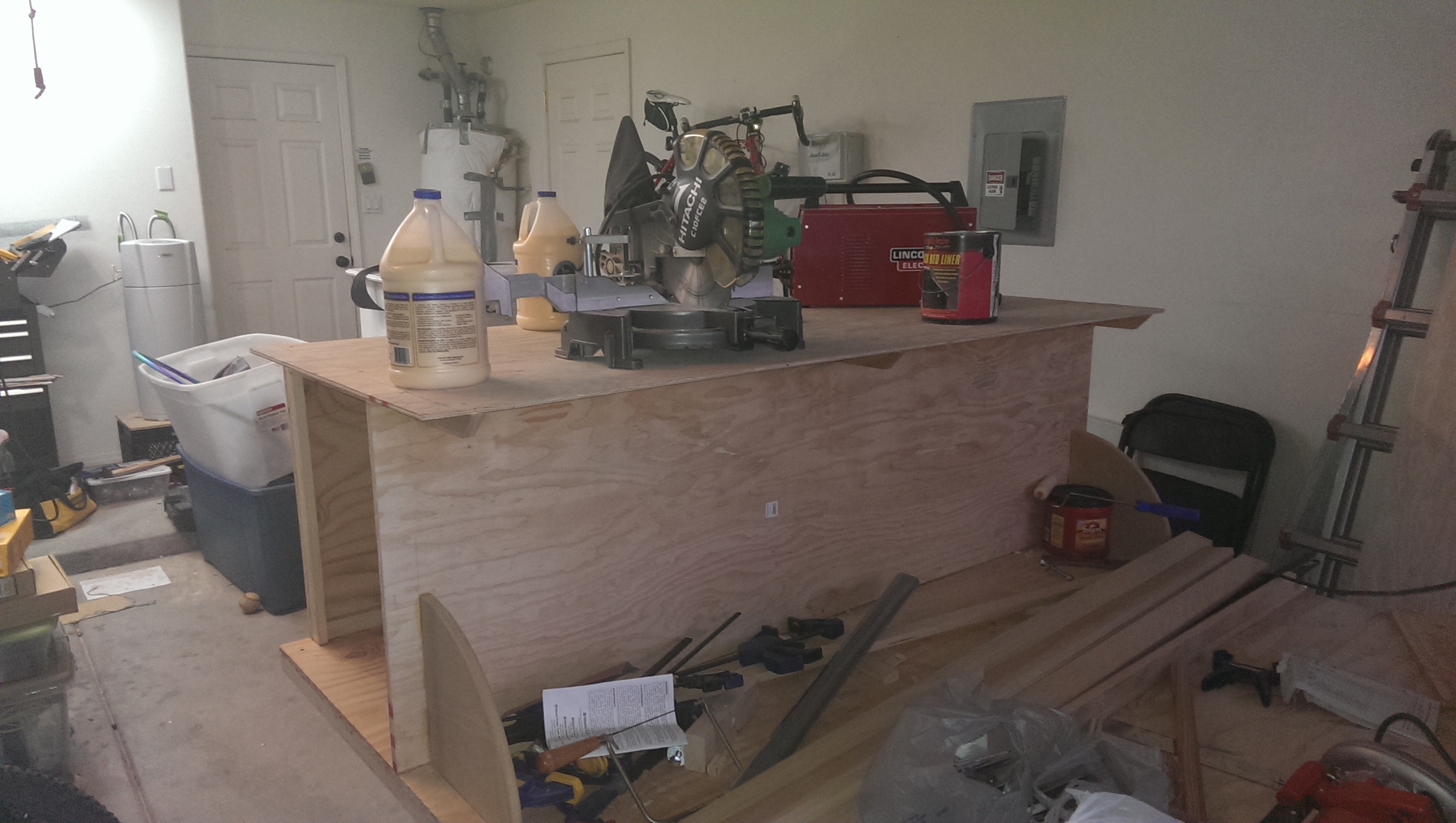

Well, not much to update. I have been super busy with other, less fun, things. I did receive my dome lights and canvas, and I flipped the floor over and waterproofed the underside. My gallon of truck-bed liner went bad, so I may go get some more, or I might just leave the bottom sealed with the poly mix. I am taking next week off of work (and the.wife and kid are busy), so I should be able to get a whole lot done. I only lack door hinges, a battery, and a 12v outlet, and paint. Hopefully, I reach the point next week where I need to go get 'em.
