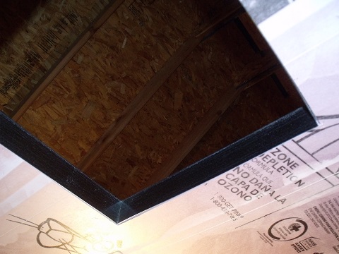

So now I have a nice square to fit into the vent hole on the roof. This will hold everything nice and square and give a edge to screw or pop rivet the roof vent to once installed.
Vent square
DSCF3354 s.jpg (102.55 KiB) Viewed 3507 times
One thing that is very important in installing the flashing is that you want to make sure you have no spots in you cutout/surface that is not true. You want the flashing to fit but not be pushed by it's surroundings. If it does not fit relaxed it will buckle or lift due to some stress from a tight spot in the cutout.

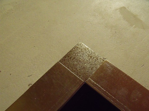

Install and check for a nice clean fit.
Fitted
DSCF3362 s.jpg (90.07 KiB) Viewed 3507 times

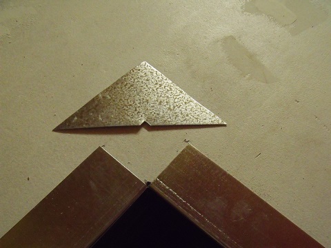

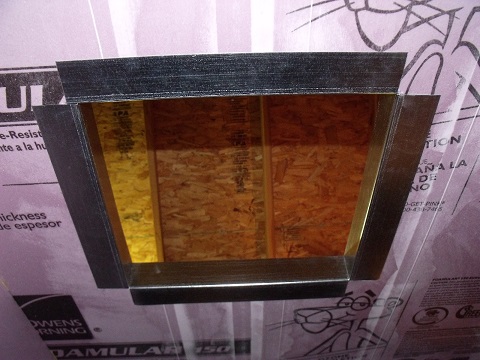

If you want a more finished look on the corners you can make a simple cutout to fit nicely under the flashing.
Corner cutout
DSCF3369 s.jpg (85.67 KiB) Viewed 3506 times
By putting it under the flashing you will make it stronger if you have to screw something into it at that location. If not I suppose you could just make a cutout that just fits in the open space. You could do a radius too. 8)
Corner cutout installed
DSCF3370 s.jpg (85.86 KiB) Viewed 3506 times

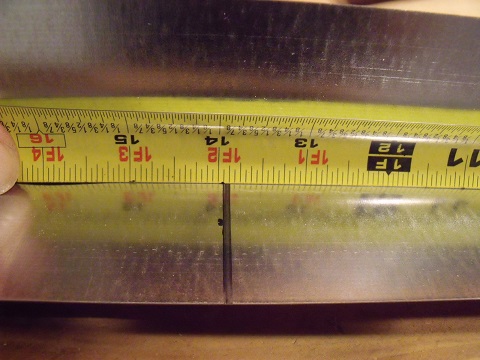

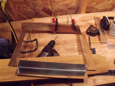

So now that I got the top square done it is time to do the inside square. I will be doing the inside square a bit different because I do not have the tools that are exact enough to make a perfect square 1/16" smaller than the top square. If the top or bottom were not perfect in fitment size it would cause the flashing to distort once I attached them together. So to overcome this I will make two angles.
To start I will mark a cut line at 13 7/8" to allow for clearance to fit inside the top square.
Cut 13 7/8"
DSCF3363 s.jpg (92.76 KiB) Viewed 3505 times
Make the bend as before and check for fitment. This one turned out perfect and stays in place without assistance.
One angle fitted
DSCF3364 s.jpg (97.75 KiB) Viewed 3505 times
Make another angle and fit for size. If any one of the angles is too long to fit you can sand down that side till you have proper clearance. By using two angles you can get the corners to fit right and if your a little short on one side or the other it will still fit nicely. It does not matter if you are a little short ether.
Both angles fitted
DSCF3367 s.jpg (99.36 KiB) Viewed 3505 times

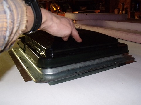

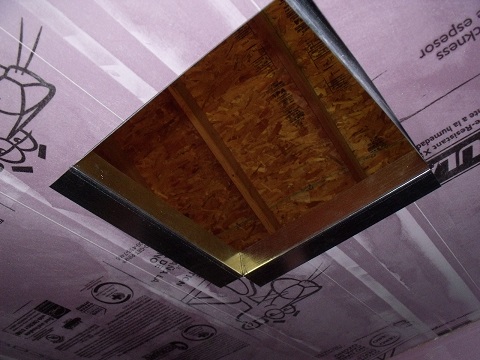

So I have not done it yet, but the idea is once I am ready to make these squares permanent I will clamp the top to the bottom and pop rivet them together. The angles, once pop riveted together, will create a channel that will give the foam extra support in the cut out area as well as a hard spot for screwing the vent and garnish in place.
Vent test fit
DSCF3371 s.jpg (93.2 KiB) Viewed 3502 times

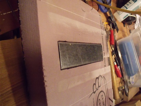

Now onto a simple hard point.
So you have a place that you need a hard point for attaching something in foam. Well you could use wood, or you could use this simple method.
You will need a soldering gun for this procedure. I have a actual gun, but I believe a soldering tool would work if it had a long enough point.
I will be using a scrap piece of foam and flashing for this example.
First make a piece of flashing the size you need it. In this case I used a piece of scrap about 6" long. Now place the flashing where you need it upside down with the angle away from the cutting edge.
Hard point
DSCF3376 s.jpg (90.18 KiB) Viewed 3501 times

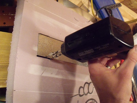

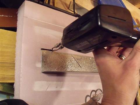

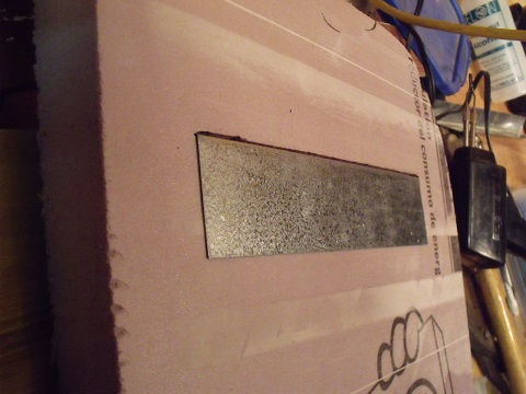

Next, take the soldering gun and get the tip hot. Use the flashing as a straight line guide for your soldering gun tip and make a straight slot. Make sure you go down deep enough for the angle to fit.
Cutting a slot
DSCF3377 s.jpg (86.95 KiB) Viewed 3501 times

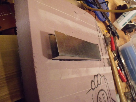

Now flip the angle over and install into the slot you just made to make sure it fits. Now all you need to do is glue it into place with GG, GS or Gripper. I think I would use GS in the slot and Gripper between the wall and the angle so I would not get any lifting form the GS. This should hold most light items or hinges.
DSCF3379 s.jpg (83.61 KiB) Viewed 3501 times

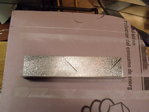

But wait! You say you need something more sturdy?
Ok, Take your soldering gun and now use the existing hard point as a guide for another slot opposite form the slot you just made.
Cutting another channel
DSCF3380 s.jpg (83.14 KiB) Viewed 3535 times
Now place another hard point over the existing hard point.
Another hard point
DSCF3381 s.jpg (88.94 KiB) Viewed 3535 times
Twice the strength now and thicker for more screw holding power.
DSCF3382 s.jpg (86.53 KiB) Viewed 3535 times
