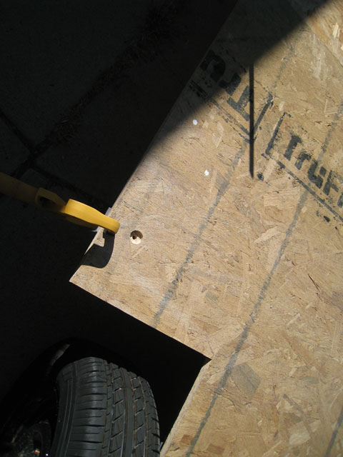

I started to use OSB for the trailer flooring. But the more I worked with it, the less I liked it. It is dimensionally stable and inexpensive but that's about all it has going for it. I use standard bolts and recess the head. You can see a bolt hole in the picture. On the plus side- I waterproofed the OSB using a mixture of polyurethane and mineral spirits and nothing else. When I set them aside, I accidentally put one in the path of our lawn sprinklers and it got watered twice a week for months with the bottom exposed to a pool of water. The waterproofing worked. No evidence of swelling or water infiltration.

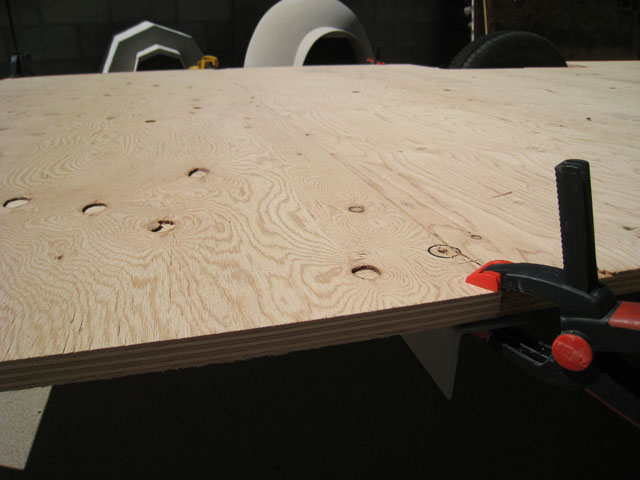

In the end, I purchased 3/4 inch 7 ply Douglas fur plywood and used it for the flooring instead. It was 3 times the price of OSB but it is lighter, stiffer and, if it somehow gets wet, less likely to cause problems. I put the 'A' side down and waterproofed it with a mix of mineral spirits and polyurethane until it wouldn't take any more, then I painted it with a high quality exterior paint. If that doesn't hold up as well as the black tar, I'll eat my shorts.

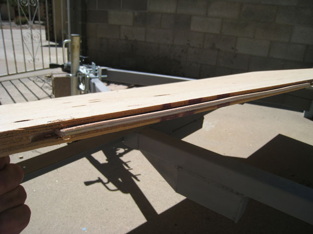

To help hold the flooring together, I created a groove and used a piece of plywood for the tongue. I glued the whole thing together with a liberal amount of tightbond 2. There is a cross member under the first seam that helps support it. The back seam is right at the edge of the bed so that is why the short piece of angle running between two cross beams exists. It is there to support the second seam in the plywood sheets.

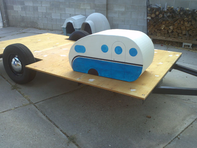

Then I filled all the knots with putty. Here is a shot of it with the trailer painted. I used Rustoleum high performance enamel thinned and rolled on in about 7 coats.

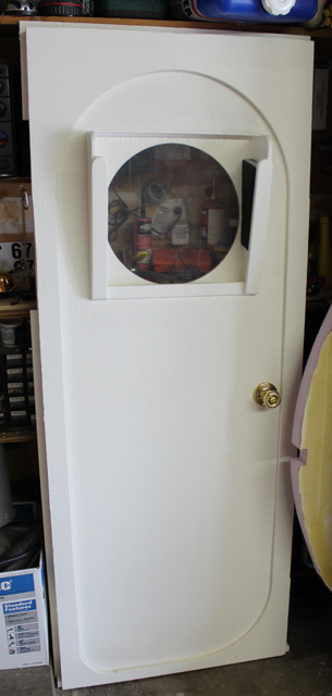

This turned out to be more of an issue than I expected. Had I researched more thoroughly, I would have discovered that 1.75 inches is the normal maximum thickness of a household entry door. In my initial search I was led to believe that extension kits for thick doors are more common than they actually are. All the hole jigs that exist to help you are built for 1.75" or thinner door too. I finally found what I was looking for at a locksmith's shop. If I build another door, I'll make sure it is 1.75" or thinner and not the 2" that I built this door. Really I just picked 2" because it matched the wall thickness and I thought the extension kit was more common.

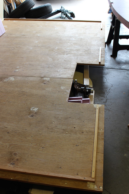

I saw this in someone else's build. They glued guide boards to the floor to press the walls against. It gives a bit more glue surface, and since the inside of my walls are already canvased, it should help to hold the wall to the floor even better. As you can see I have taken the wheels off the trailer and it is sitting on rolling casters. I've measured at least 5 times to make sure I can get it back out the garage. Let's hope I didn't make a mistake :shock:

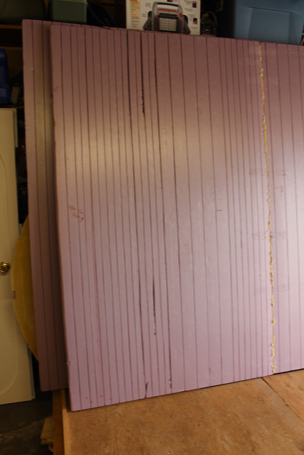

I used a circular saw set to about 70% depth of the foam and I used math to estimate the number and spacing of the kerfs. There is a great post of how to do this on the board but basically you figure out the difference in circumference between the inside and outside of the piece you want to bend and then you cut enough kerfs to shorten the inside of the piece to match the outside. I let Sketch-up figure out this difference for me. Then assuming my saw blade took out 1/8" with each cut I could figure out how many cuts to make and how far apart to space them. I over estimated a bit. If the calculations said I needed 8 kerfs I would cut 10 just to be safe. Then I actually test fit the piece and had to adjust by cutting a few additional kerfs in areas where it felt like there was too much stress.
I did learn an important tip when kerfing with a circular saw. Pulsing the saw (pulling the trigger and then let the blade coast) it gives a cleaner cut. If you look closely at the kerfs you can see a few where the saw blade got hot enough that it melted the kerf and made it wider. That was before I figured out that pulsing the saw avoids that.

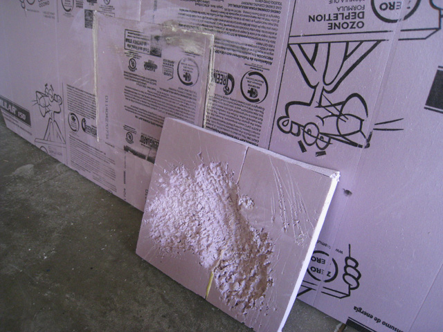

One advantage of the foam is the ease of repair. In this picture you can see a section of my wall that was "customized" by our new puppy, as well as, the repair. The jig saw, a bit of sanding and Gorilla glue is all it took to repair it.
