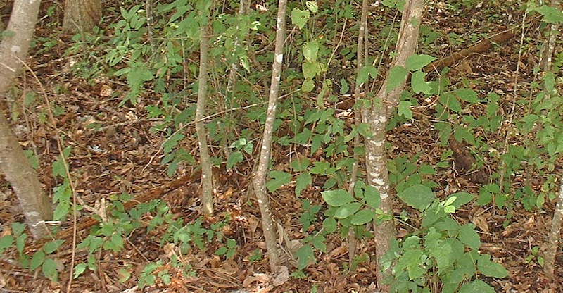

Cedar might be lighter ... and if you use the eastern Red Cedar it’ll smell nice too ... just to say , 10 years ago Katrina knocked down my only ERC tree on the property (that I know of) i cut the bottom off and brought it to NOGC to season to make English longbows , the rest we just left on the ground .... It’s still there today , in good shape too . all the while Giant Water Oaks have been reduces to rubble by termites and rot ...
Pic ... the ERC is the diagonal brown stick going from lower left to upper right ... I may just dig it out and make a walking stick ... and that’s with No Mix ... :o

Postby GPW » Mon Jun 29, 2015 11:23 am
You also see it’s surrounded by poisonous vines .... just getting over some of that ... :duh:
