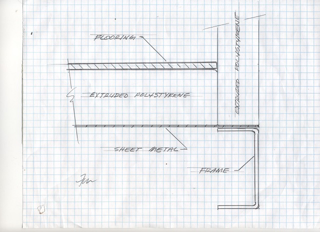

Postby alaska teardrop » Wed Jan 06, 2016 9:05 pm
GPW wrote:Good points for both Plywood and boards , or even foam ... Guess it’s up to the builder to choose ... :thinking:
FYI, I’m only trying to promote different ideas here , so don’t get mad at me if you don’t agree... Simply post your views for consideration too ... ;) :thumbsup:
Simple construction.
Lightweight.
Protected underside.
No wood rot.
Insulated floor.
:designing: Ideas, Fred

Postby alaska teardrop » Thu Jan 14, 2016 11:35 am
Lightweight.
No wood rot.
Insulated floor.
Not foamies, but two examples of the sketch above.
.063" aluminum riveted to frame, 2" extruded polystyrene, lay flat/no glue vinyl flooring.
.050" aluminum riveted to frame, 1-1/2" extruded polystyrene, 1/4" oak plywood flooring.
Fred

Postby GPW » Thu Jan 14, 2016 4:16 pm
FRED, Nice Job !!! :thumbsup: 8) :applause:
