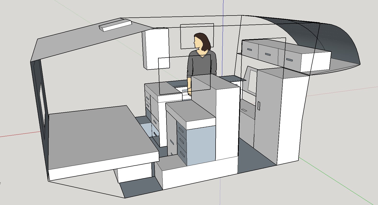

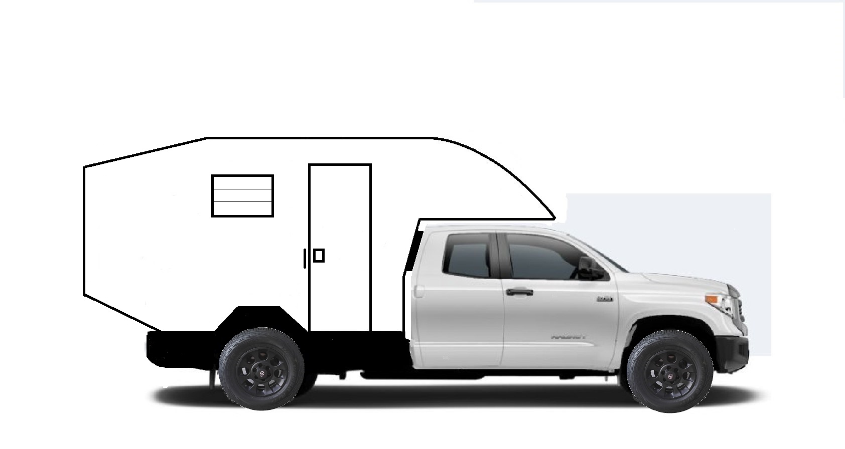

Anyway I might as well give you a visual of what I'm thinking, with my crappy Paint and Sketchup files. The bottom of the camper bolts directly to the frame. I *am* going to use familiar materials for that! 1/4" plywood sandwich, foam and stringers, fiberglass on both sides.

Your design looks as though you are into Overlanding/Expedition style travel. :thumbsup:

ghcoe wrote:Your design looks as though you are into Overlanding/Expedition style travel.
And that needs weight reduction and strength increase which a sandwich with total adhesion would give you. The glue and adhered wall and shell do that in spades. Use cedar and it's even lighter.

ghcoe wrote:Your design looks as though you are into Overlanding/Expedition style travel. :thumbsup:
I like going places where I won't see another human. I lived this way for 13 years in campers I built on a '84 Toyota. That ended in 2003 though. A woman civilized me and made me live in a house and work for a living. :NC We're still together and now she wants to vagabond again! :applause:
My biggest concern with PMF is puncture and dent resistance. I know I'm going to be hitting tree branches. PMF does seem to be quite stiff and light but it's such a thin layer. Particularly with this light foam, you need an outer skin that will spread the load out. Which is why I went with fiberglass-plywood-foam. Stiffest and hardest layer, then a thicker and less stiff layer, then the foam. But maybe a thicker PMF layer with a harder shell (Styrospray? Monstaliner? epoxy?) would be just as good, and I could get rid of the outer wood layer?

Every build technique is going to be a compromise. It just depends on what you want to compromise. :? They don't build tanks like airplanes, and they don't build airplanes like tanks. :lol: If you are snapping off branches and making sharp poky things then you are going to need the extra skin strength. If you are just pushing branches then the lighter skins will probably be fine. I find the canvas (10oz) over foam to be a lot stronger than I anticipated. Would it stand up to a sharp poky thing? Probably not. Would it hold up to pushing light branches? I think so.
I also just was reading up where some people are using plastic and metal screen as skin covering. I use flashing and dry wall beading to harden up the outside corners for just such issues. You could use aluminum diamond plate to harden frontal areas and leave sides and roof and back lighter.
